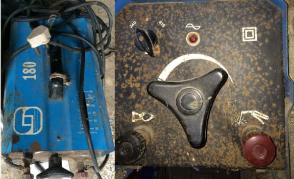

Hi folks. I've just joined the forum and my first question is identifying the welder I have. I got it off Freegle so there is no manual and, bizarrely, no obvious marks, model number, serial number, nothing.
I was given the mask (broken in one corner - odd size of glass lenses) and some electrodes in a box. I don't know if the electrodes can be used as I don't know where exactly they were stored. They may have to be disposed of as baking them at temperature is not within my reach.
I have already undertaken a beginners welding course at a local FE college and I have training in gas, arc and MIG welders. Training but not much practice, hence I'm hoping to use this for improving my technique. I have gauntlets, overalls and steel toe cap boots from my course. I have found a welding mask I like and will order that when I am happy that the welder is safe to use.
I have uploaded a picture of the top and front of the welder.
The control knob at the front moves an alu bracket along the scale which has electrode dia marked on one side and current on the other side. All quite self-explanatory.
I have already had it apart for a thorough clean. It had become the home for many a spider, web, dust, rust and bits of straw. All connections are free from tarnish to give good electrical connections.
I have begun to reassemble it prior to testing. And here I am stuck.
I am concerned that there is no isolator on the welder. Would it be prudent to buy a DP switch and fit it? There's a good spot on the front plate where I could cut a hole for a switch - where the DI symbol is located.
I have qualifications in Elec and Comms Eng and Portable Appliance Testing. I'd like to know what the rating for a switch should be and if I should go for an illuminated one. If the rod was to 'stick', I'd have to switch off at the mains or open the jaws of the electrode holder to break the circuit.
I'd also like to know about the possibility of adding a fan to assist with cooling. This is a long-finger project.
The original plug was a big old '15A' style (BS546) round 3-pin, unfused. I've replaced this with a 13A fused, heavy duty (BS1363) 3-pin plug - a bit like the old 'rubber' plugs they used to sell for power tools. It's not the usual urea-formaldehyde hard white plastic, more of a black ABS material.
I'm hoping to use the welder in the garage. Should I consider running 10mm^2 T&E from the consumer unit to the garage and add a secondary MCB unit for garage use? Currently it's 6mm^2 and it's only used for lighting and 3 power sockets (2 for the boiler and pump, 1 for the mower et al.). The garage does not have a ring circuit, it's essentially a spur. I'll maybe ask our spark to look into that.
