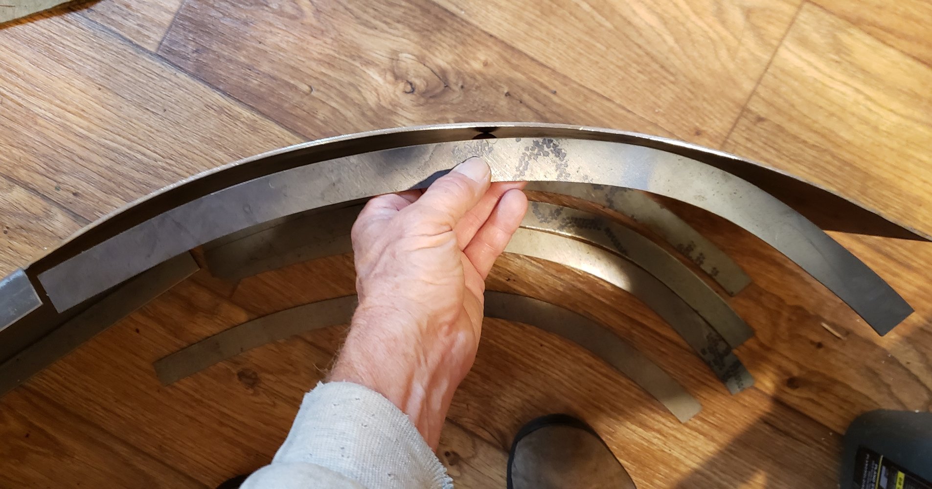

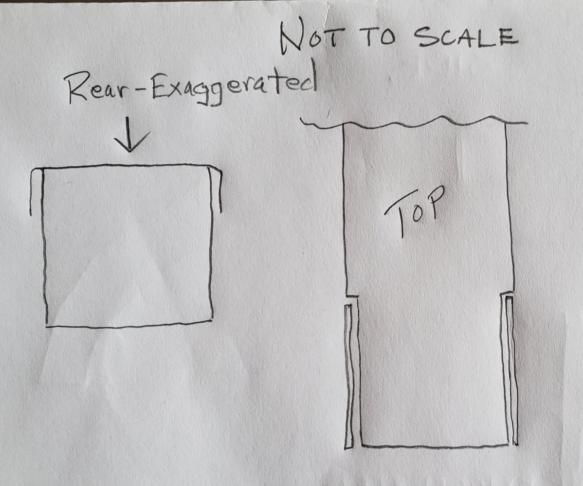

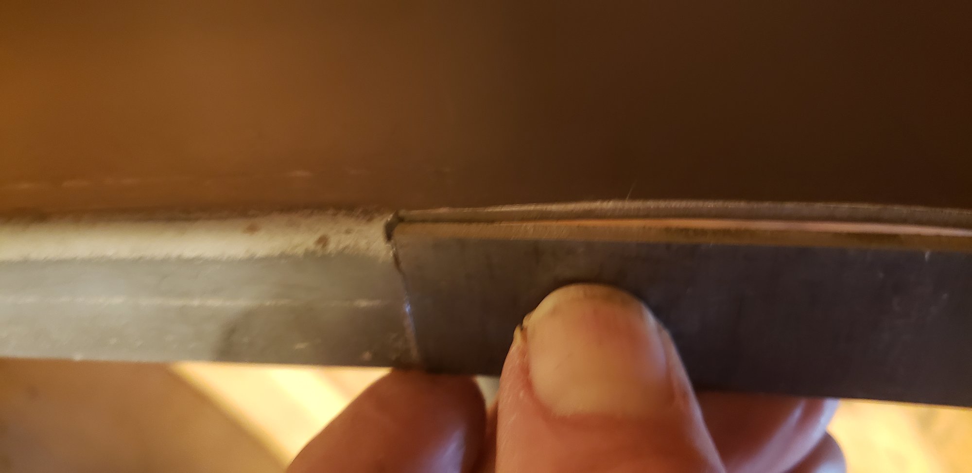

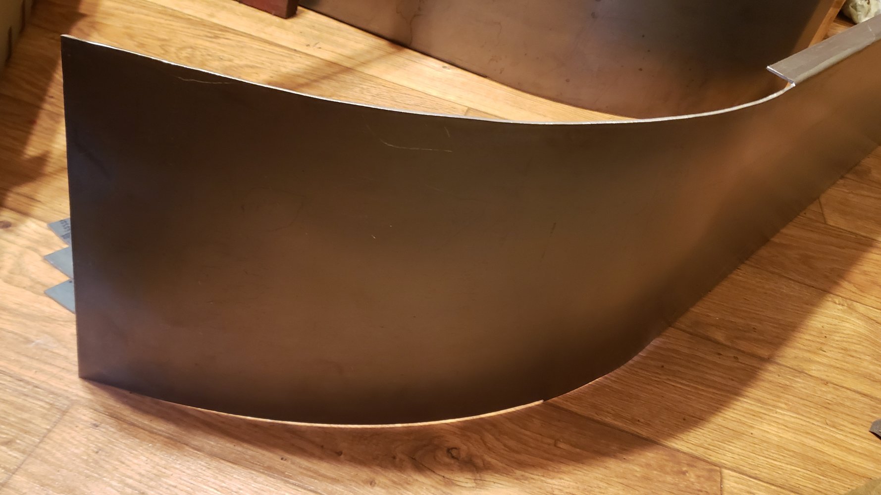

Sheet metal is .105" and was bent on edges and rolled at the back end where they couldnt roll/radius it due to the side folds.
I had pcs waterjet cut that will become the curved folded edges.
I'm building a wood and steel form to lay the main piece over and then screw the edges down onto it, holding it in the correct curve and then welding the add-on edge pieces on.
Im using a MIG with mild steel .030 wire and tacking it every 2 inches or so to start to avoid warping.

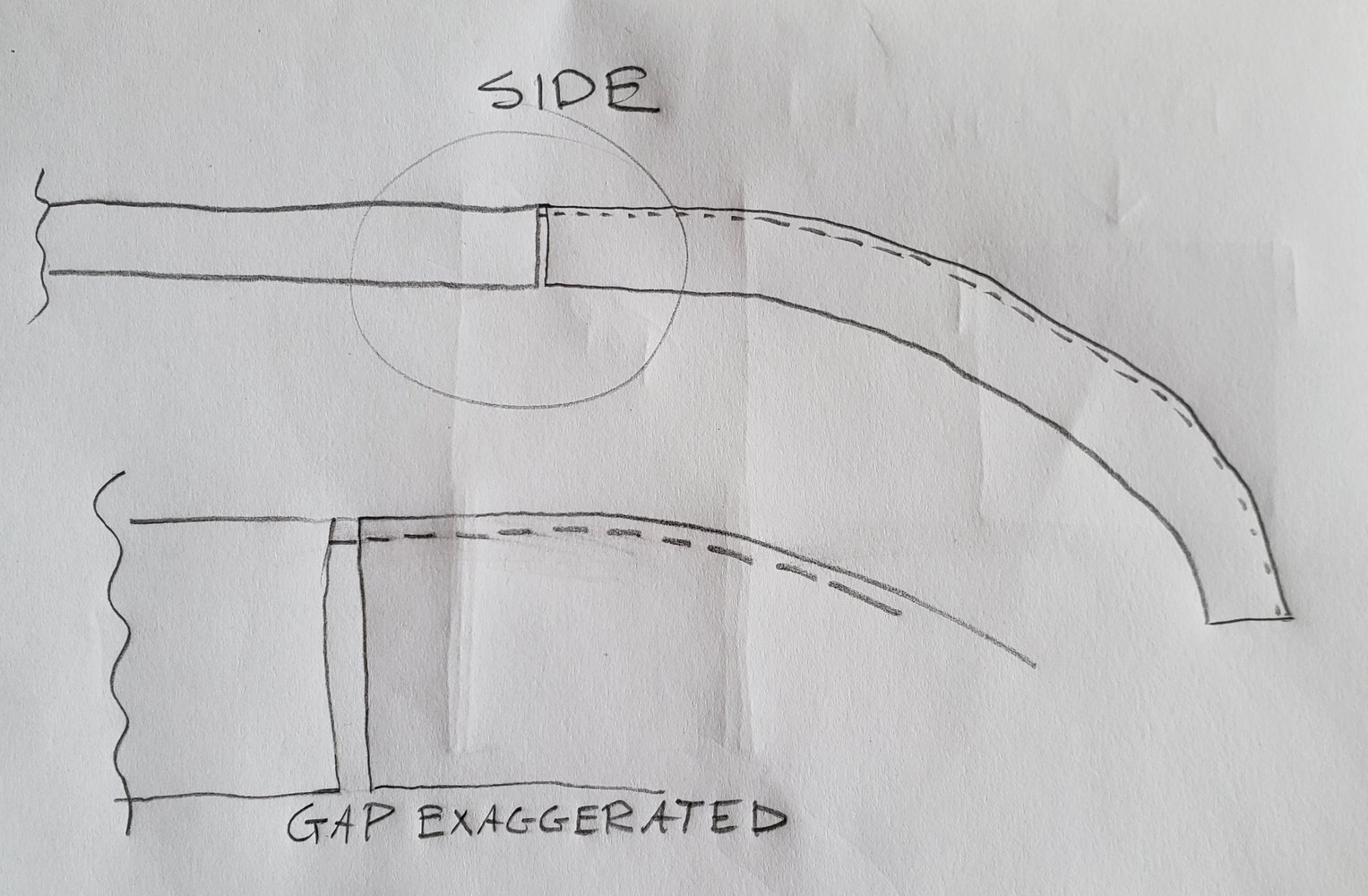

So, as I've never done this before.....how do I minimize and warping or puckering at the joint? I will be going on the backside and tacking the inside 90 degee joint too after the outside is fully welded and all gaps are filled.
Will the forced curve want to rebound and crack the welded joint (see side view "gap exaggerated" pic) on the side?
I'm probably overthinking theis whole proceedure but want it right the first time.
Thanks
