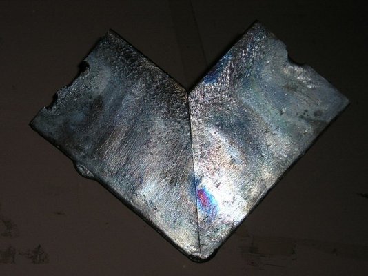

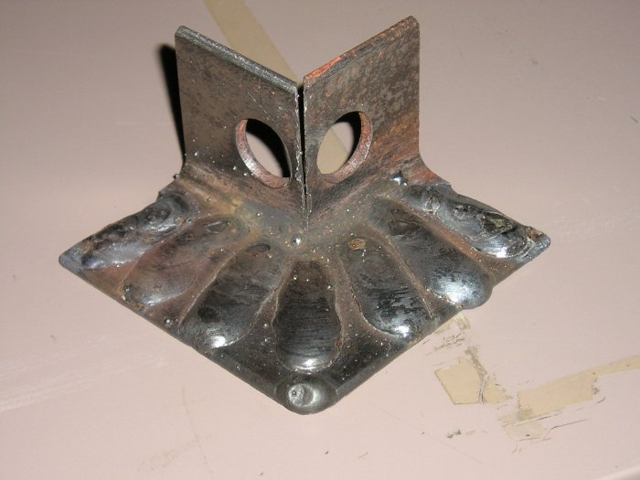

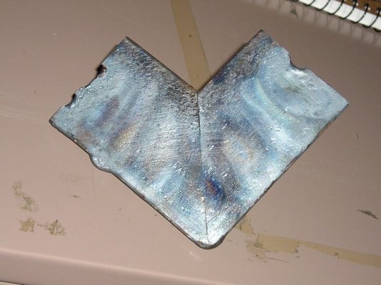

Appreciate any advice on these welds
Hi...
I'm going to weld a frame out of 1/8 inch (3 mm) mild steel angle, and was welding some scraps to get the settings right. I clamped the material flat to my 1/4 inch (6 mm) thick welding table surface and grounded it well. I was using .030 inch / 0.8 mm wire in a Clarke 180EN. The results are below.
I don't have much experience with welding thicker stock with the 180EN where I should be able to get full penetration, but half these welds were done on 3-max and the others on 2-max, which should be the highest (180 amp) and 2nd highest (150 amp) settings. I expected to see substantial distortion on the back of the piece if I'm achieving full penetration, as I do with thinner stock.
Viewed from left to right, the settings were as follows.
3-max speed=3.0
3-max speed=4.0
3-max speed=5.0
2-max speed=5.0
2-max speed=4.0
2-max speed=6.0
3-max speed=5.0
As you can see from the bottom views, only the two end welds came all the way through, and that is probably because they were at the edge of the piece.
So, my questions...
1. Is the 6 mm tabletop acting as a heat sink and affecting the weld?
2. Should I expect to see the same type of distortion on the back side with 3 mm angle that I would with thinner stock?
3. Shouldn't these settings both be too high for this material and be too hot?
4. What should I do differently to achieve better penetration?
Many thanks for any advice...
