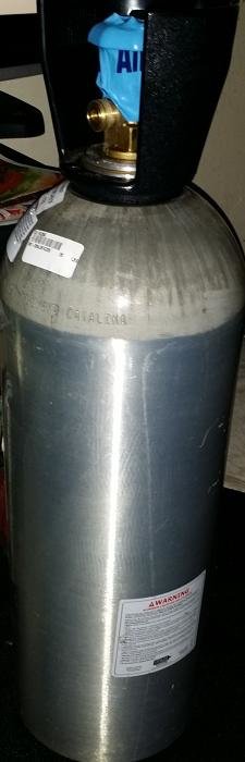

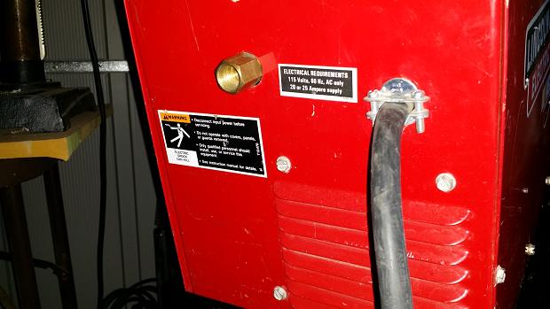

Hi, Im a total newbie when it comes to mig welding. I just picked it up as a hobby. I acquired a lincoln sp135 mig wilder for $75 bucks from a yard sale. I've been use flux core wire and seem to be doing ok. I would like to move on over to gas. I have a soda fountain in my man cave and had an extra expired co2 tank. I took it to airgas and they swapped it out for 30 bucks. I also found a couple gauge in my shed and have no clue how I acquired them (old age). Will any one of these two gauges work with the co2 tank? if so what type line do I use to connect it to the welder? I was thinking barbed fittings, hose and clamps but I could be way off. I went to a LWS and they wanted to sell me a $175 gas kit with free nylon washers included. Way outta my price range. Any help would be greatly appreciated to get me up and running so when I go back to the lws to get what I need I don't get taken advantage of. Thanks in advance.
