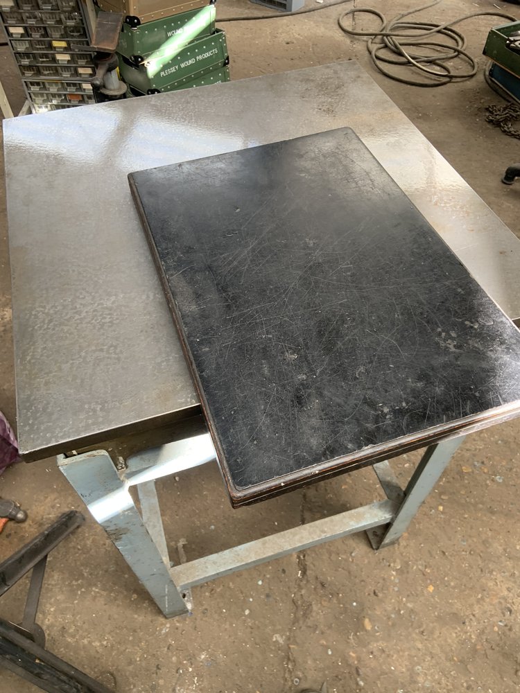

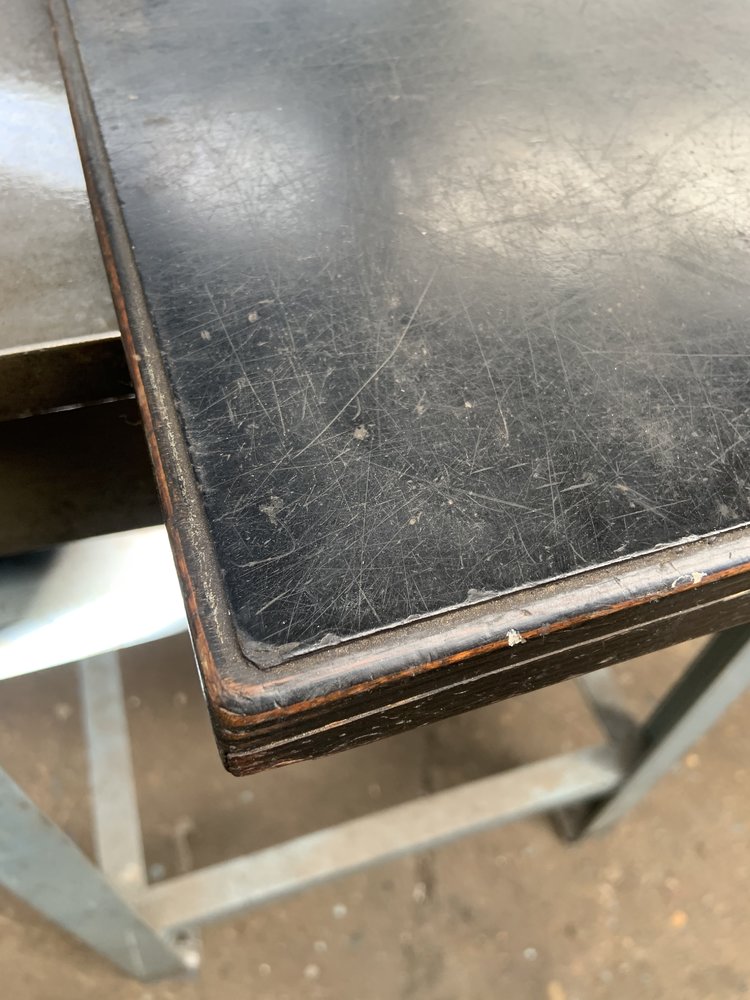

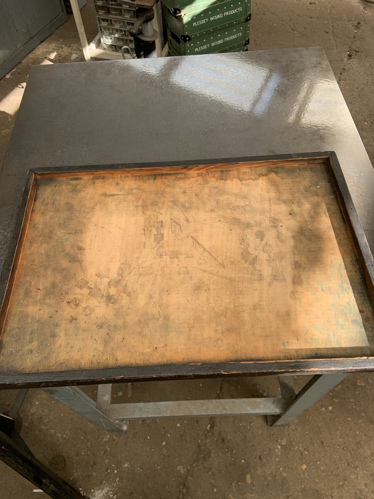

Just imagine it's really thick metal!I was after something properly made like the small one, not mashed together by me. I do metal I’m crap with wood.

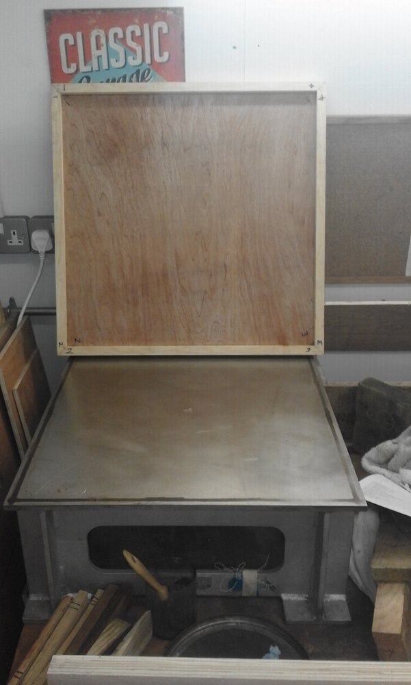

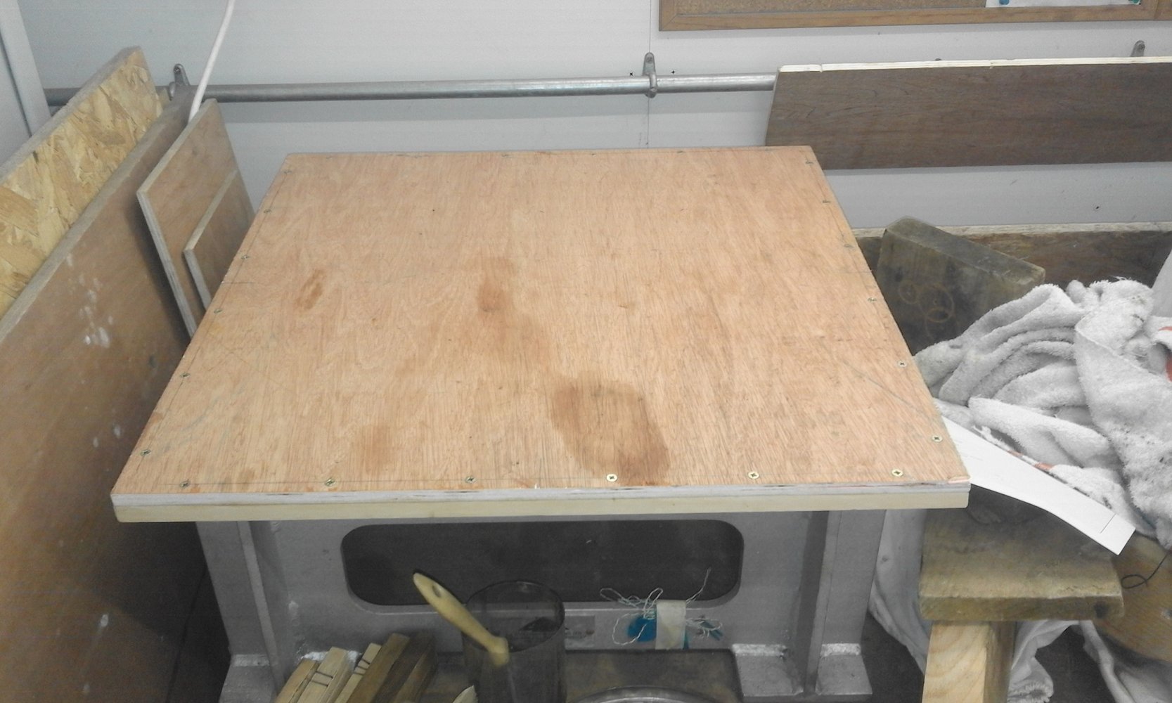

There’s a reason they use wood not aluminium. Wood won’t sweat unless it literally gets rained on.just cut up a piece of ply , say a couple of inches over , get the rest of the ply cut into battens and glue them round the side to make a lip , run a flap disc over the sharp edges , wouldnt take half an hour , jobs a good un.
stick a couple of bits of rubber inside on the corners and the wood wont sit on the table and make it sweat , or oil the timber on the inside ,,,
or fold an alloy one ,,, ten min job.
hence the four little rubbers in the corner idea. sort of like toaster feet .There’s a reason they use wood not aluminium. Wood won’t sweat unless it literally gets rained on.
