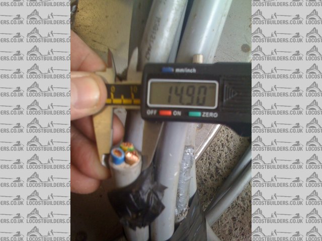

My detached garage was wired when the house was built 20 years ago. A 16amp breaker on the house consumer unit supplies the garage via 4mm SWA cable. In the garage there is a fused spur for the lights and a double 13amp socket. I need to run my R Tech Mig 180 at full power, which blows the 13amp fuse in the plug. Can I just run a feed from the 13amp box to a 16 amp socket or is it not that simple?
