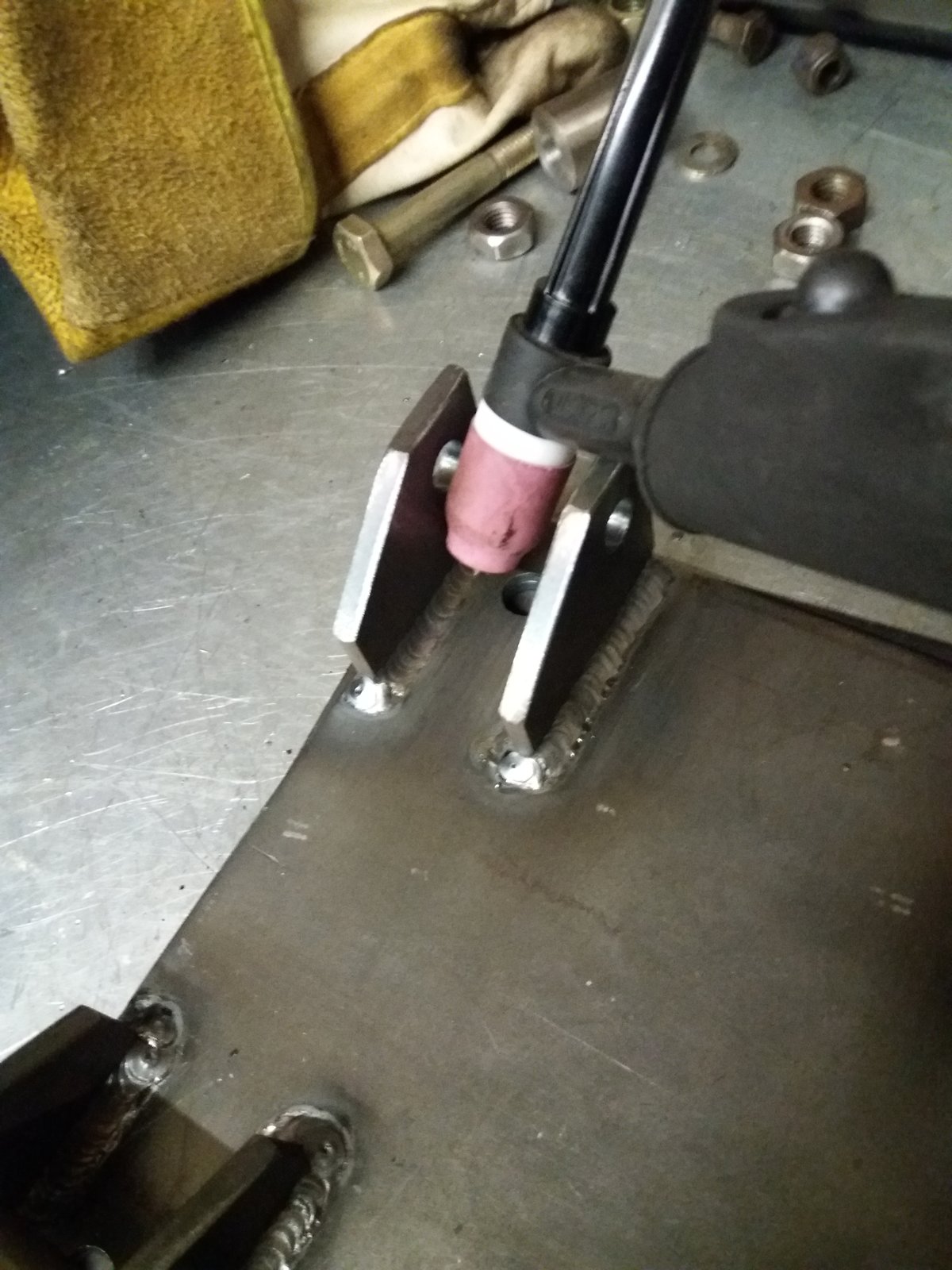

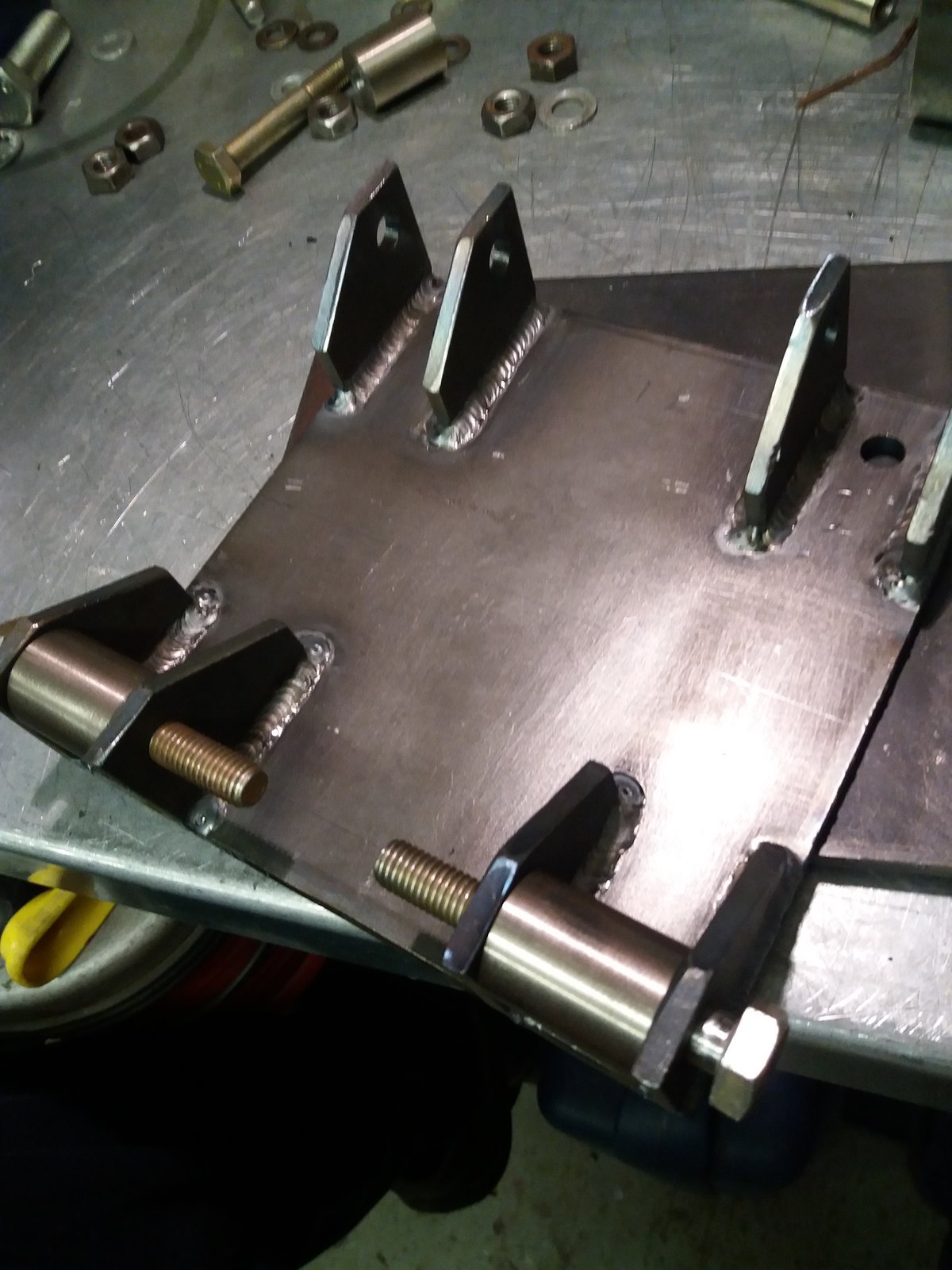

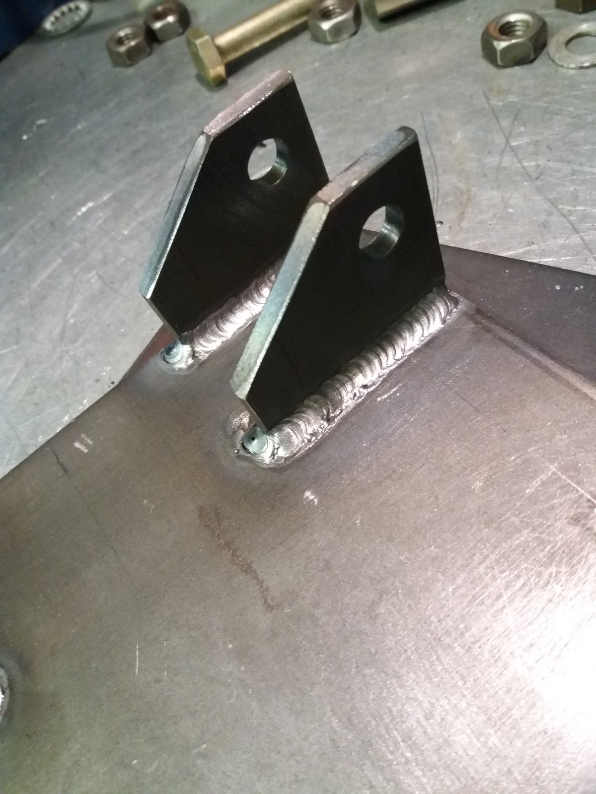

Thought I'd share a weld tonight.
I am still a self taught novice with all welding but tonight I was chasing the stack of dimes look.
This is 6mm plate for a motor mount I'm making for my mill using my new Oxford Tig
Set at about 180 amp max but using pedal
8 lpm and no 7 cup with 2.4 tungsten
Critique welcome.
