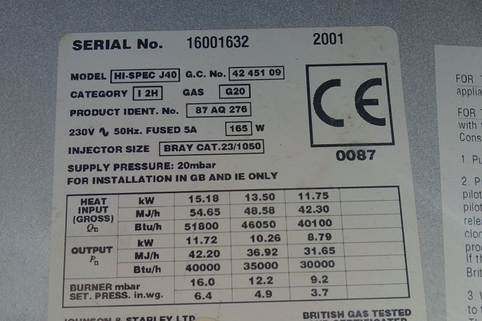

Ok guys, this project has now been turned on it's head.
There is not one gas safe guy who will do what's needed to make it run on bottled gas BECAUSE the manufacturer hasn't done any testing on this unit, therefore, will not release info on parts.
SO, I have two choices, 1. convert it to run on domestic oil, or 2. Turn it into a solid fuel central heating system!!!
Watch this space!!!
