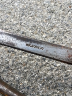

I'd be guessing but maybe 1950's?

Fekin OuchFiring is (was) a practice of repairing injuries.
Say a horse damages a tendon on the back of its leg (very common injury) you would take that flat tool (top one in the op's photo) heat it in the forge, and run it round the back of the horses leg a few times.
The idea being that the burning would encourage blood flow to the area and the scar tissue would make a stronger repair.
Commonly done in race horses to get them back into work quicker.
That's bar firing that leaves a set of stripes on the back of the horses legs.
The middle tool is for pin firing, same idea just done in multiple spots.
The top tool is a tail iron.
If you find an old picture of a race horse often they have very short tail with a square end. You cut the tapered tip off the boney bit of the tail and then put the hot iron on it to stop the hair growing back tapered.
