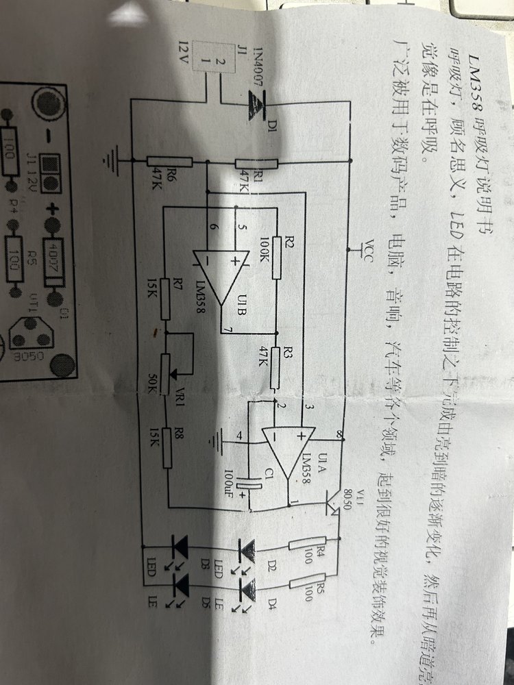

I think the op amp with a cap in its feedback loop makes the whole lot oscillate, frequency is probably modified by the potentiometer.
It's a posh LED flasher

LM358 Breathing Light Instructions
As the name implies, the LED light changes gradually from bright to dark and then from dark to bright under the control of the circuit. It feels like breathing.
It is widely used in digital products, computers, audio, automobiles and other fields, and has a good visual decorative effect.
