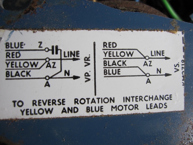

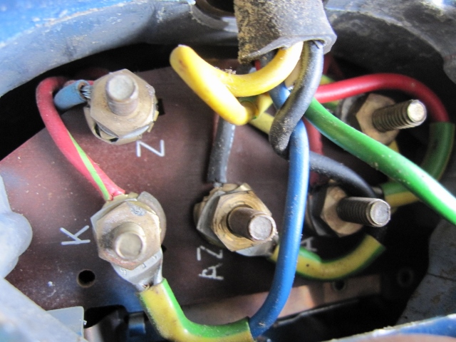

Been stripping and cleaning my recently acquired Super 7 but I thought I should wire up the motor to see if everything worked. I thought most single phase motors were wired to A,AZ,Z and T but on this one it's A,AZ,T and K.
Wondering what the K terminal is and how the motor should be wired as it just came with a trailing cable. There is no makers plate on the motor but it's painted blue, so may not be the original - the lathe dates from 1968-71.
