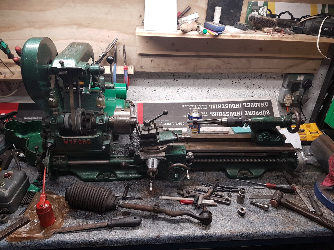

yours is a 2 belt from the motor so does suffer from belt slip as you enguage and disenguage ( clutch ) the belt to the head stockThanks for all the replies. Sorry Gaz I wasn't quit following what you meant.
No, the belts aren't slipping as far as I can tell. When sufficient load is placed on the work piece, the motor slows down and the chuck will eventually stall. Once it's stalled everything speeds up again and keeps spinning. So where could it be slipping?
It's a Bernerd chuck I believe.
Unfortunately I can't take a look at it until next weekend. The pic attached is the best I can do until then.
you also have a backplate before you get to the chuck
if you look at your pic alone the spindle is all one piece to a degree if that piece was spinning as you said and the backplate or chuck wasnt then you have an issue with the backplate chuck area
if that spindle wasnt spinning and the belt pulley was spinning then you have an issue with the pin that connects the spindle to the belt drive system
theres only 2 ways i can think of to stall a motor out
motor not strong enough to spin
or
too deep of a cut is being taken
