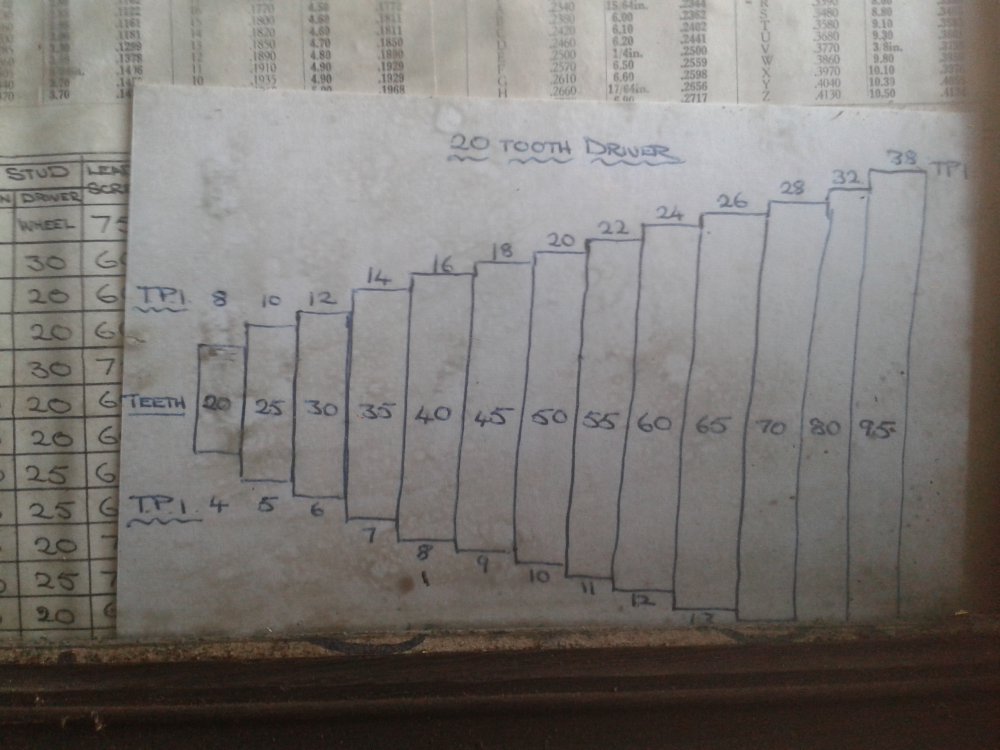

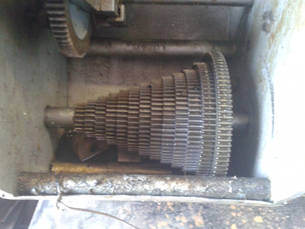

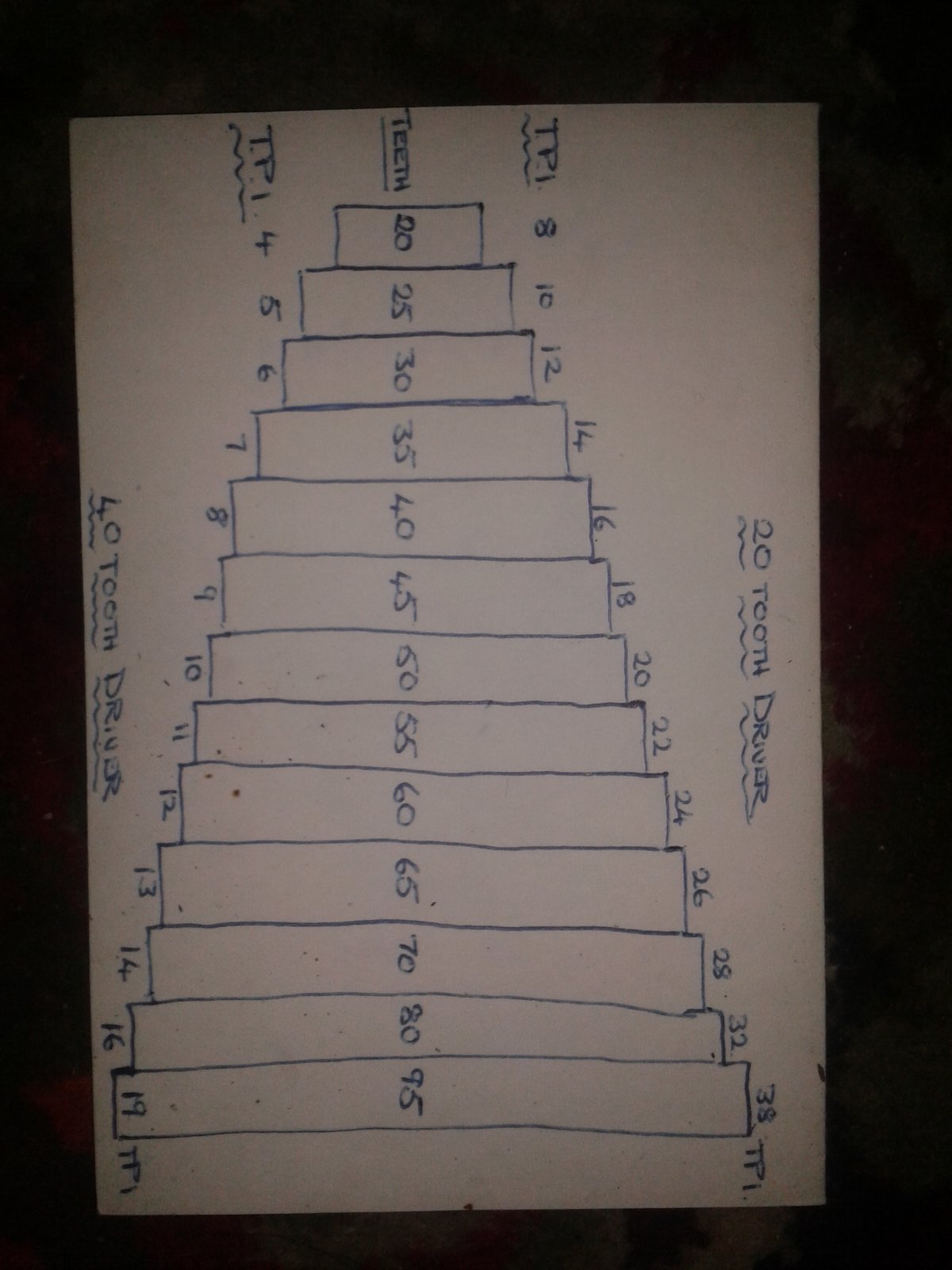

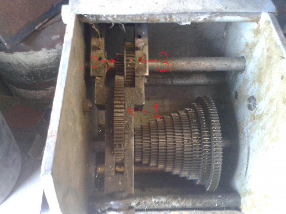

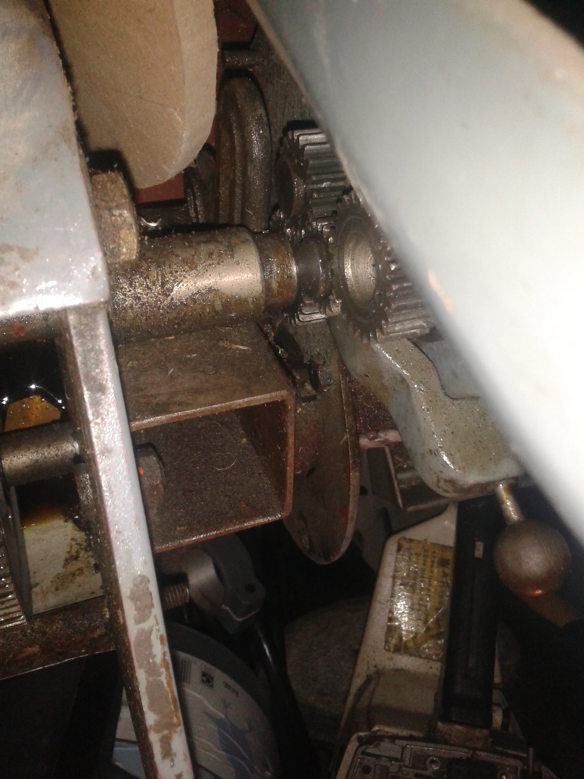

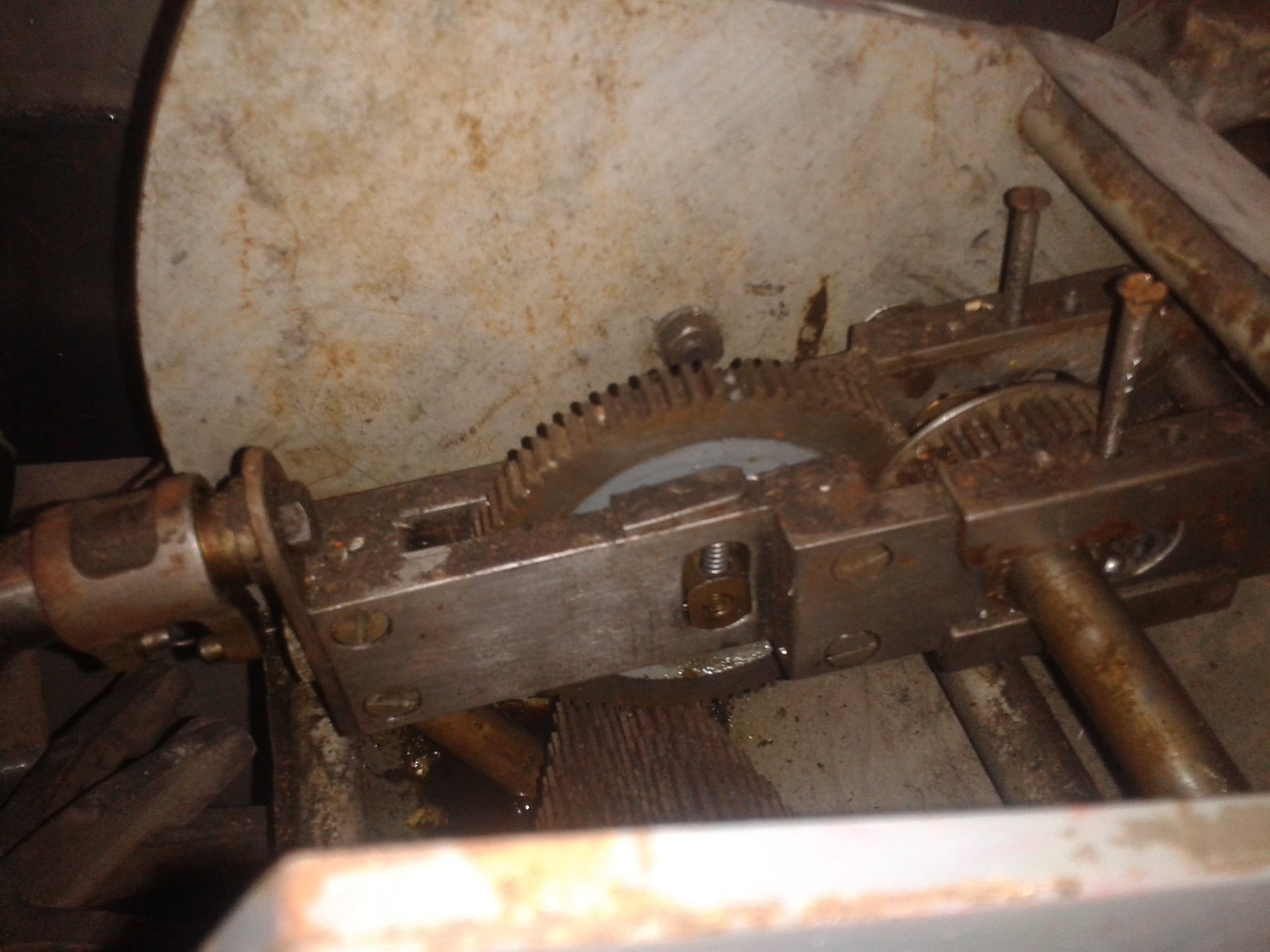

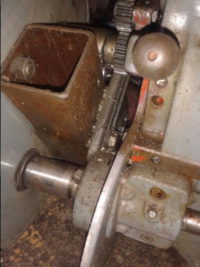

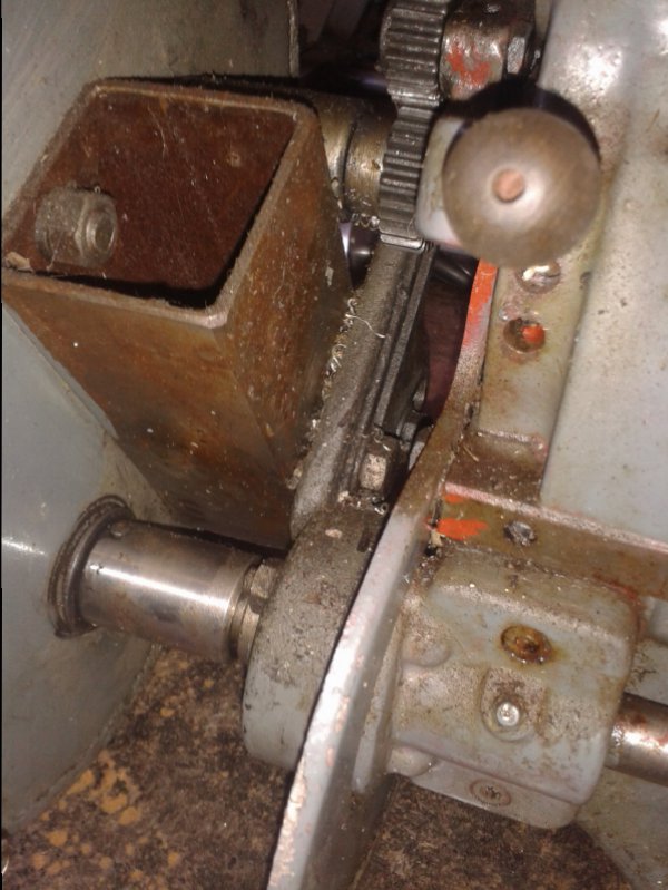

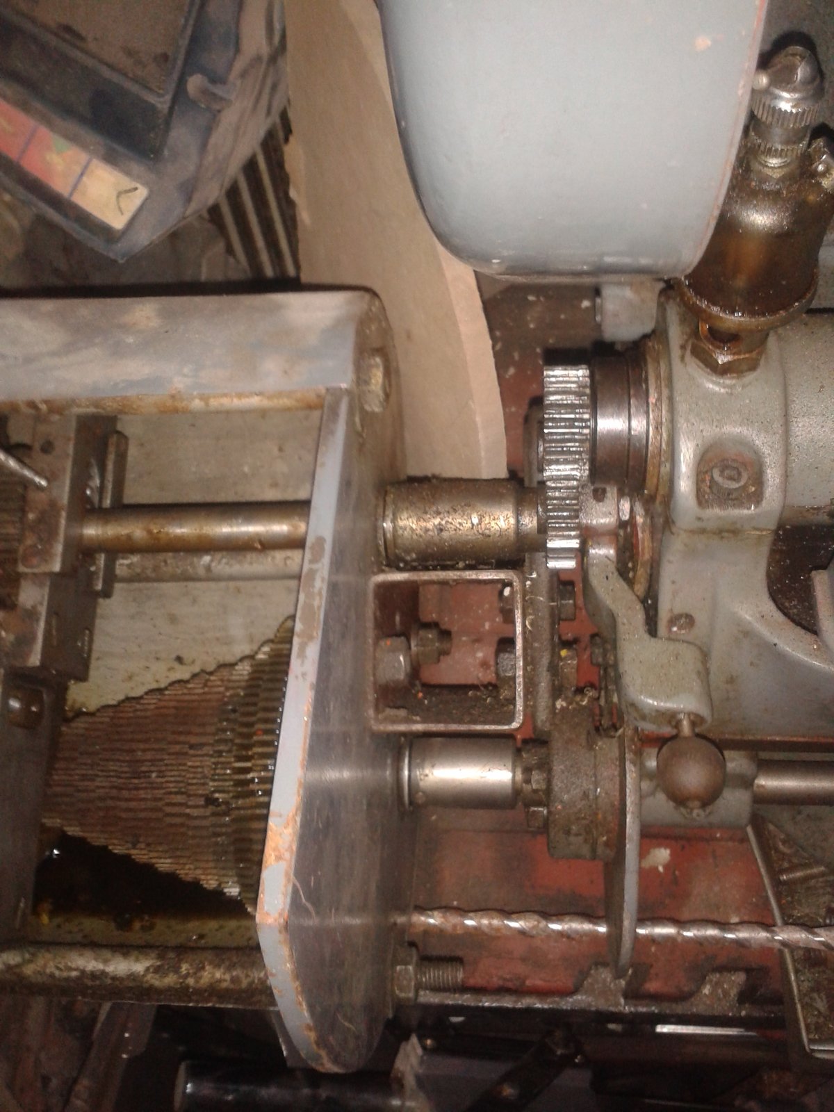

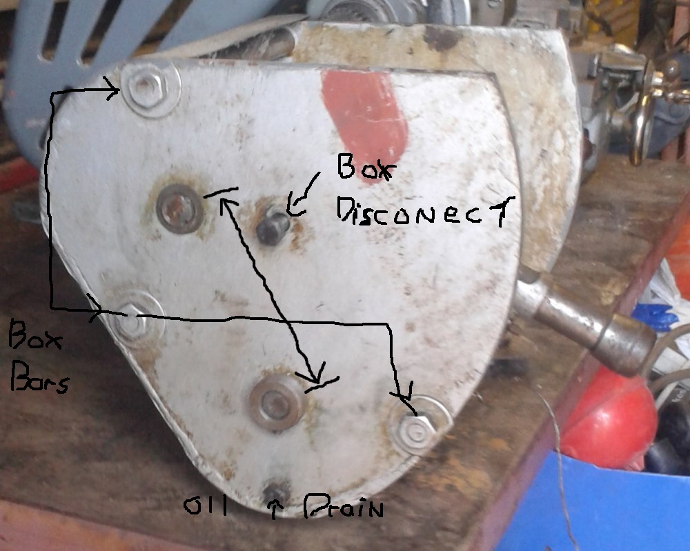

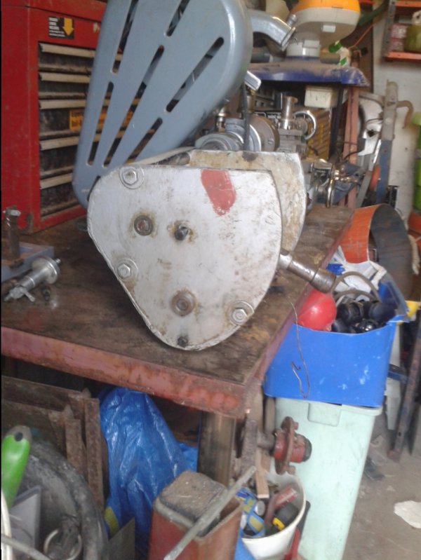

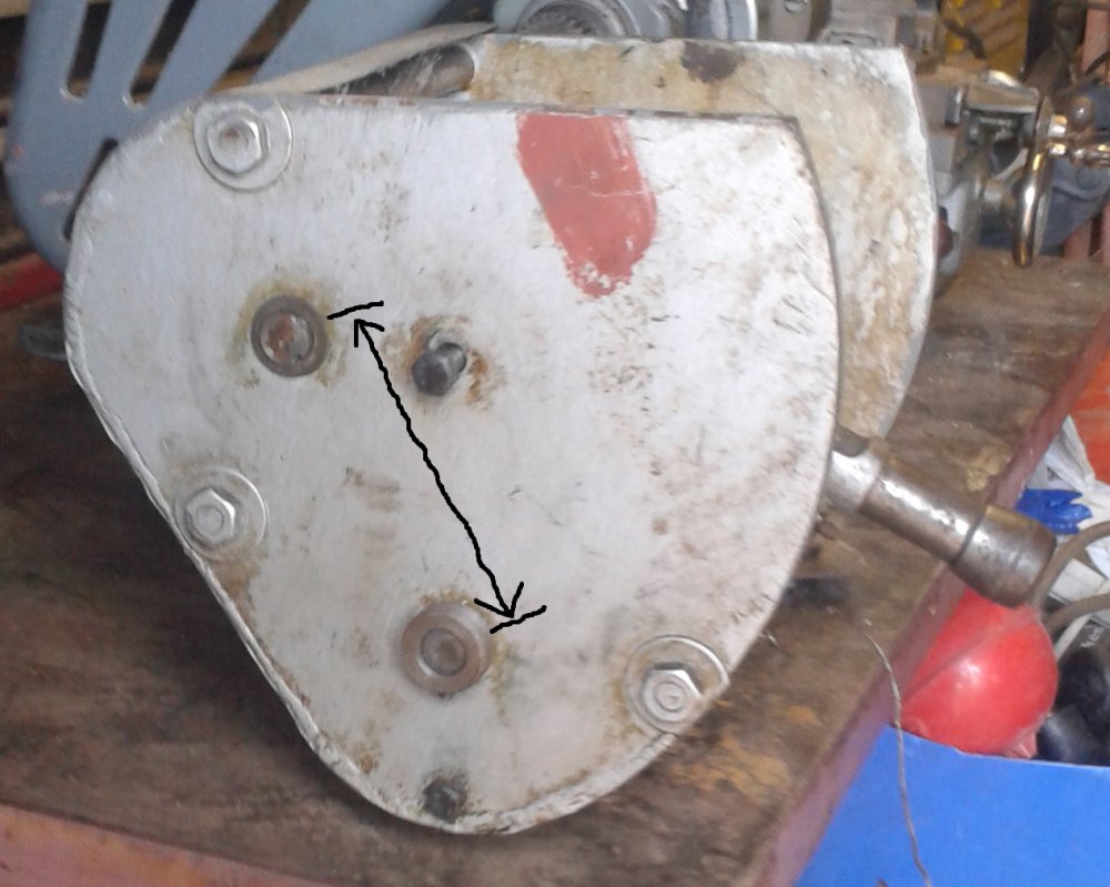

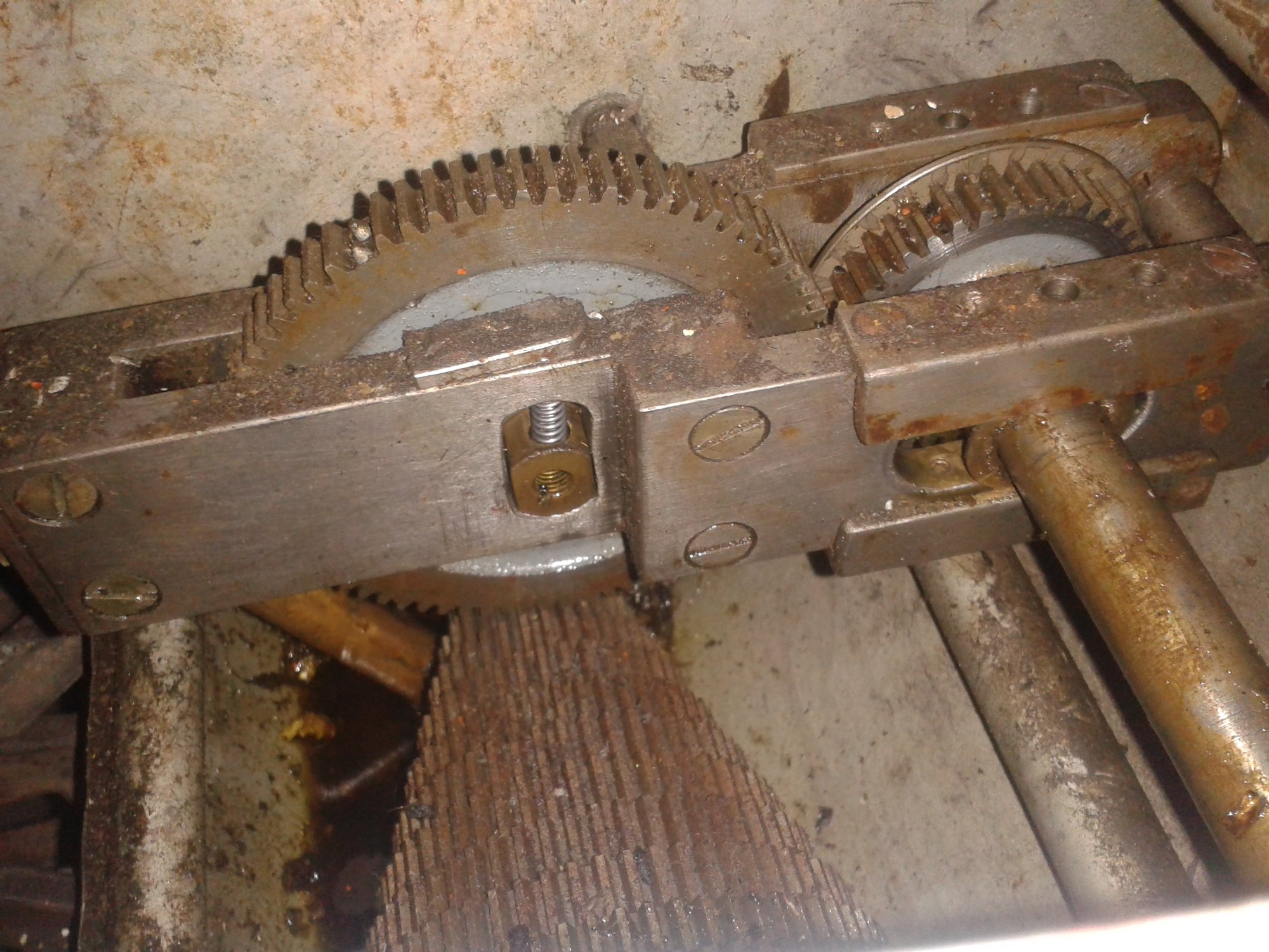

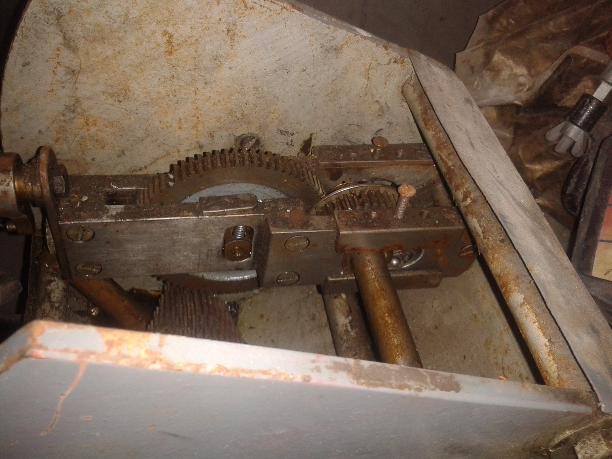

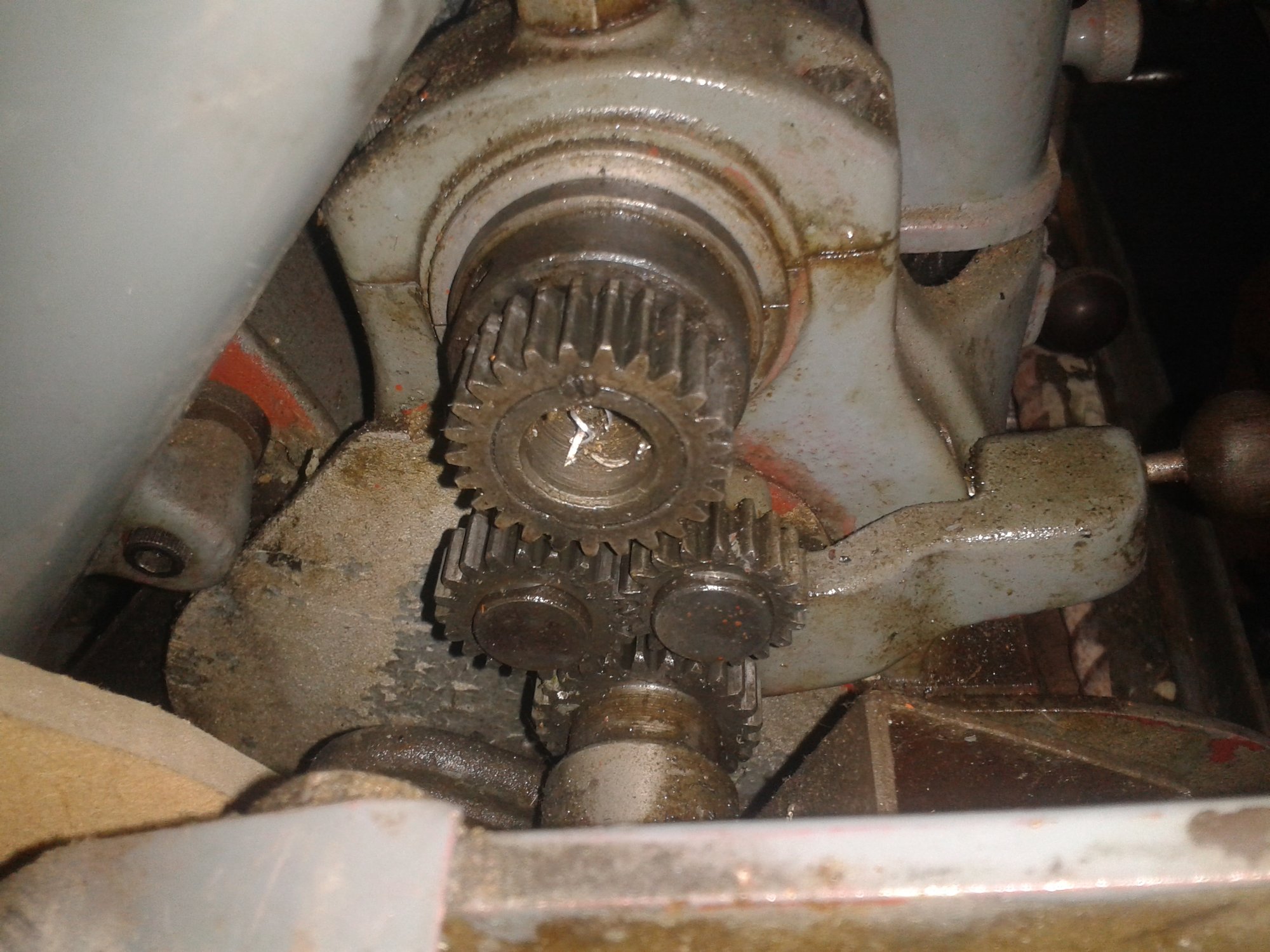

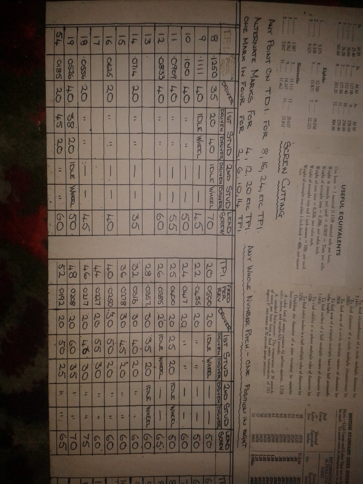

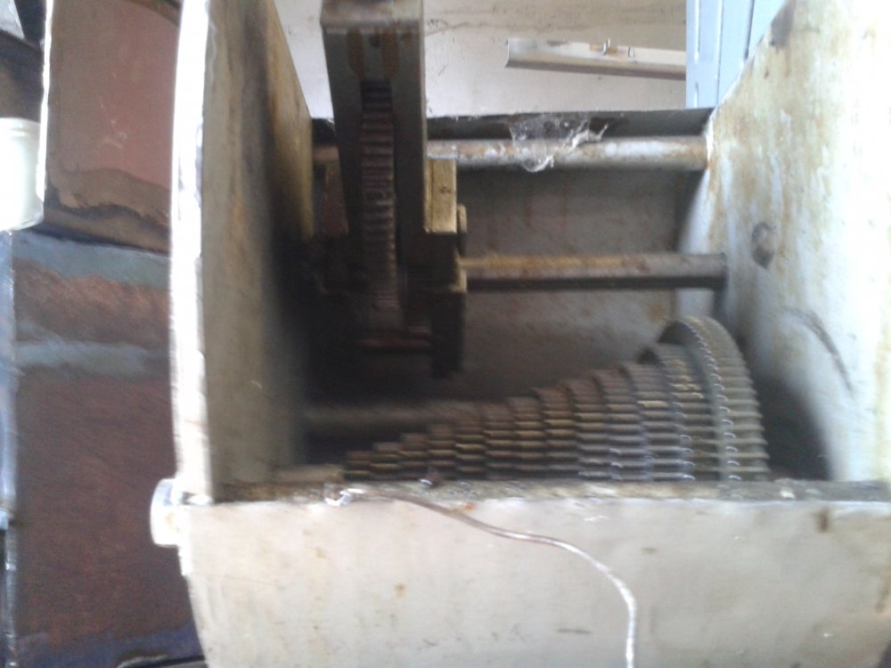

this is the gearbox to the lathe photos only and diagram to it in a seperate forum post

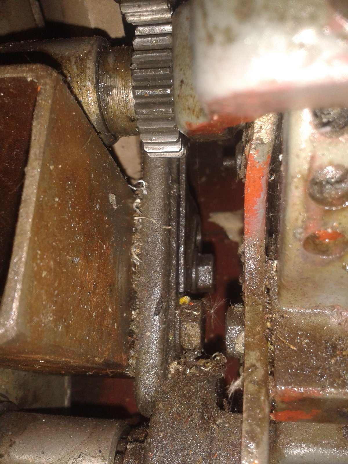

I wondered that and then I spied a wire on the front edge that I guess gets wrapped around the handle.Thanks for the detailed pictures.
I still cant see anything holding the swing arm down and keeping the gears in mesh though. Not such a problem on ordinary cuts the odd slip wouldn't matter but screw cutting is a different matter.
