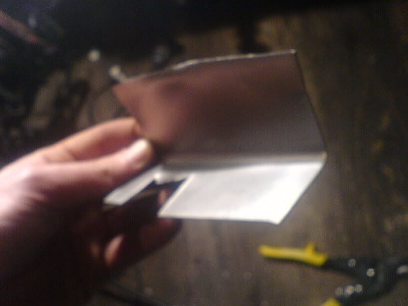

Iv recently got a draper 95 gassless, tbh its pretty crap lol but as im a total novice i guess it will do untill my skill level gets better
The current project i have is a corsa gsi, i got the car with the c20xe engine installed, however over the winter the car is off the road in need of some repairs and upgrades, one of the up grades is the C20let engine with the the turbo'd version of the 16v engine that was currently in the car
Its highly Recommended that alot of strengthening is done to the engine bay and you are able to buy the steal plate that is cut into the shapes that you need for the corsa engine bay off of ebay, however i grudge playing for them as there only normal steel plate cut into the shapes that you need
Anyway with the 16v engine out i started to take of the anti-roll bars, and to my shock the front bottom crossmeber could very easly moved and twisted by hand, so with some more inspection i found that there where some big cracks along the join and in some places it was borken off
the bottom section seemed to be ok, but the bottom wasent, so i tack welded the along the seams
The penertraion looks ok and the cross member was held in place but i wanted some extra support
So i whent down to the local motor factors and got myself some 1mm sheet metal, after cutting out the section i needed to compaired the sheet matal to the thickness of the metal on the car and its only very slight thinner, but when i when't to weld it in the sheet steal just seems to melt a whole lot easyer then the steal on the car, i looked into the other side of the engine bay and the Penetration was minimal in some places and in others the paint was only scortched, iv some thicker steal, 4mm so i might cut out that thin crap and try some better gear, i dont think iv did to badly as iv only read the guides on this site to help me along

) the bottom one doesn't look too bad, the middle one is not brilliant but the top one looks poor. The left side of it is better than the right side. Like gasman says, it looks like you've tried to join several tacks up. When you tack a plate on you only need just enough tacks to keep it in position. Relax, hold the torch steady with BOTH hands, one holding it and the other steadying it, I tend to rest the neck of the torch on my left hand. The top one is a vertical piece so the weld pool will want to fall downwards which explains the lumpiness on the top edge of the plate. You need to compensate for that by making sure it's actually penetrating the original steel and not running off it and into the edge of the new plate. Do lots of test welds on scrap and make notes of power/wire speed settings so you know what works best and what your machine's capable of.
