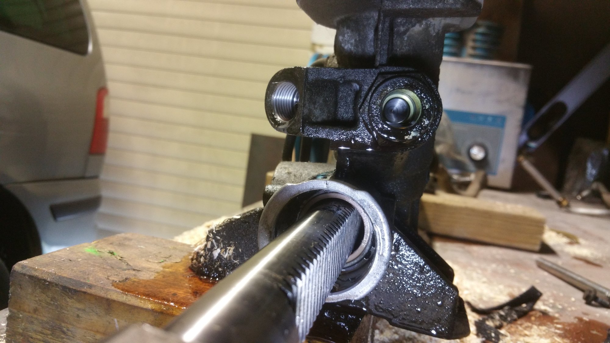

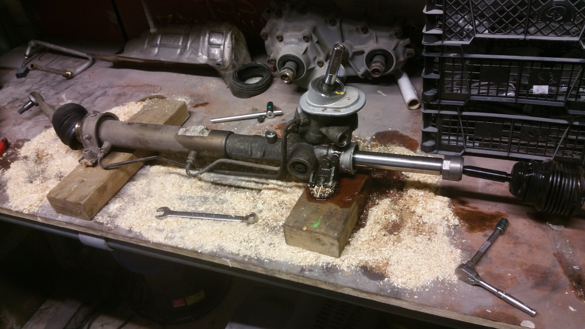

Removed the leaking steering rack from my 2003 Galaxy. A new recon one is on it's way (£100). When I peeled back the gaiter on the end of the steering rack oil poured out. On closer look I can't see any seals on the ends of the steering rack. Both gaiters on both ends were full of oil. How could this be? No seals?
The oil leak was from the end of one of the gaitors. The leaking gaitor was tied down with cable ties. The non-leaking one had some fancy OEM clamps.
