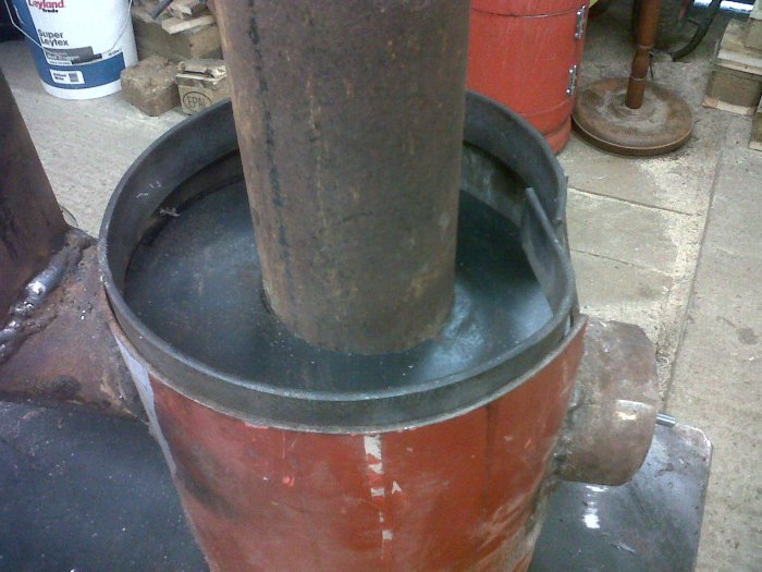

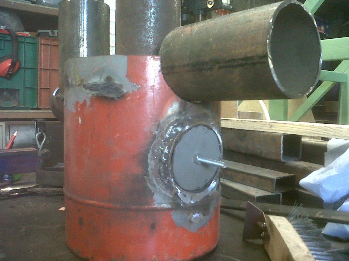

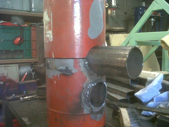

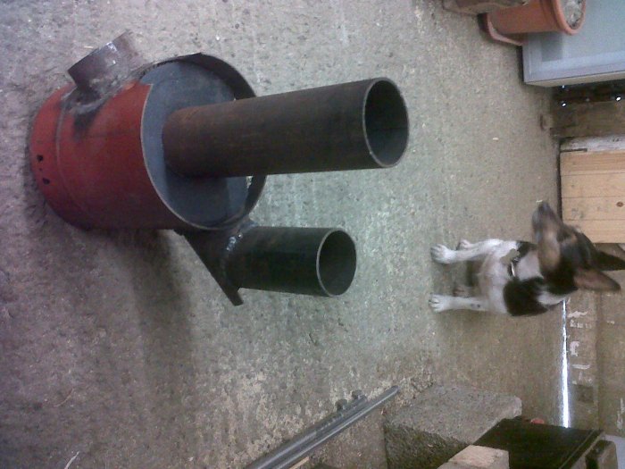

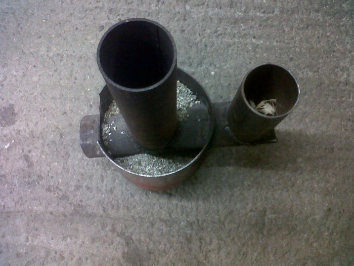

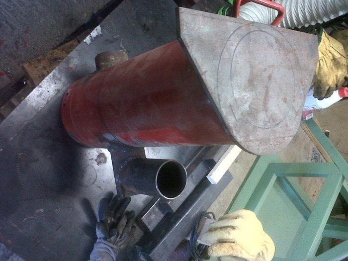

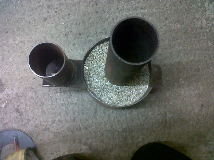

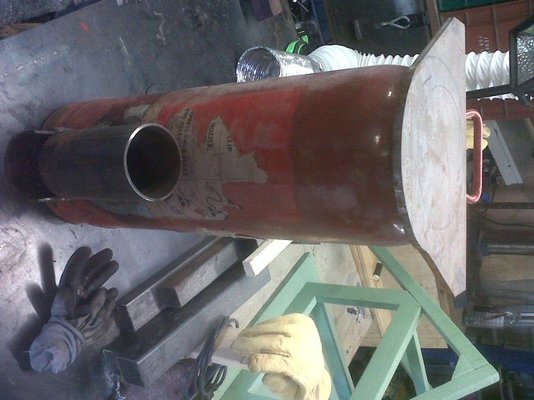

hi I said i would try and post some pics of my rocket build has been slow due to working too much but here's where i'm at so far.
I cut the extinguisher first then drilled the holes next I made the burner tube and internal flue from 75mm tube 3mm wall welded that into the fire extinguisher.
then i made the joining ring to couple it back together and finally cut a plate to sit in around the chimney. then filled the base with vermiculite. just got to make a liner for round the chimney to also fill with insulation.
I will keep updating, ps pigeon welding cos gas ran out DOH http://www.mig-welding.co.uk/forum/images/smilies/ashamed.gif
