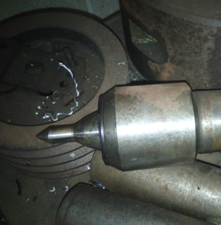

Surely a live centre?
you should be able to change the bearings for ones that might last a bit longer
It's going back - big enough bearing housing - perhaps I just had a bad one?
But it felt fine turning over by hand - a tiny load and it's knackered!
You are better off buying second hand European or American tools. Even used they are better than the chinesium muck straight out of the box. I persevered for years with chinese boring heads, gave up on them and spent a wedge on an American made Criterion. Night and day, no comparrison.
I agree. But I couldn't find a long and pointy used British one....

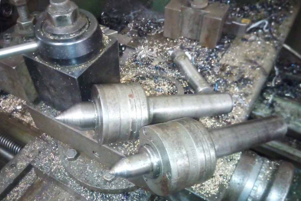

Here are a couple I have done,You have a lathe, turn one down to what you require or if you require longer make one.
Having never done this, I'm curious about your set up ? Did you have to make up a special dog for the narrow shoulder of the live centre to immobilise it in order to rework it ?Here are a couple I have done,
turned one of these
Into this.
These two were once identical.
Removed the shaft from the bearings and housing then used soft jaws on the lathe, 4 jaw would be OK as well but means you have to clock it in. I am lazy so tend to bore out soft jawsHaving never done this, I'm curious about your set up ? Did you have to make up a special dog for the narrow shoulder of the live centre to immobilise it in order to rework it ?
Ok thanks. I was looking at the first photo, and could not see any way to disassemble it; but I now see the ones you modified do have screws.Removed the shaft from the bearings and housing then used soft jaws on the lathe, 4 jaw would be OK as well but means you have to clock it in. I am lazy so tend to bore out soft jaws![]()

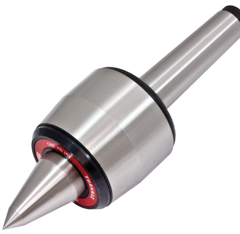

Nice price as well though .lolGeneric Chinese live centres are junk, the Kennedy one is nice and the different tip styles are useful.
https://www.cromwell.co.uk/shop/cutting-tools/revolving-centres/standard-duty-interchangeable-revolving-centre-sets/f/3988?query=kennedy revolving centres.
