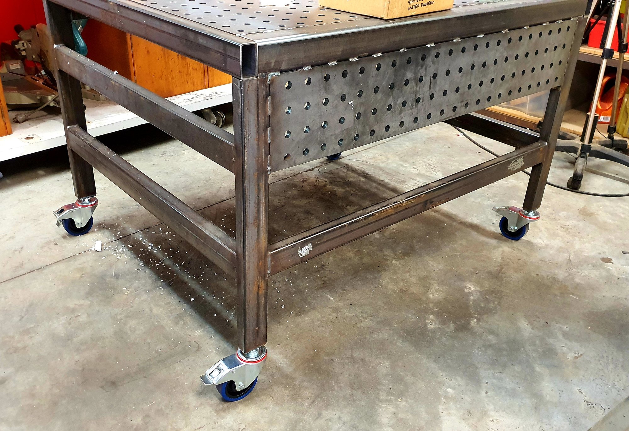

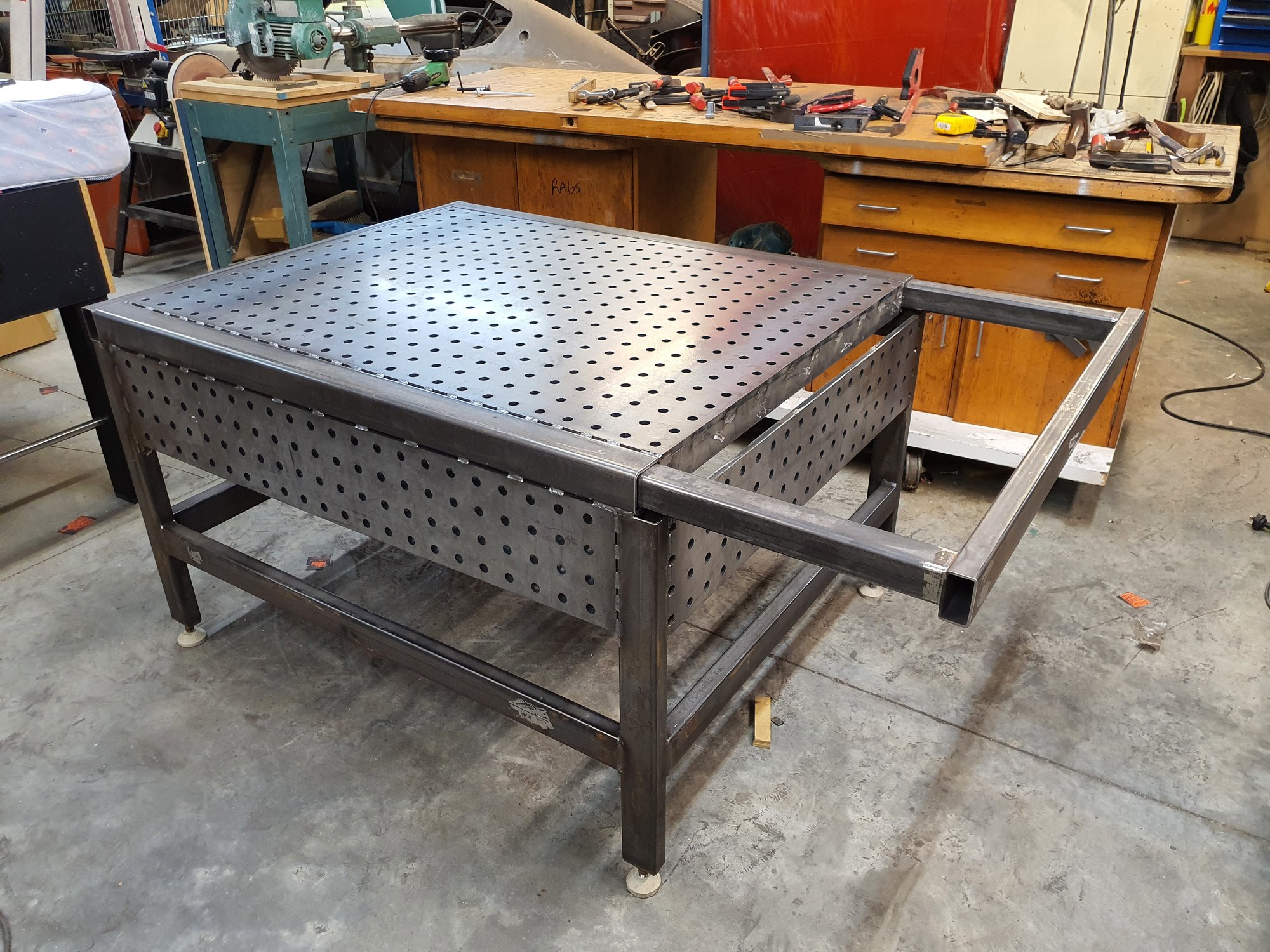

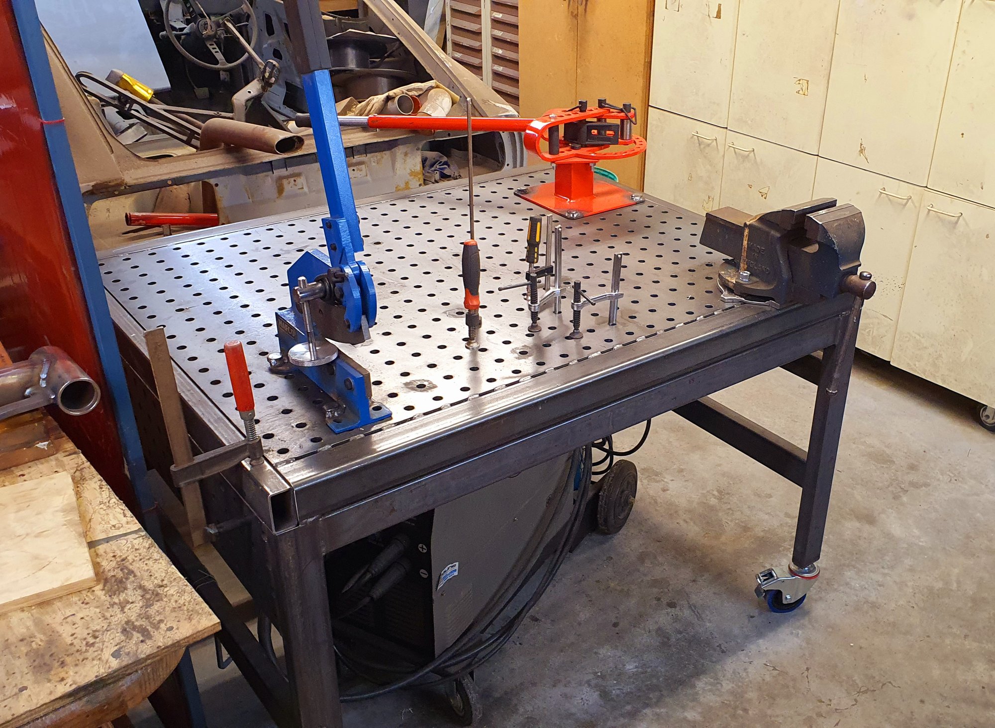

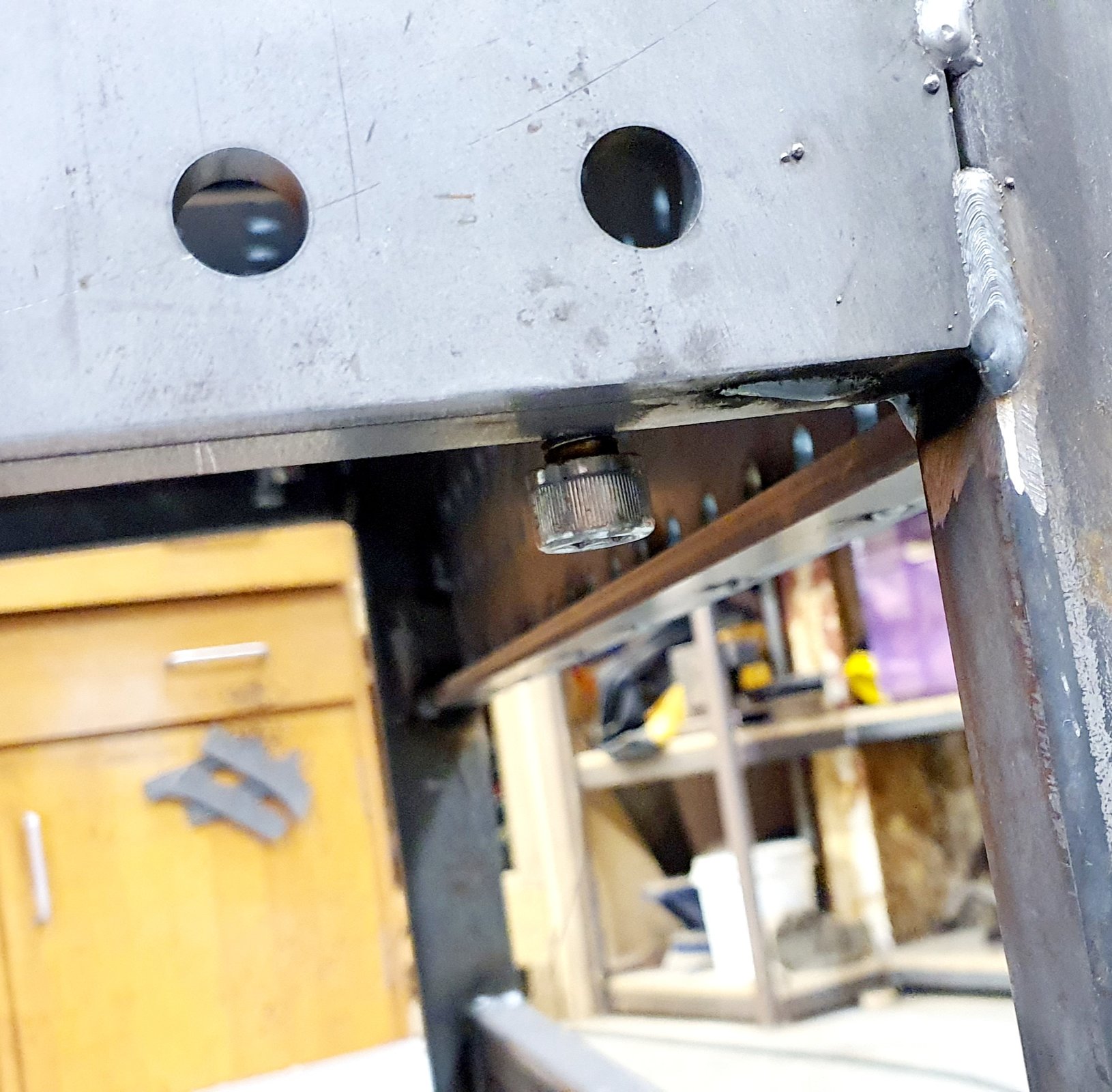

Just thought I would share my latest project with you all.

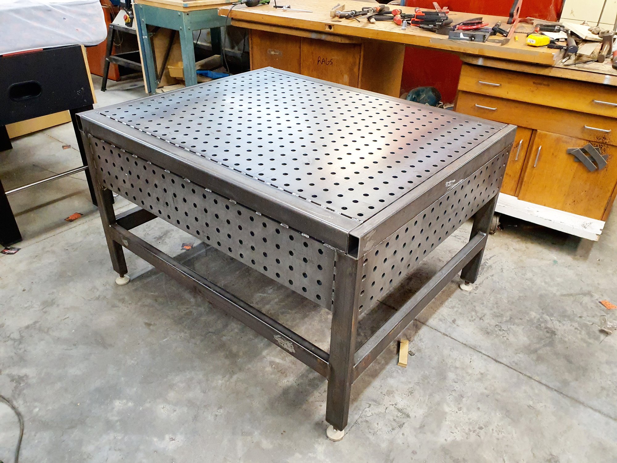

I wanted to upgrade my old welding table so after doing a bit of research I came up with the following.

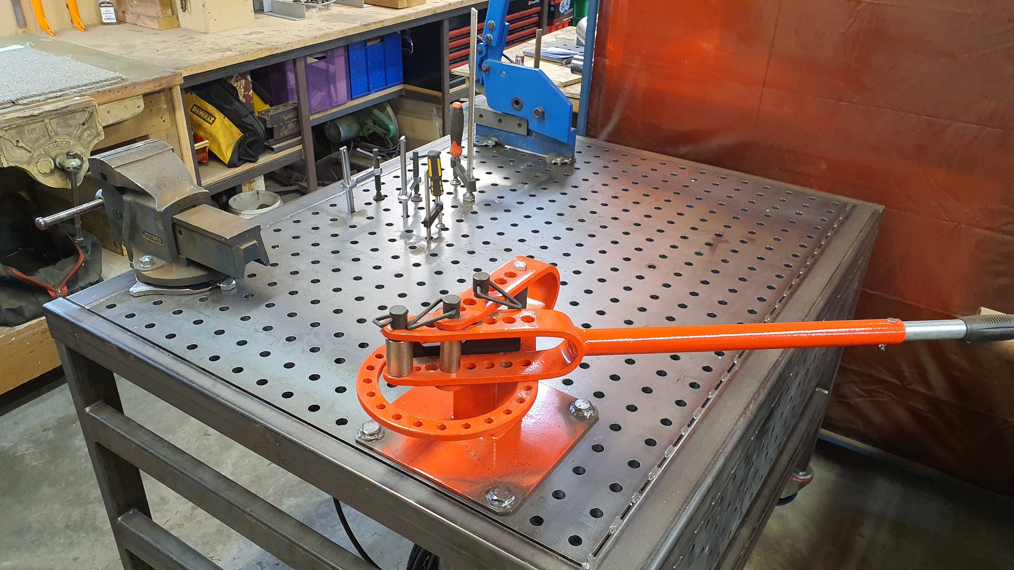

Was only planning to have the hole plate on one side but due to the cutters stuffing up the placement of the holes (and supplying a replacement super fast) I trimmed the old part down and put it on the side.

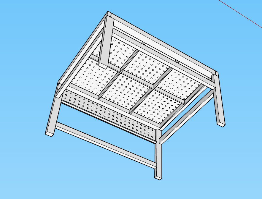

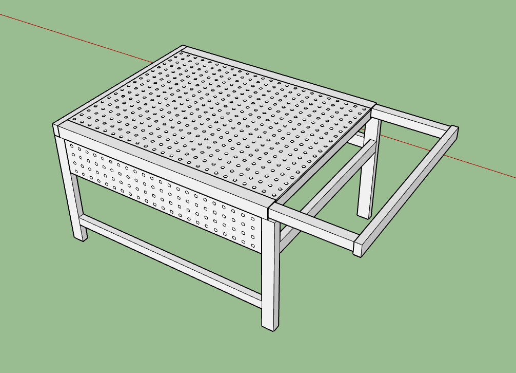

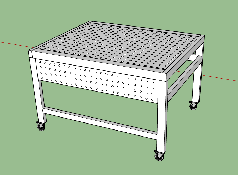

First I did some plans on Google Sketch Up.

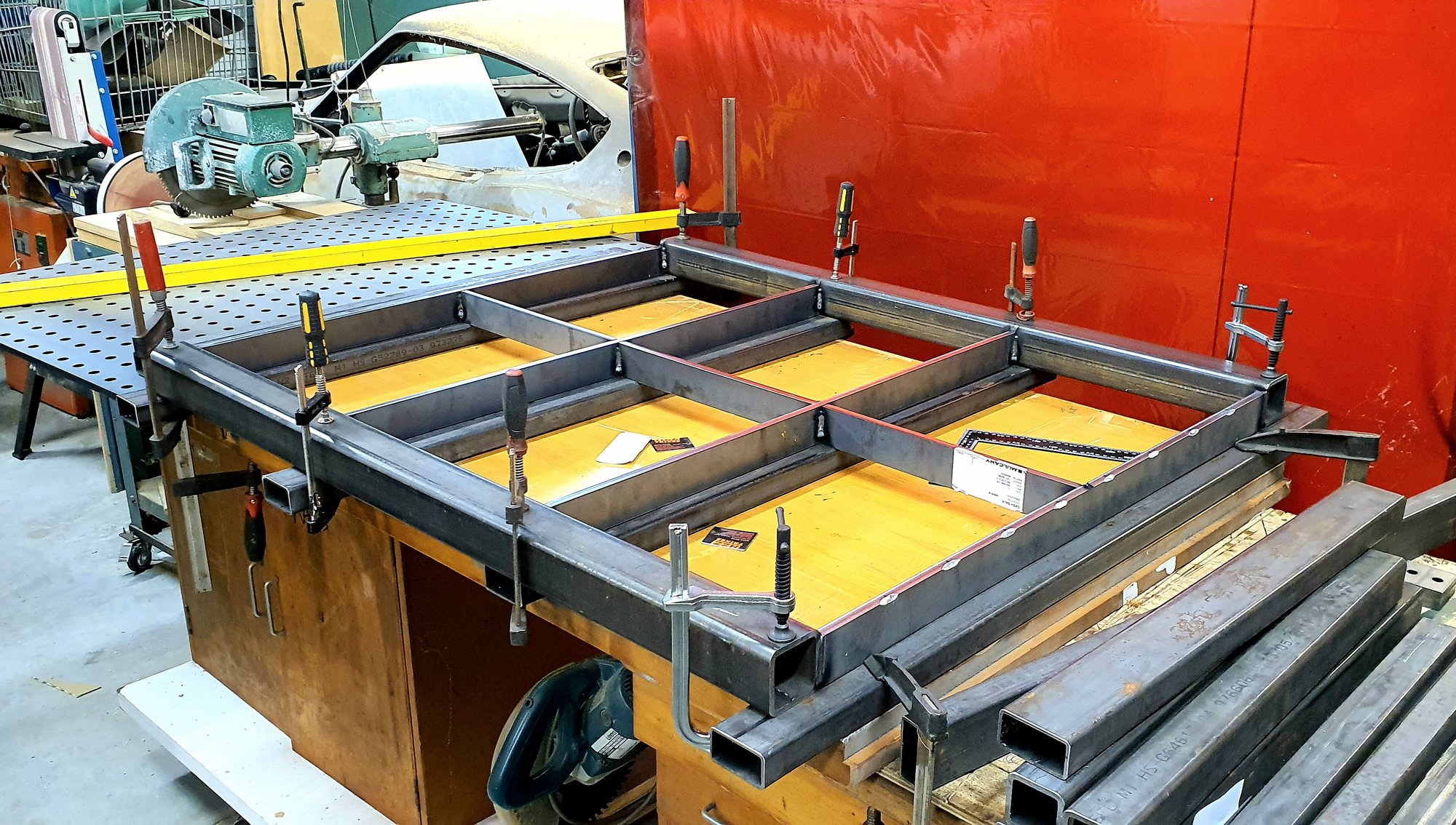

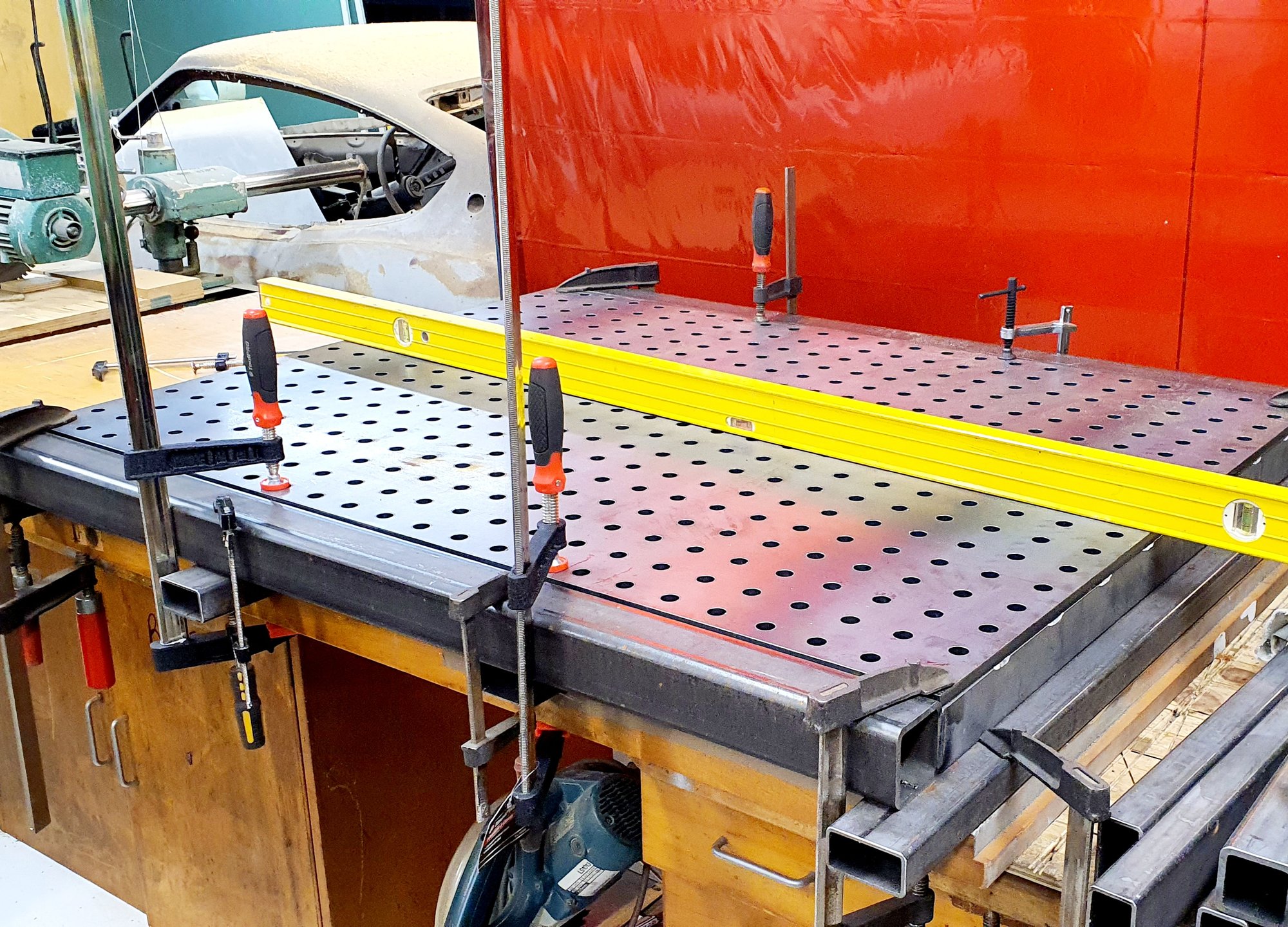

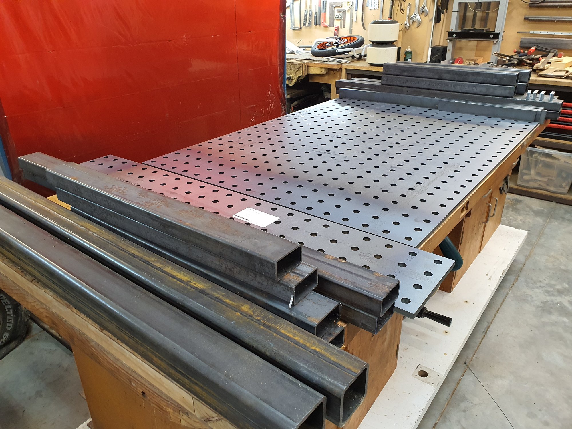

Then ordered the laser cut parts.

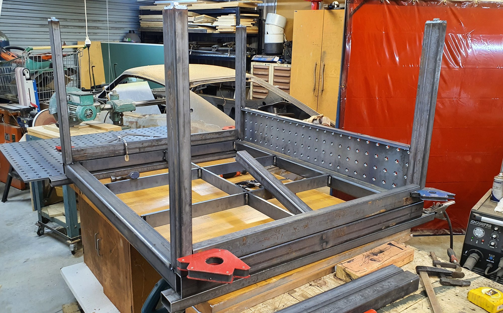

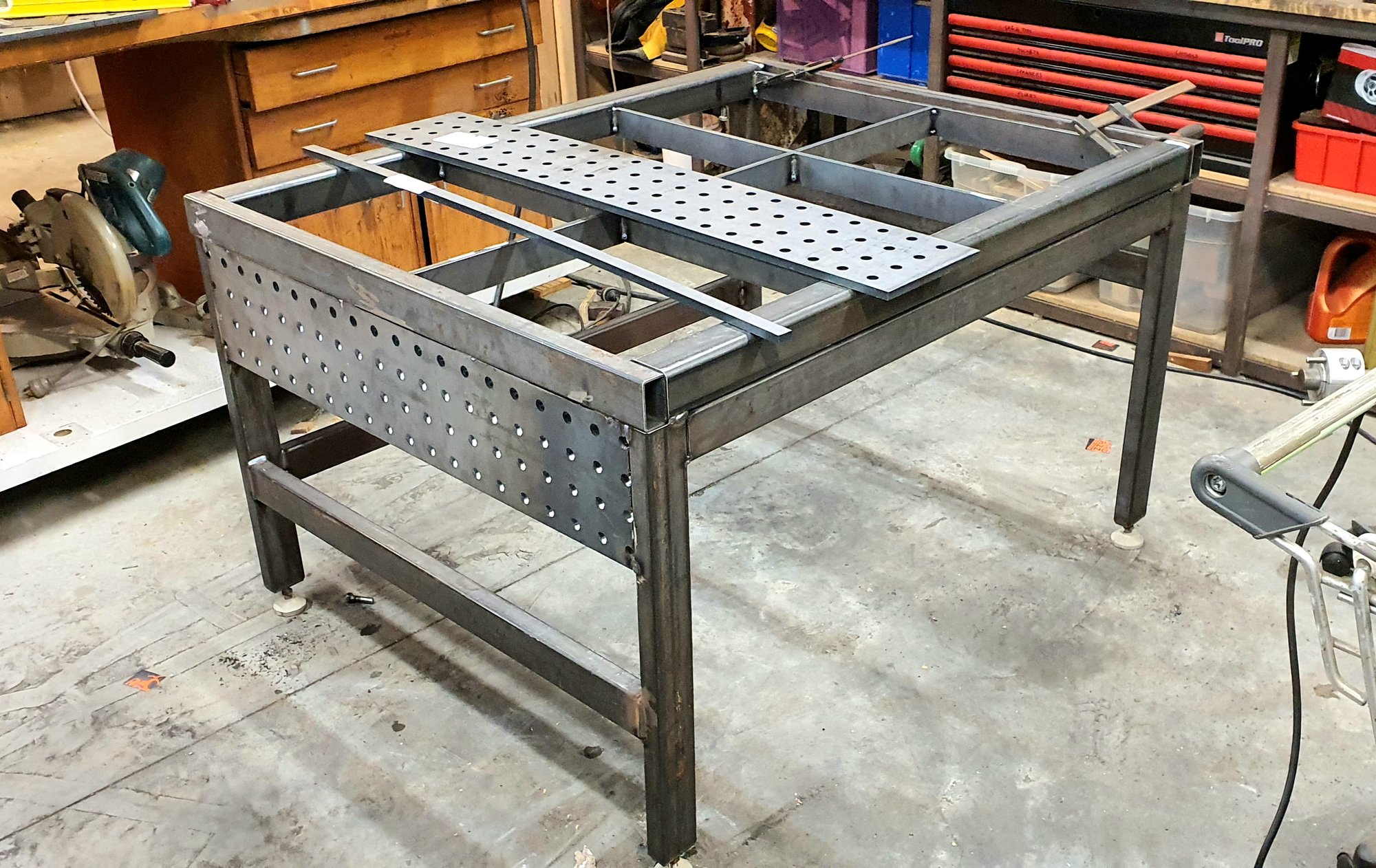

And ordered the rest of the steel pre cut to my order.
(my old welding bench included in the pics).

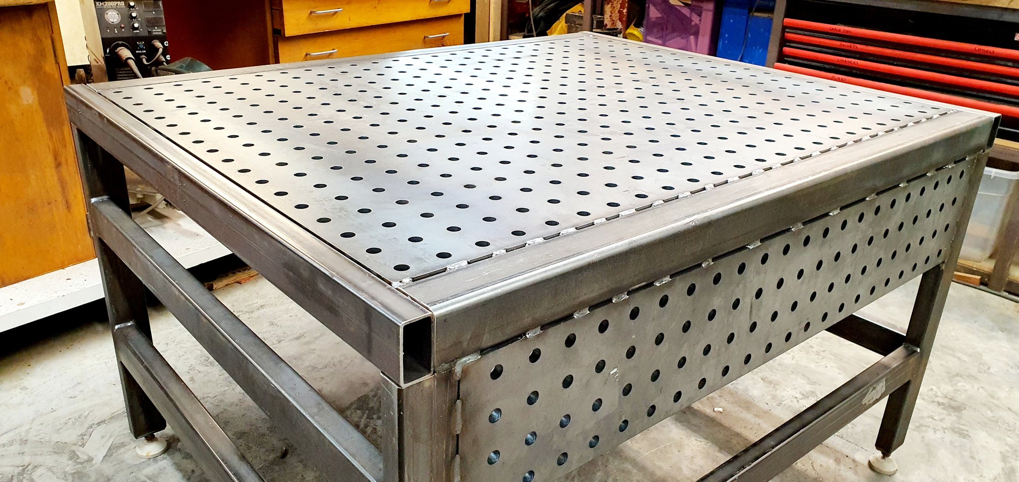

It weighs around 180kg.
Top is 12mm (as well as side parts)
Main rails are 65x65x6 with 50x50x5 sliding rails.

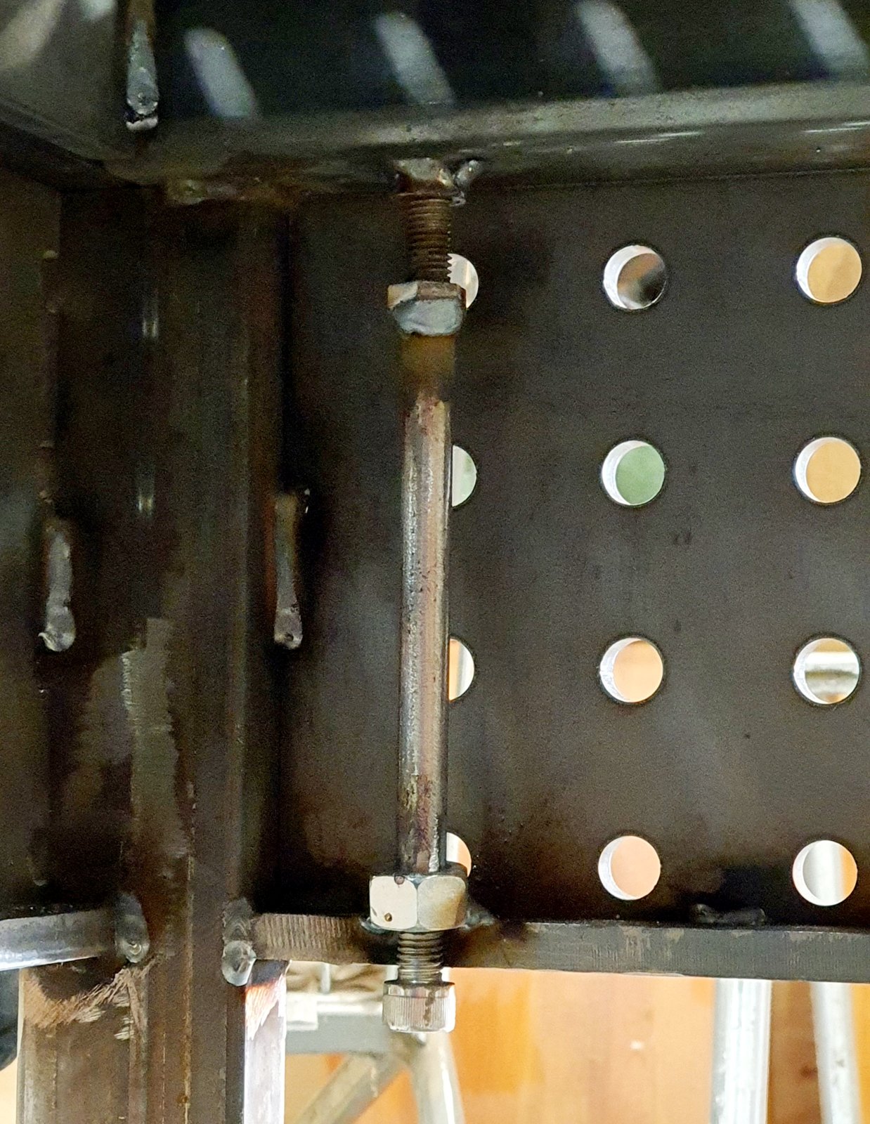

Bolts underneath to lock and level the rails.
More pics to come...
