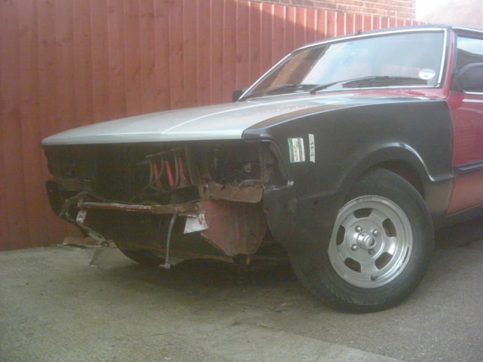

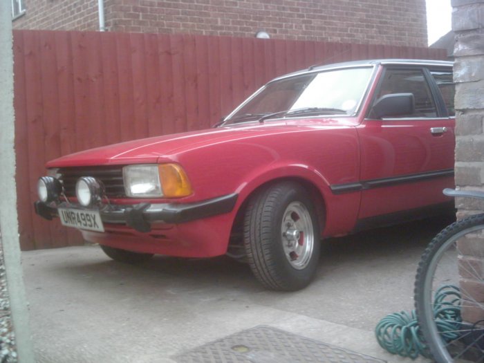

hi guys, long time lurker but first time poster thought i'd share some pics of my mk5 cortina. this as been in my family since it was 3 years old having been a company car for rolls royce in derby. i've restored it once before during 2000/2002 working outside but by 2010 with 350,000 miles covered it was getting untidy so i fitted new front wings, bonnet and front valance and painted them in 2 pack

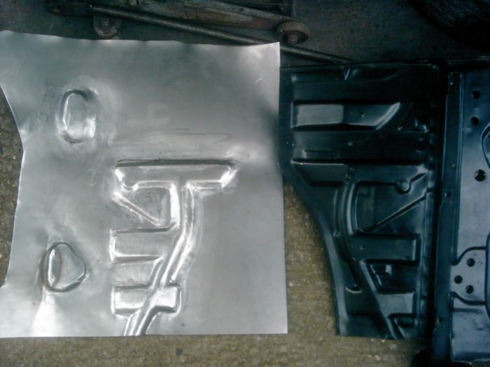

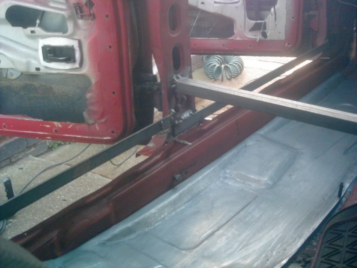

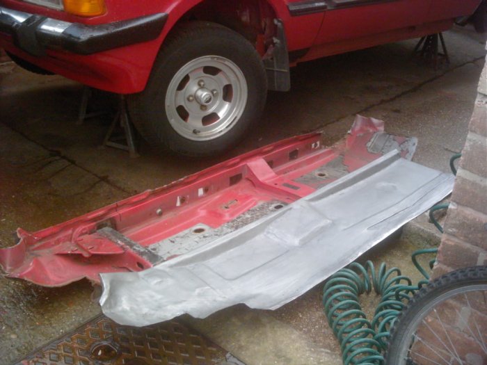

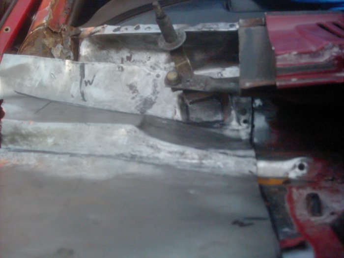

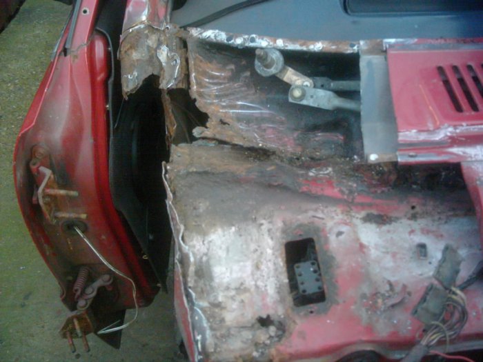

then by late last year i decided to change the n/s inner and outer sills but the floor was also a bit ragged so using a panel cut from a scrap car years ago i made a rough copy[/ATTACH][/ATTACH][/ATTACH]

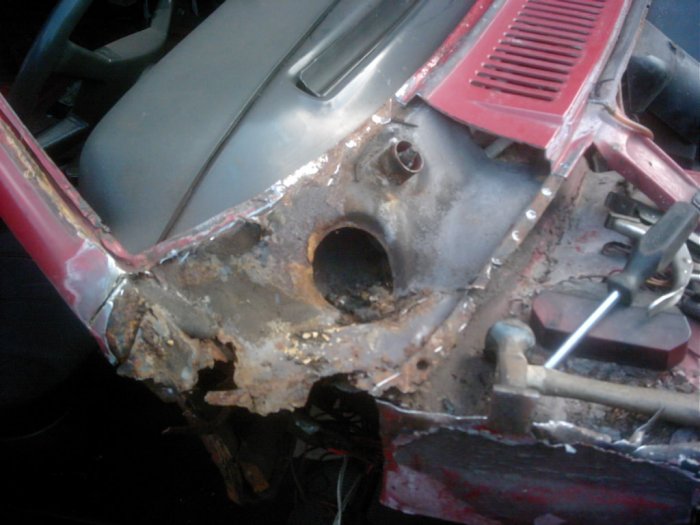

no i dont make panels for a living i'm too slow LOL! i'm a postman! it's quite easy to do if you take your time and think it through. the inner door post i made by laying a piece of polythene over it and marking all the details then punching holes through it and going over the holes with a marker pen. then just beat it out! easy
but time consuming
