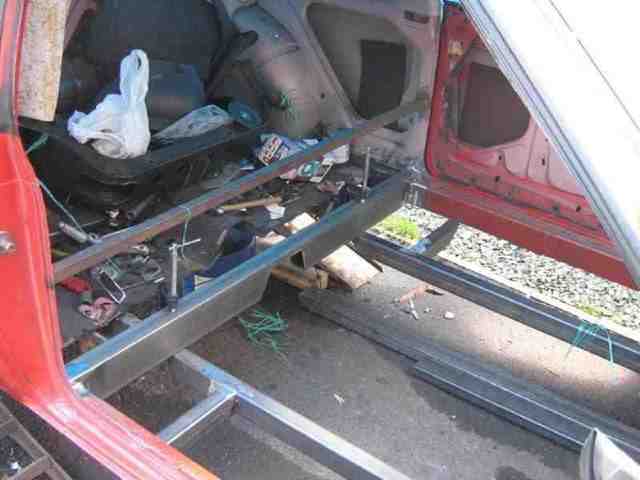

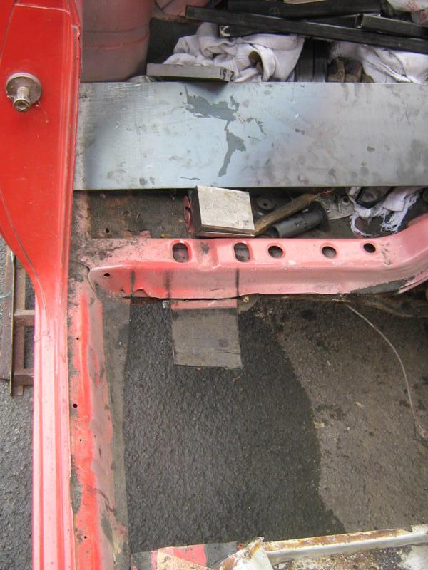

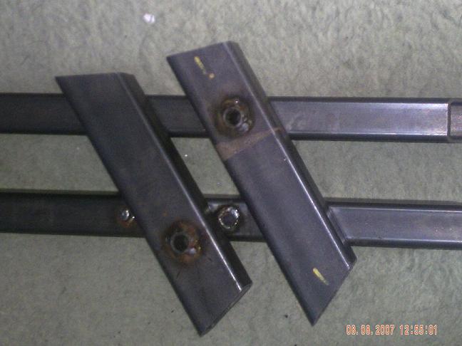

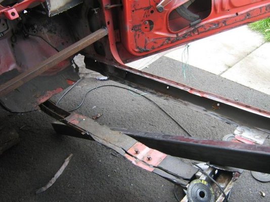

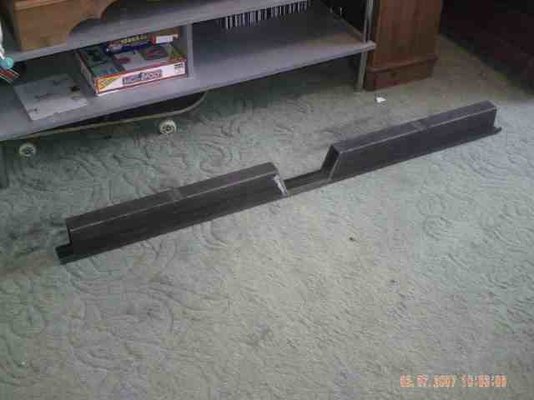

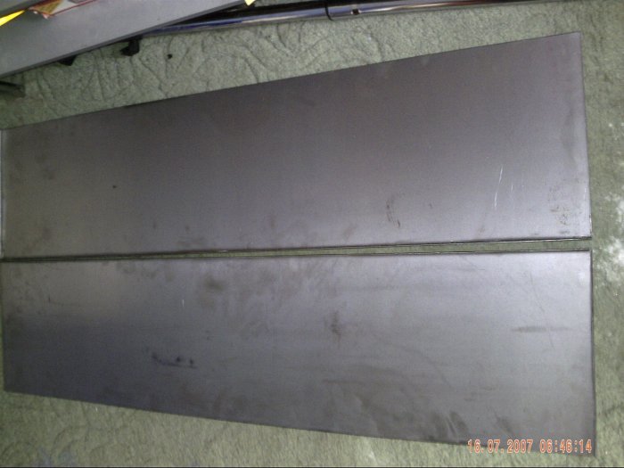

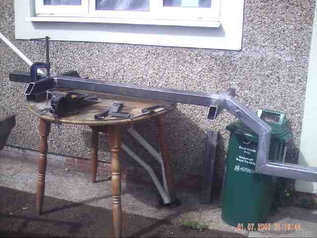

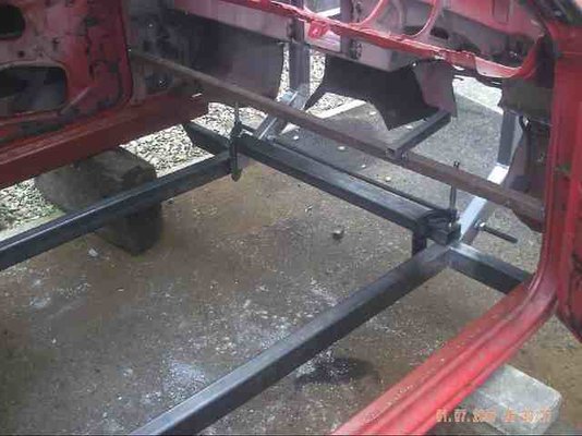

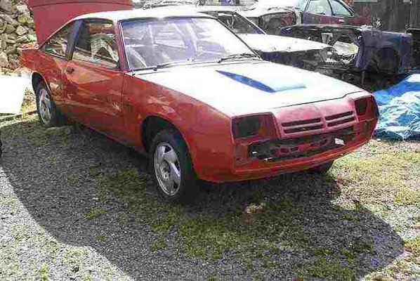

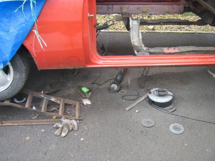

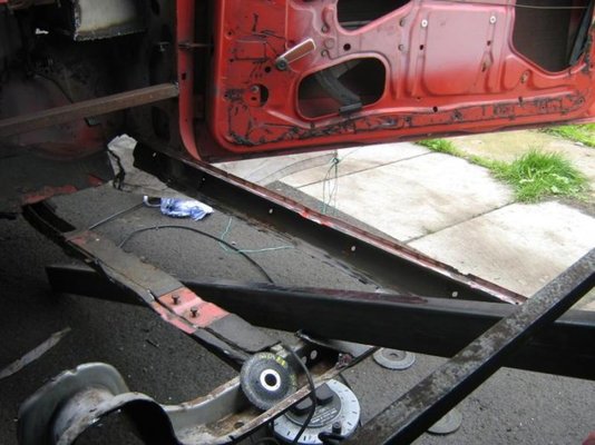

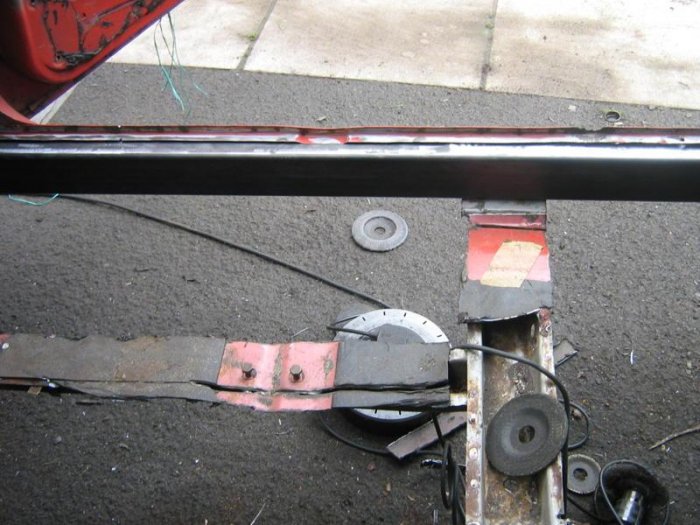

will try to keep this up to date started with a manta gte coupe non sunroof rolling shell off ebay not bad condition except for a really bad chassis rails that had been heavily plated i didnt want to patch them up as so many do so i decidedide make some out of box section steel

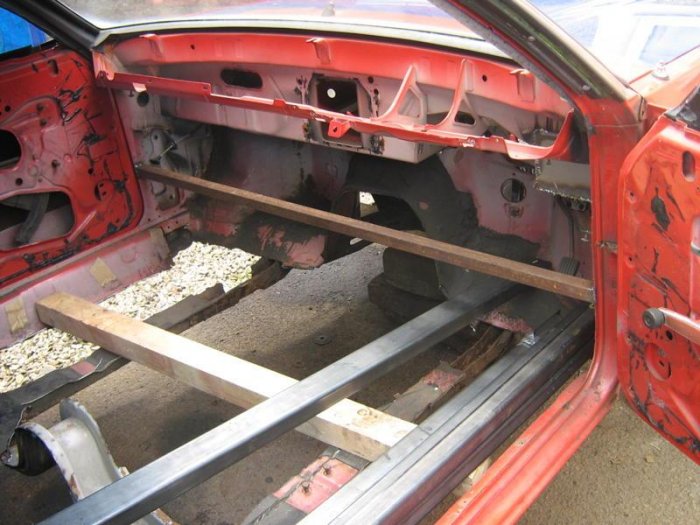

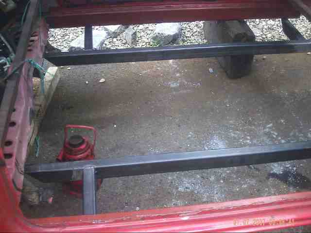

i knew this ould be easier if i cut out the complete floor bulkhead

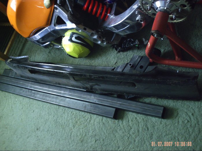

i then cut out the inner cills and replaced with box section steel
