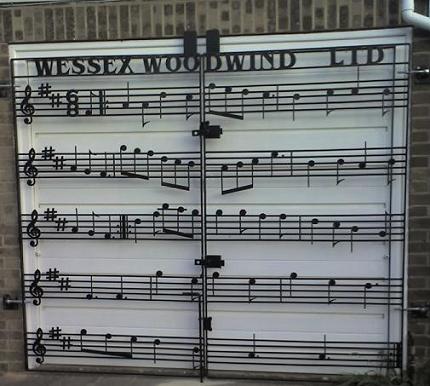

I drew up the dxf files on autocad for the basic notes and sharps and laser cut them at work, the joined notes i welded the bars onto the basic shape.
I bought some of the lettering in due to time, but had to cut the 'LTD' as it was a late addition.
The treble clefts and 6-8 i plasma cut out by hand.
