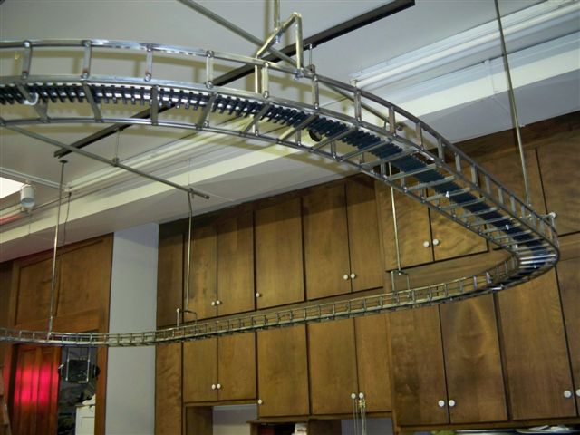

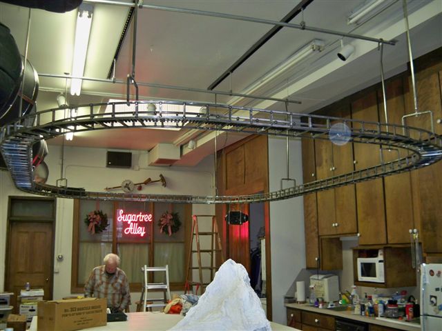

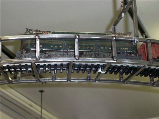

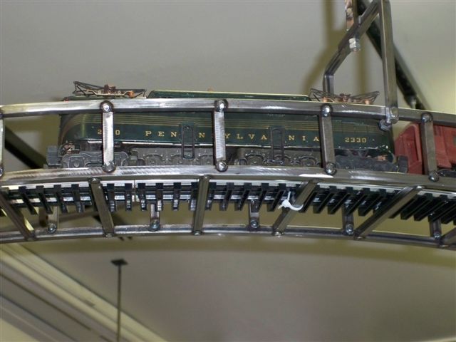

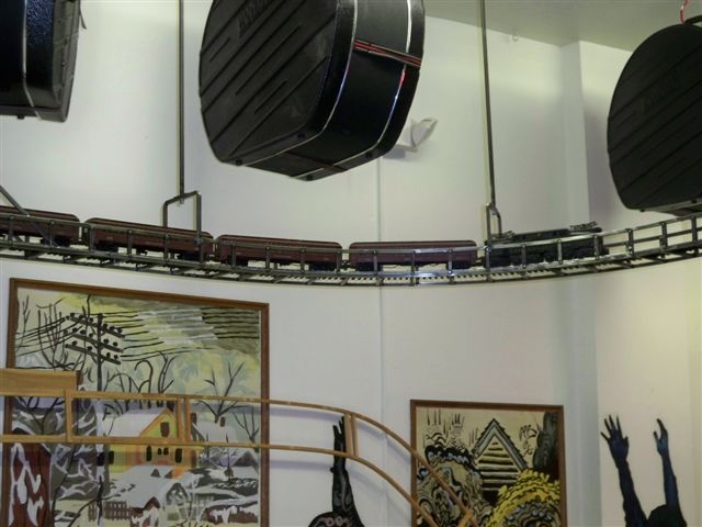

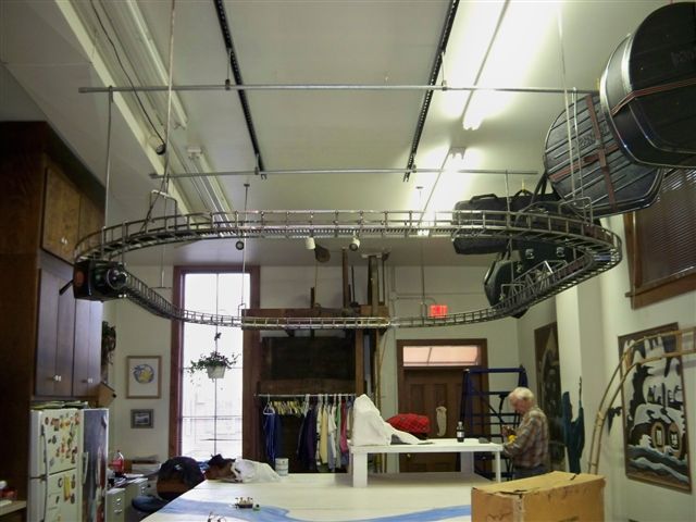

Mig welded from 3/8" sq tube cut from hundreds of parts. Rolled in a converted Tennsmith slip roll. He ordered 3 of them but i only have one up until after the first of the year. Made for the Lionel sized trains which he has a bunch of expensive ones...Bob
