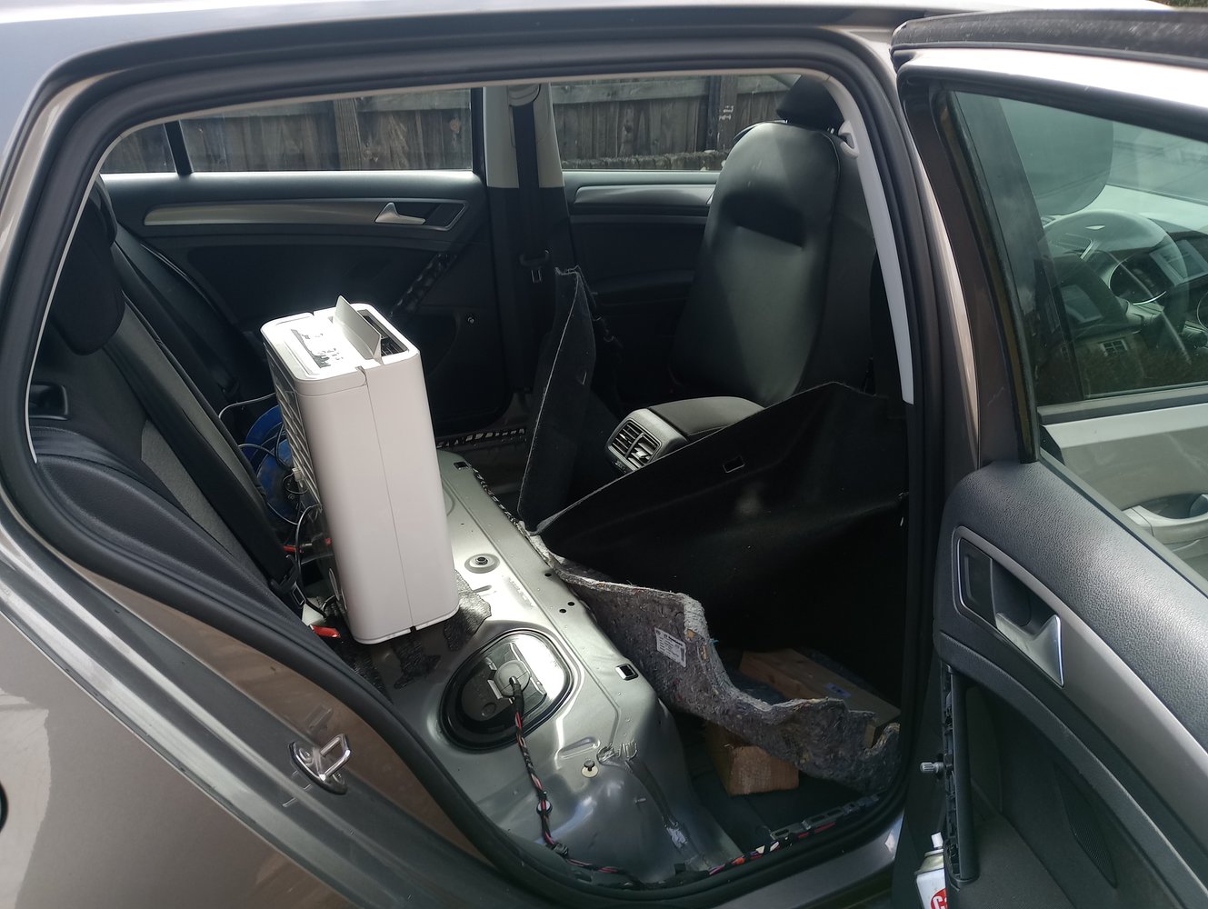

Maybe try a dehumidifier?Next, this one will be a big job, total interior strip out.

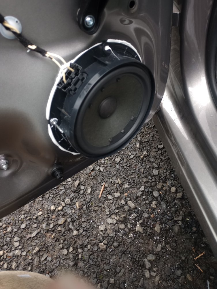

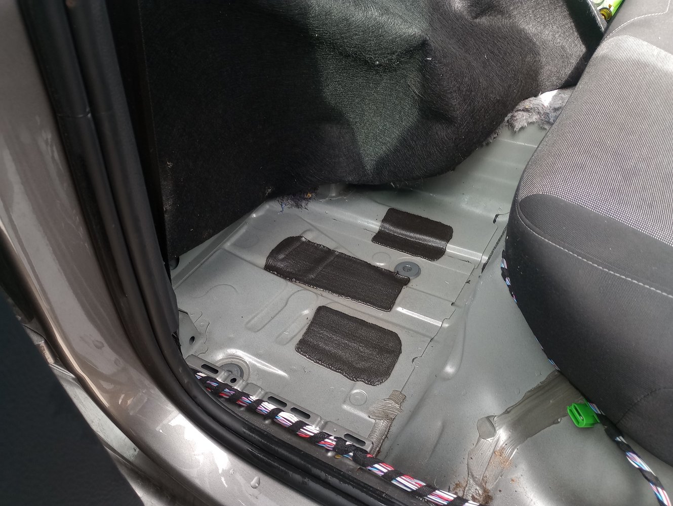

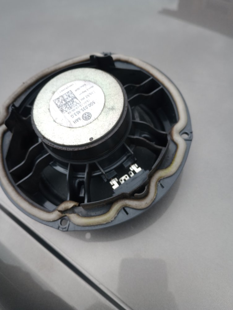

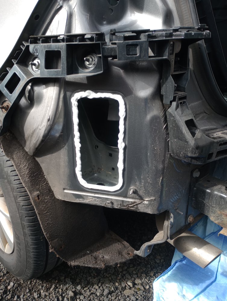

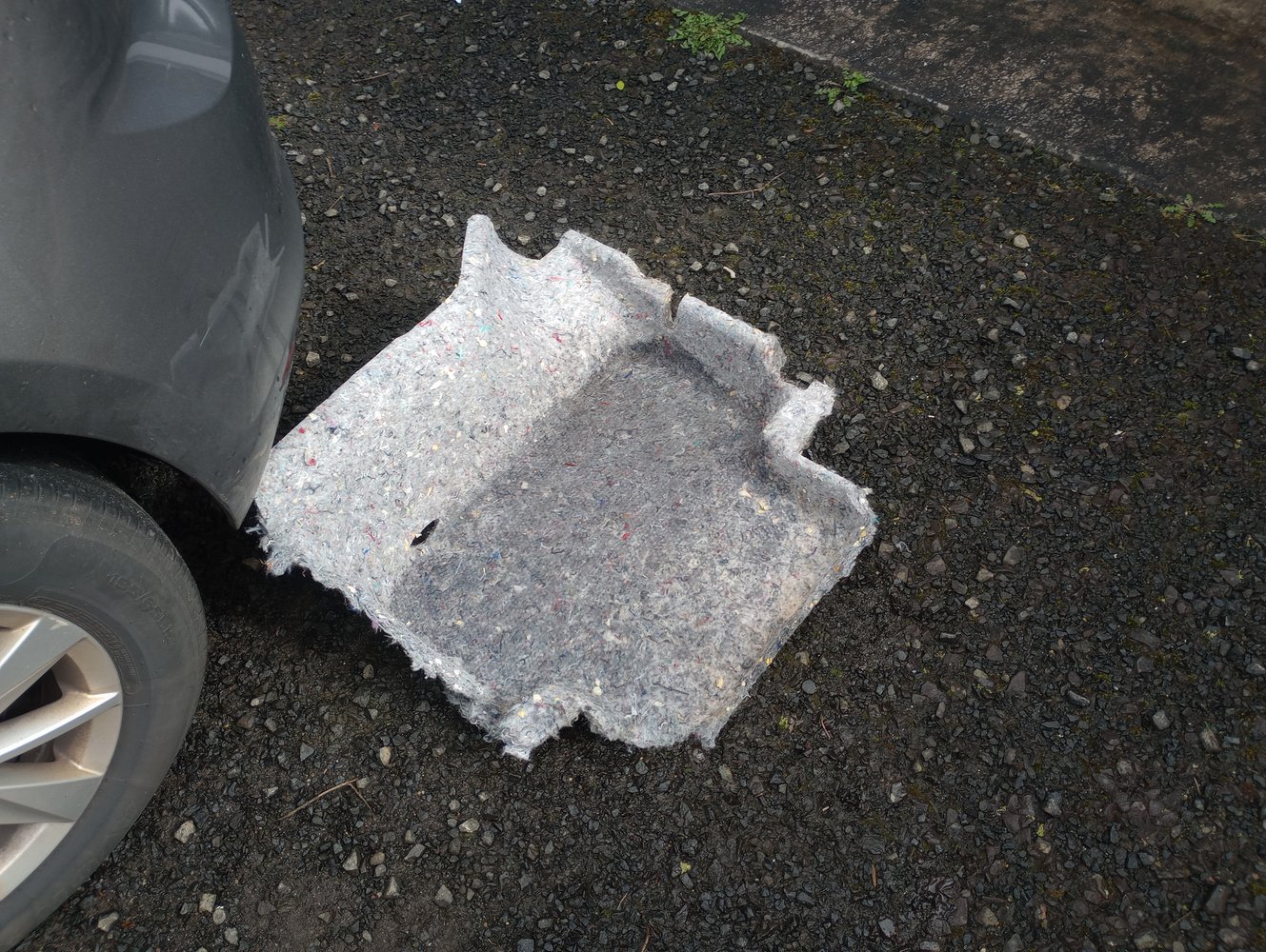

I lifted the rear carpet, underlay is soaked.

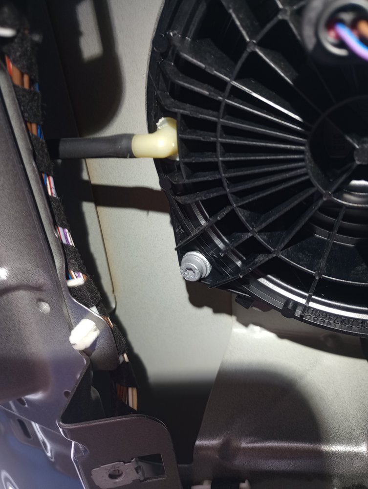

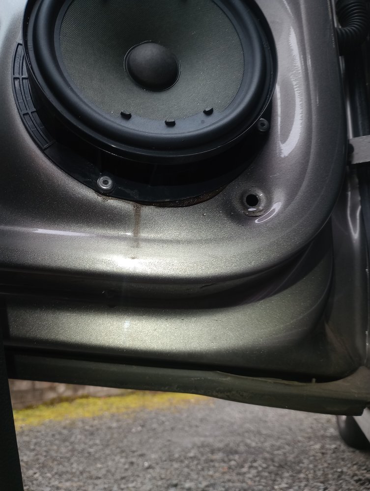

The water is getting in via the seal round the rear door speakers seal that's has disintegrated. The other side is worse.
I'll need a few dry days to tackle this one. I hope to salvage the carpet and just rip out the soaked underlay. Don't know yet if the front footwells are wet or dry.

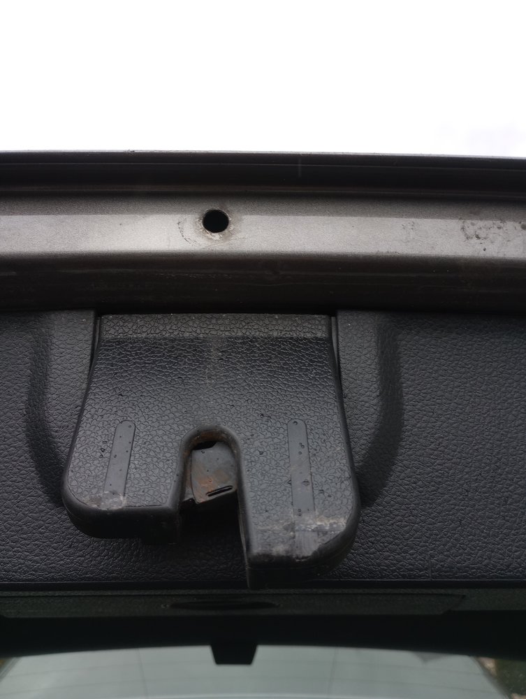

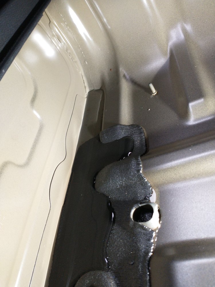

Rear light cluster gaskets leak as well on mk3's. Wifey has had two and both filled the boot when it rained. I made new gaskets from some closed cell foam and used silicon grease when I fitted them.
