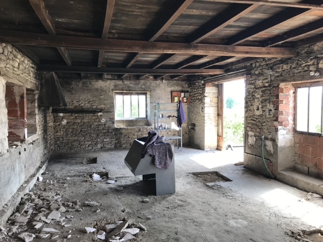

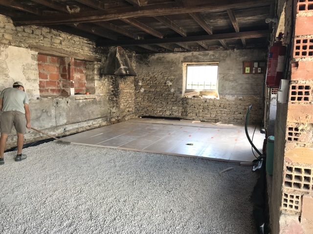

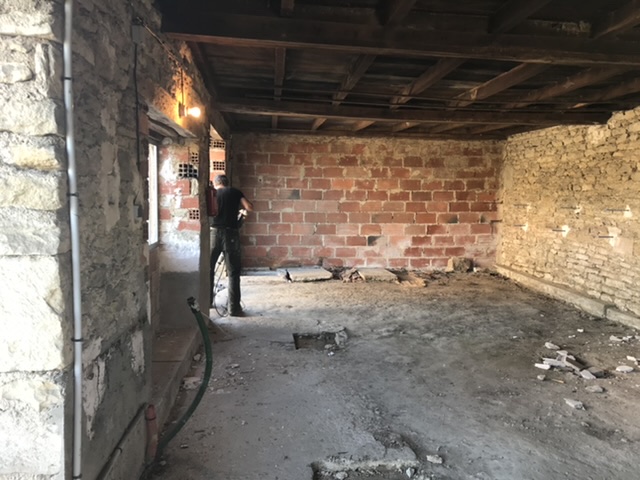

Having been here a year we’re at last getting on with refurbishing the barn. It’s in two parts, one closed off with doors and the other half open, both about 11m x 5m with earth floors in both. We have a problem in that obviously no DPC and the neighbours garden is 1m higher than our floor level.
The enclosed part will be my workshop and garage for one car and the motorbikes, half of the open part will be parking for their other car, trailer and wood store, the other half will be enclosed to make a sewing / weaving workshop for Mrs A.
