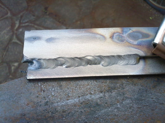

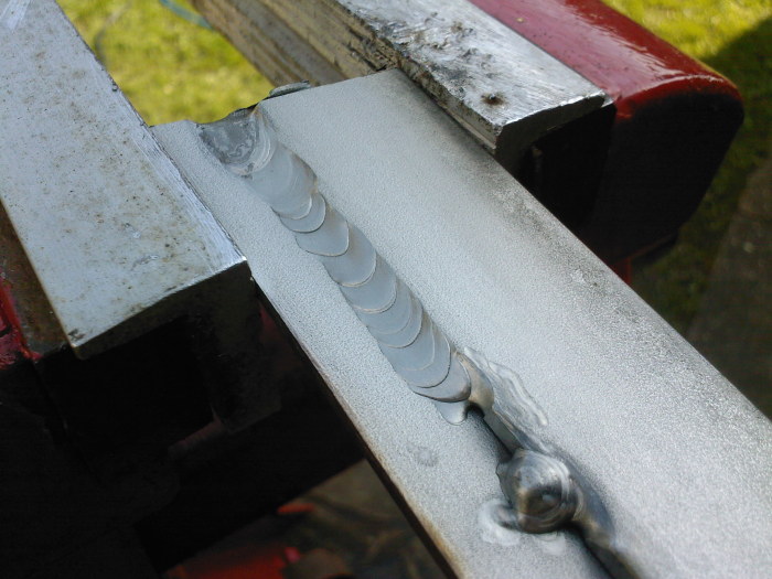

Inspired by mickjbriggs & migmags excellent welding - I fired up my new TIG for the first time today since buying it 2 weeks ago. (I've been v. patiently waiting for this day).
My first weld was that blob on the right - I wanted to see how HF works. (Still can't believe it!). The run on the left is with the correct tungsten type & settings.
Third weld.
Parent metal 3mm x 25mm FS 304L stainless.
Lap weld.
1.6mm 316LSi filler, 1.6mm tungsten, 12cfm.
I thought it was just like Oxy. (that'll all be the machine then!
) It was my first time with the TIG process. I'll get there in the end!

If other folks like to take offence they shouldn't be here. Joint was effortless. Filler came in from low angle - just not enough quantity i guess? I also couldn't remember to hold the torch over the weld at the end... etc etc,
I made so many mistakes it was comical. If any part of those welds are good it's totally down to the machine!
