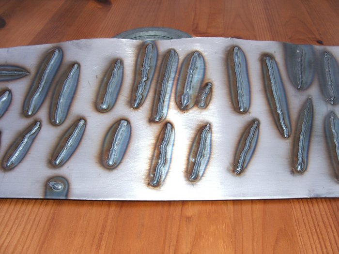

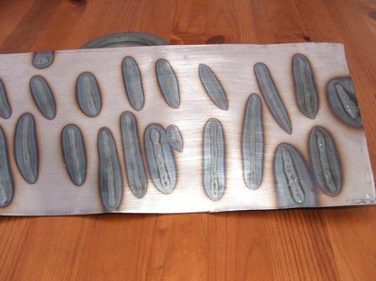

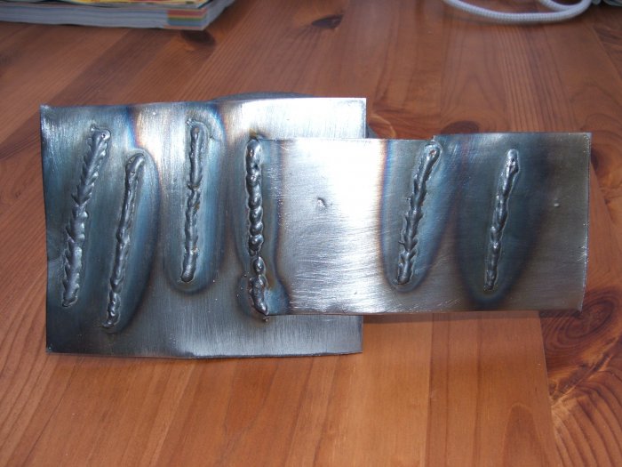

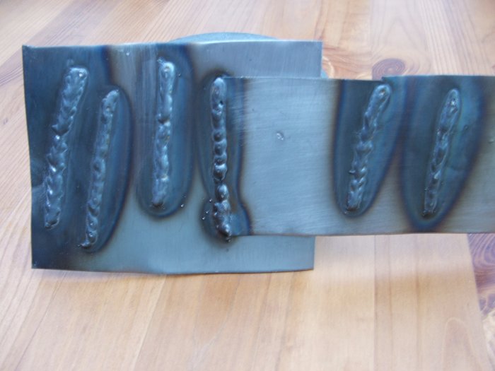

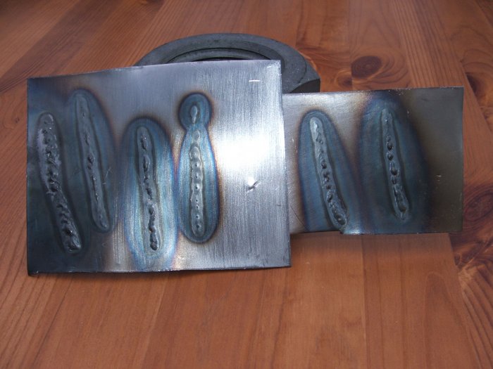

Hi chaps, Had a go on my 135te yesterday for the first time. Found it quite scary at first  , but then very enjoyable.
Steel was 1mm.
Welder was set 1 & Min, Wire speed on 6, Gas on 4.
In the first photo below i started on the left. Second is the back.
In the third, forth and fifth photos, show my attempt at a lap joint and trying the Zig-Zag. And then the back. (quite pleased with these ones).
Let us know what you think.
Dicky.

		 Good prep too...
