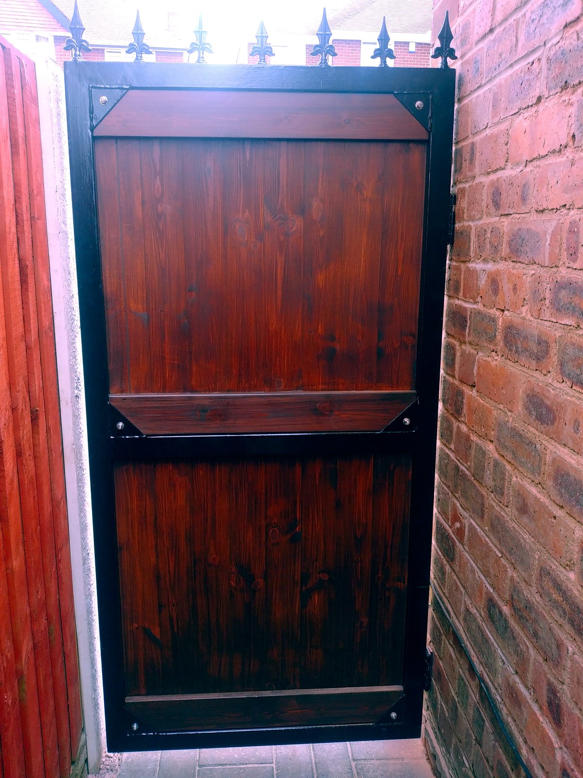

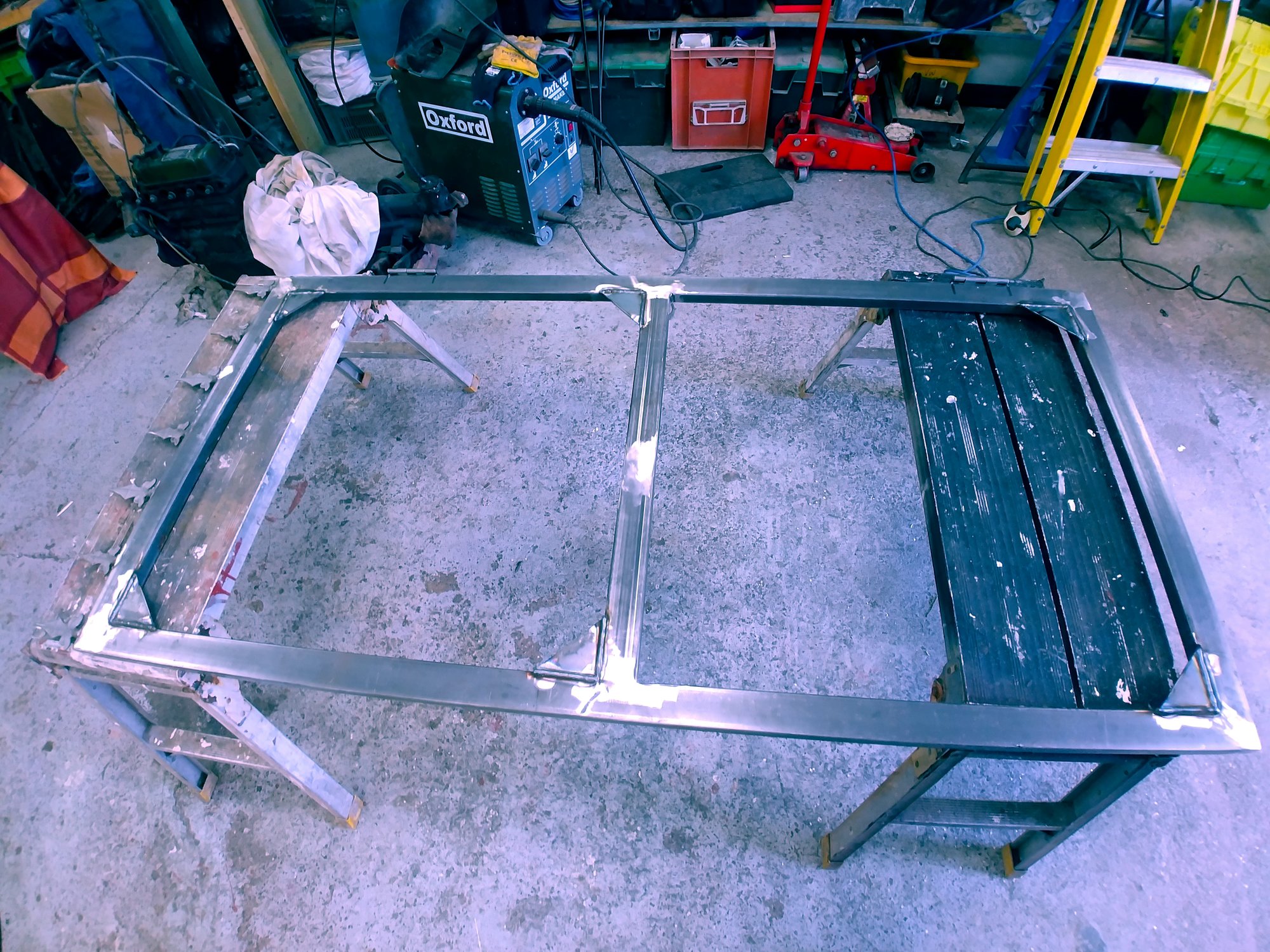

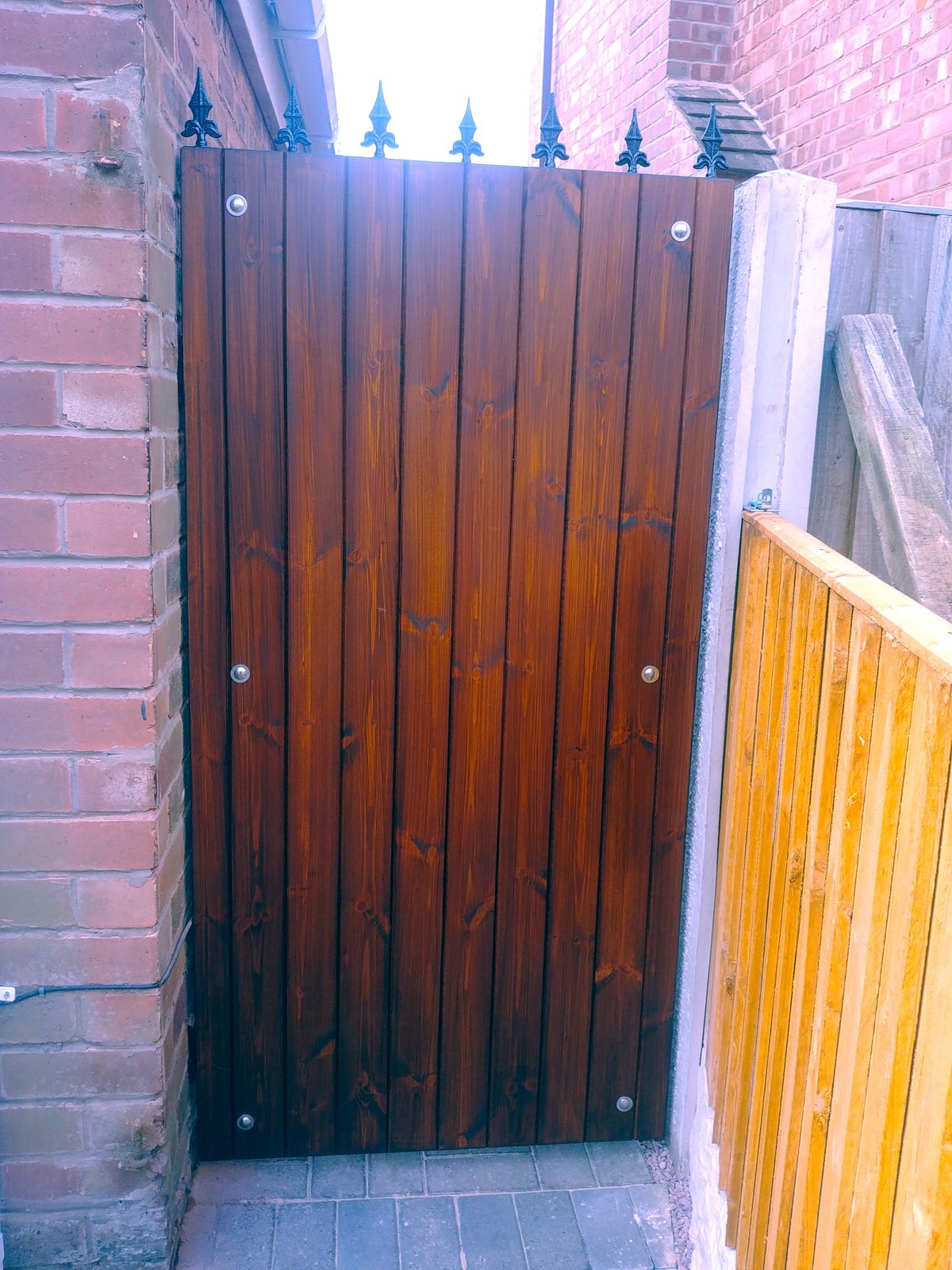

I made a gate this week from box section and timber, This is the first time i have done all the welding on anything like this, The Wood front was made separately and i added it last using PU adhesive and 6 stainless coach bolts.
