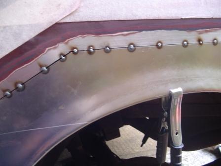

Well I've been practicing for the last few days and thought I'd better bite the bullet and do the actual repair. I haven't taken pics of every step becuase I was having too much fun welding lol
The lower section of my NS rear arch has rusted the inner and outer skin badly in one area; it was a really concentrated bit of rust becuase the rest of the car is spotless.
I cut out the rust leaving good metal to weld to then made some templates:
I then made these in 1mm steel (no pics) For the outer piece I welded 2 sections together and for the inner section I tried some metal shaping with all my panel beating tools...a hammer.
After some grinding to shape it (it still wasn't perfect but had to do) I offered it up and held it in place with a magnet:
Slowly welded a small bit at the time as the metal on the car was sooooo thin! I blew through a couple of times on the inner lip but luckily the outer face went pretty well. I added more welds to this and then ground it down but this is the only pic I have:

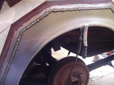

Did the outer piece in the same way:
For my first attempt I'm chuffed
I know some bits could be better but ya live and learn.
