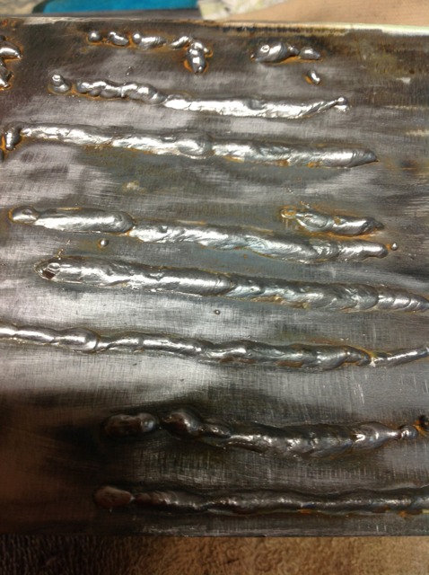

Gareth think you will need to give the guys and gals a bit more info as that could be a mountain range or a microscopic view! They will need

ps don't look to bad But I could be the other side of room

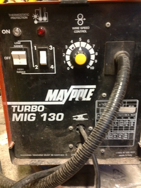

Right lads/lasses,the welder used was a maypole 130 turbo with pub gas,wire 8mm ,metal was 1.5 mm thick
This is how it was set when I had a go hope this helps

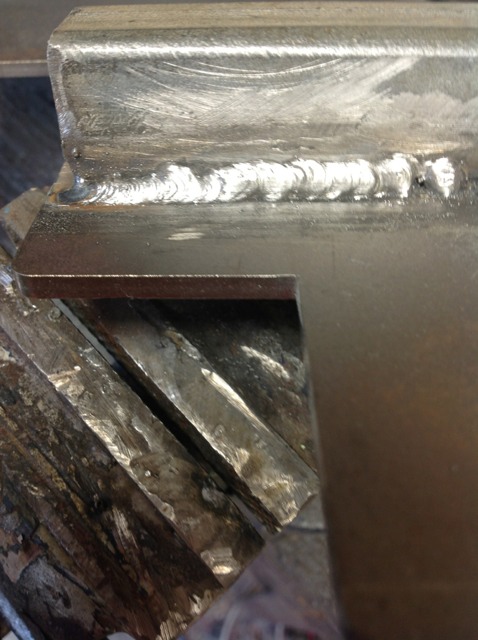

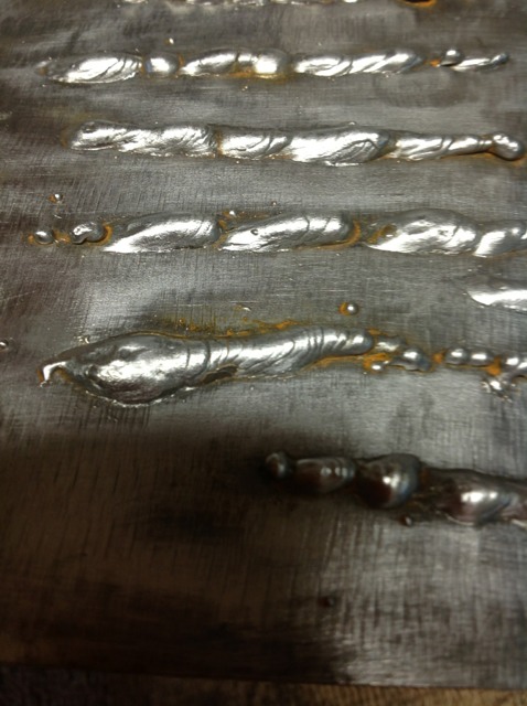

If you look at the underside of the welds you should see some distortion where the penetration is coming through, this will be the correct power + wire feed + travel. You are only one notch down form top power so should be at the point of blow through on 1.5 mm steel (are you sure it's 1.5?)
If you look at this chaps pics 2 and 4 http://www.mig-welding.co.uk/forum/showthread.php?t=42271
you can see the penetration and some blow through. The difference between penetration and blow through on thin metal is a matter of a few mili seconds of not moving the torch quick enough (blow through) and moving to quick (lack of penetration) hence the "thin metal technique" See tutorial at top of page if you intend to weld car body panels
