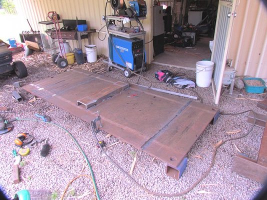

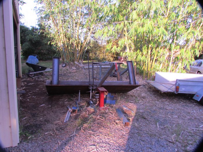

Well I got my 3mt x 1.2mt x 25mm plate for free from a friends neighbour so here is how I built my new welding table and moved it, it was badly bent in a couple of corners so they had to be straightened first
Pic 1.

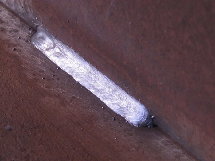

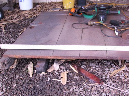

Grooves cut about 8-10mm deep into the plate and 4-6mm wide, to be filled with a very hot weld to try to pull up the plate into being straight as the weld pool cooled, all 4 corners had bends in them, 25mm, 8mm, 10mm and 2mm out of flat, although it might not look it, that corner in this pic was bent about 25mm out, the straight edge was resting on a power cord at the other end but I didn’t notice it till after I finished taking the pics, trickiest part was working out where to put those grooves and I think I got lucky as it didn’t come out too bad.
Pic 2.

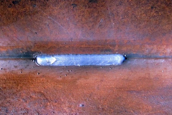

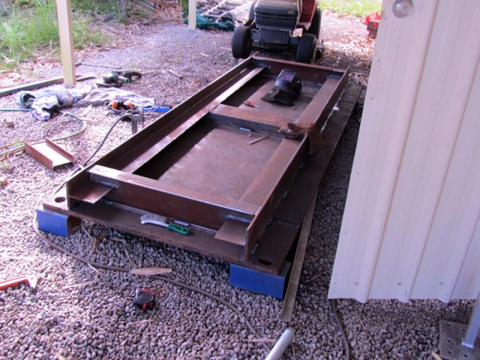

The grooves are welded and plate straightened as best I could and a piece of 200mm x 75mm channel welded to the top center. This was welded to provide a support for the 2 long T pieces of steel made from cutting a universal beam (30cm x 16.5cm) in half. This gave me a vertical wall of 165mm x 12mm thick plate
Pic 3.

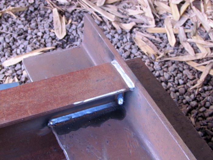

As I cut the Universal I beam the internal stresses from when the I beam was formed, released and the 2 halves curved slightly outward. So I welded the two halves to the channel and the plate, and then used strong clamps to force the ends in till they mated with the smaller I beams on the ends, also clamped the ends down to the plate as well.
Some of my welds weren’t the best as the plate was very badly pitted and the pits full of crap, I didn’t want to spend a week grinding it all out, so just ground out what I could within reason and then blasted out the crap with the arc.

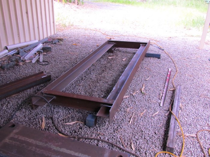

Pic 4.

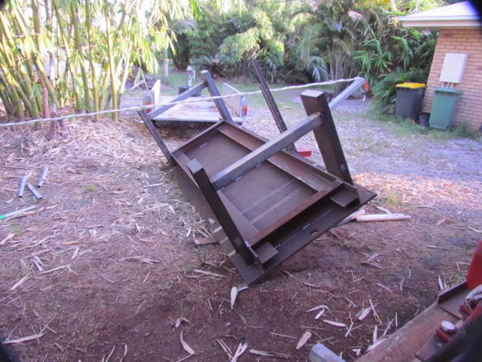

The I beam cut in half and two smaller pieces slotted to fit together to try out before fitting and welding to the plate.
The frame support T beam and I beam welded together.

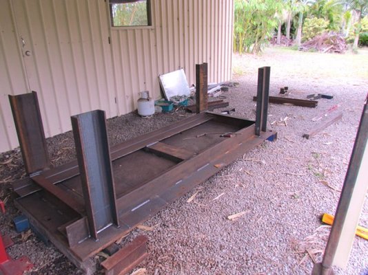

Pic 5.

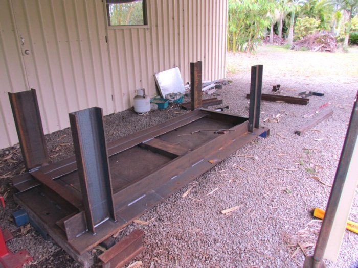

Support frame fully welded
Pic 1.
Pic 2.

Pic 4.
