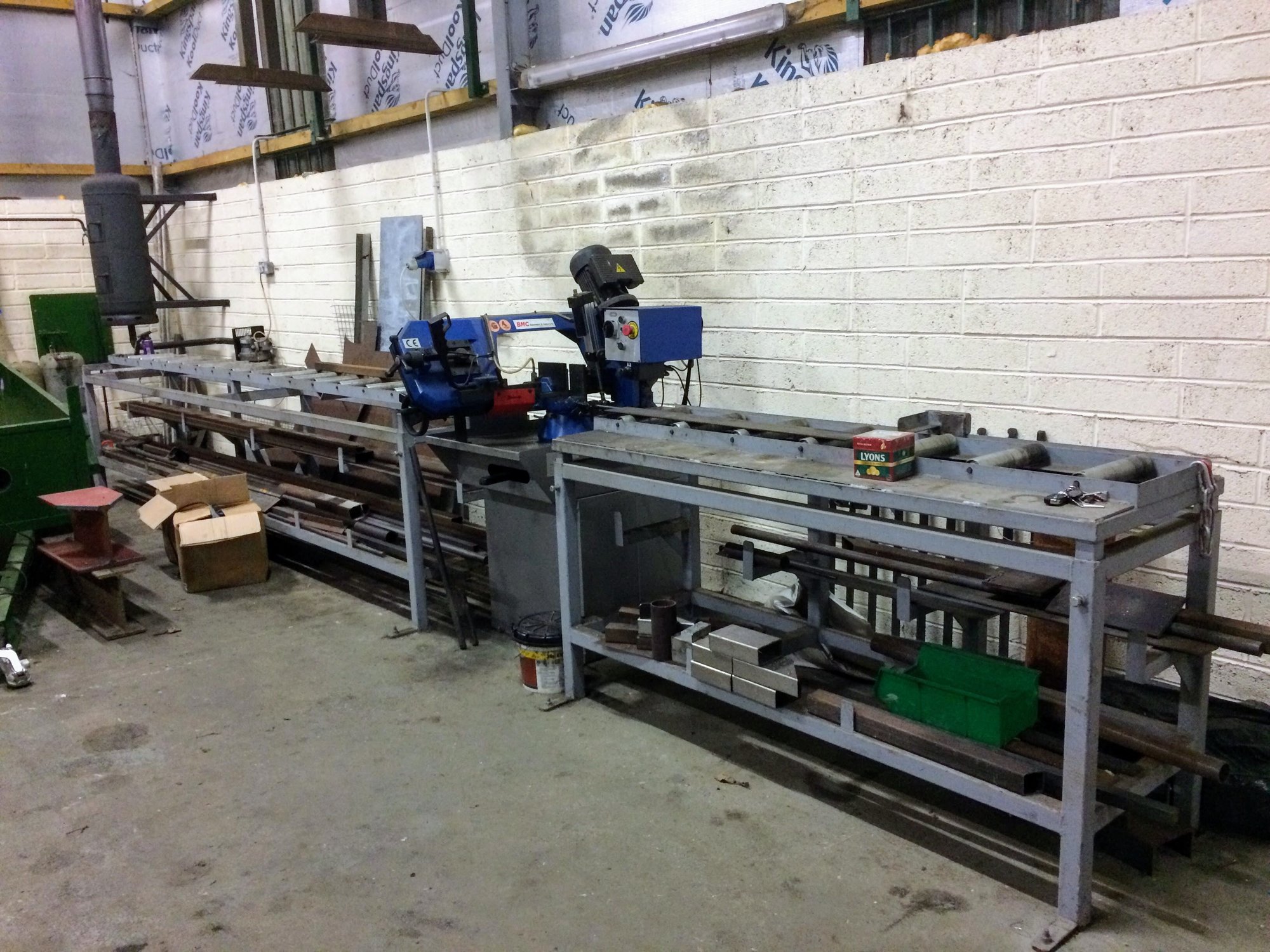

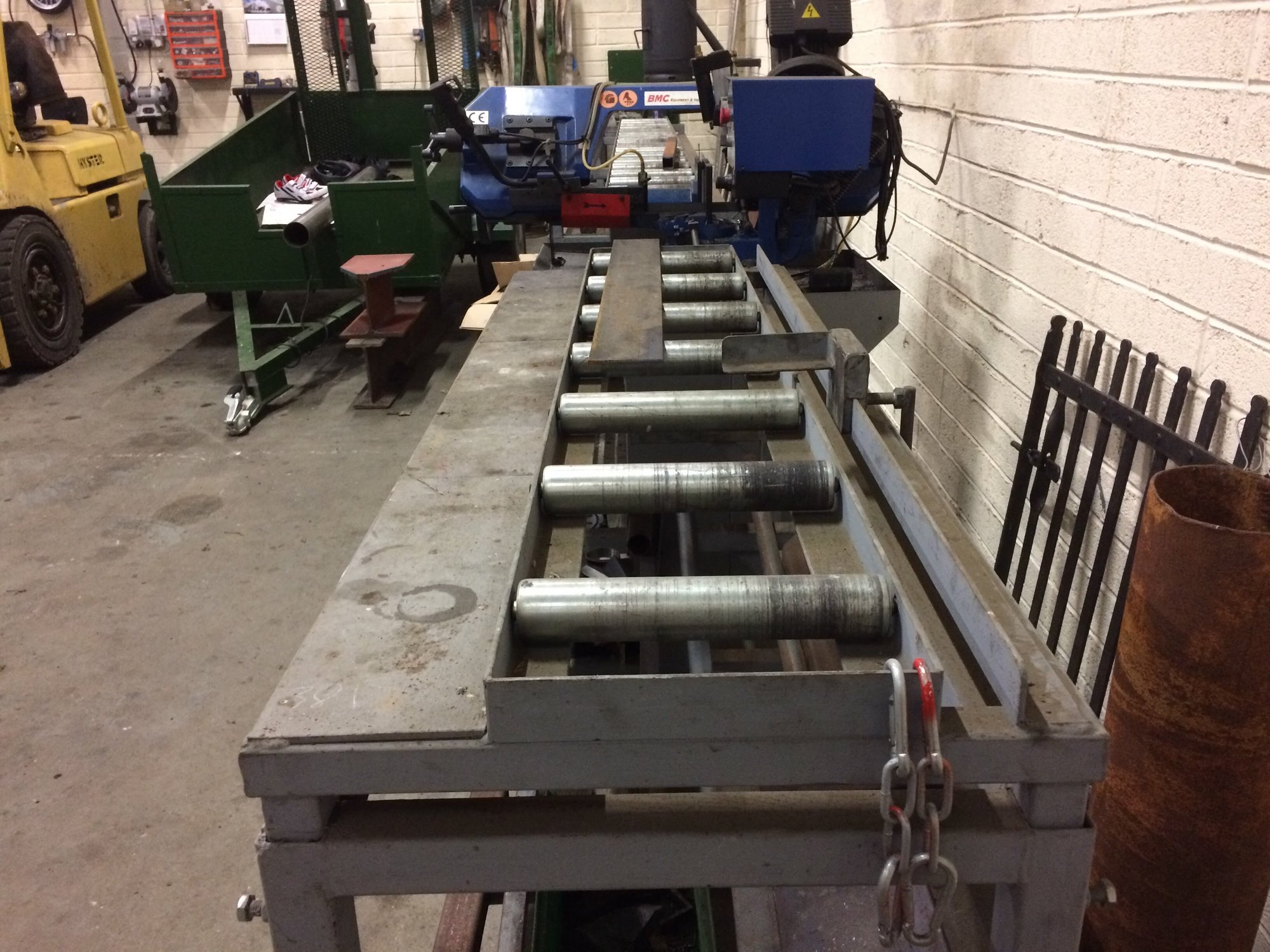

They are 50x50rsa frames holding the rollers in every 200mm and that frame is mounted to 40x40 box which slieves into 50x50 box section bottom frame that acts as a storage rack and allows the top frame with the rollers to be 100% leveled.

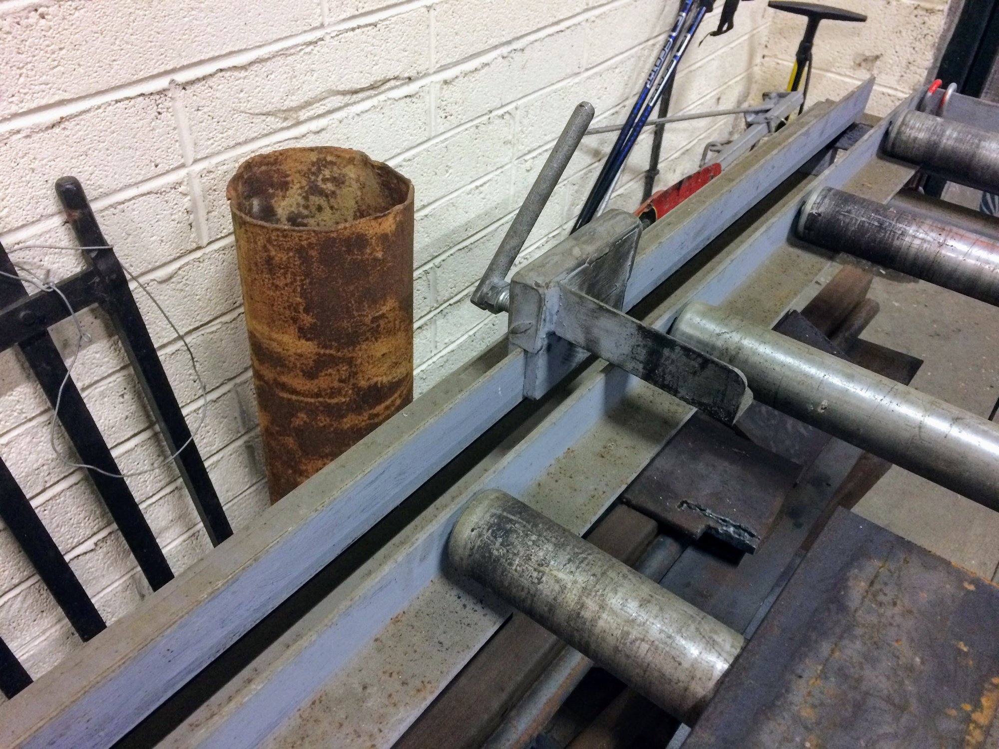

The cherry on top is my back stop it’s slides along on a 50x50 angle on its edge and is fully adjustable for repeated cuts out to 2200mm from memory!
I’m proud of it but happy to share and answer any questions!
