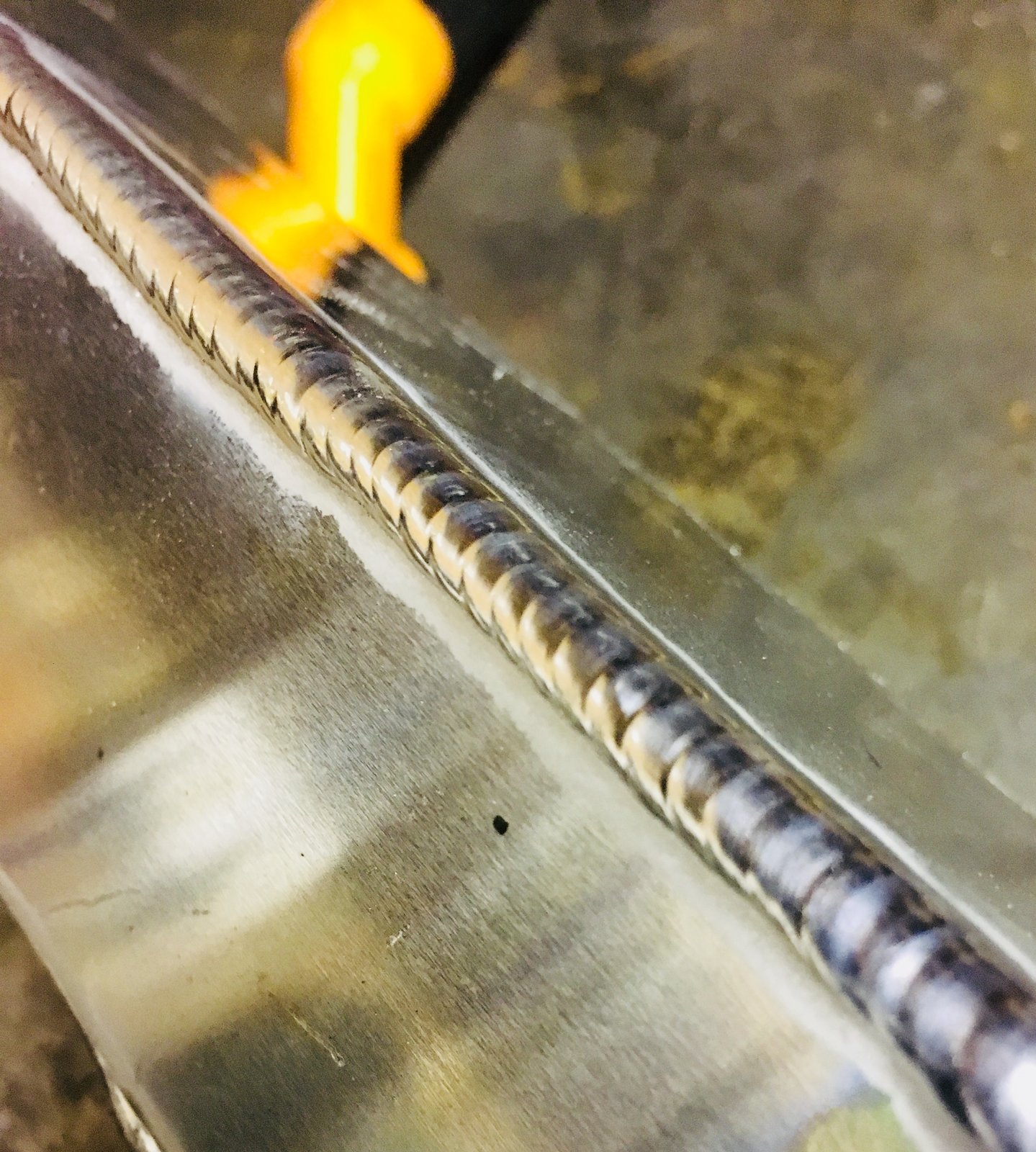

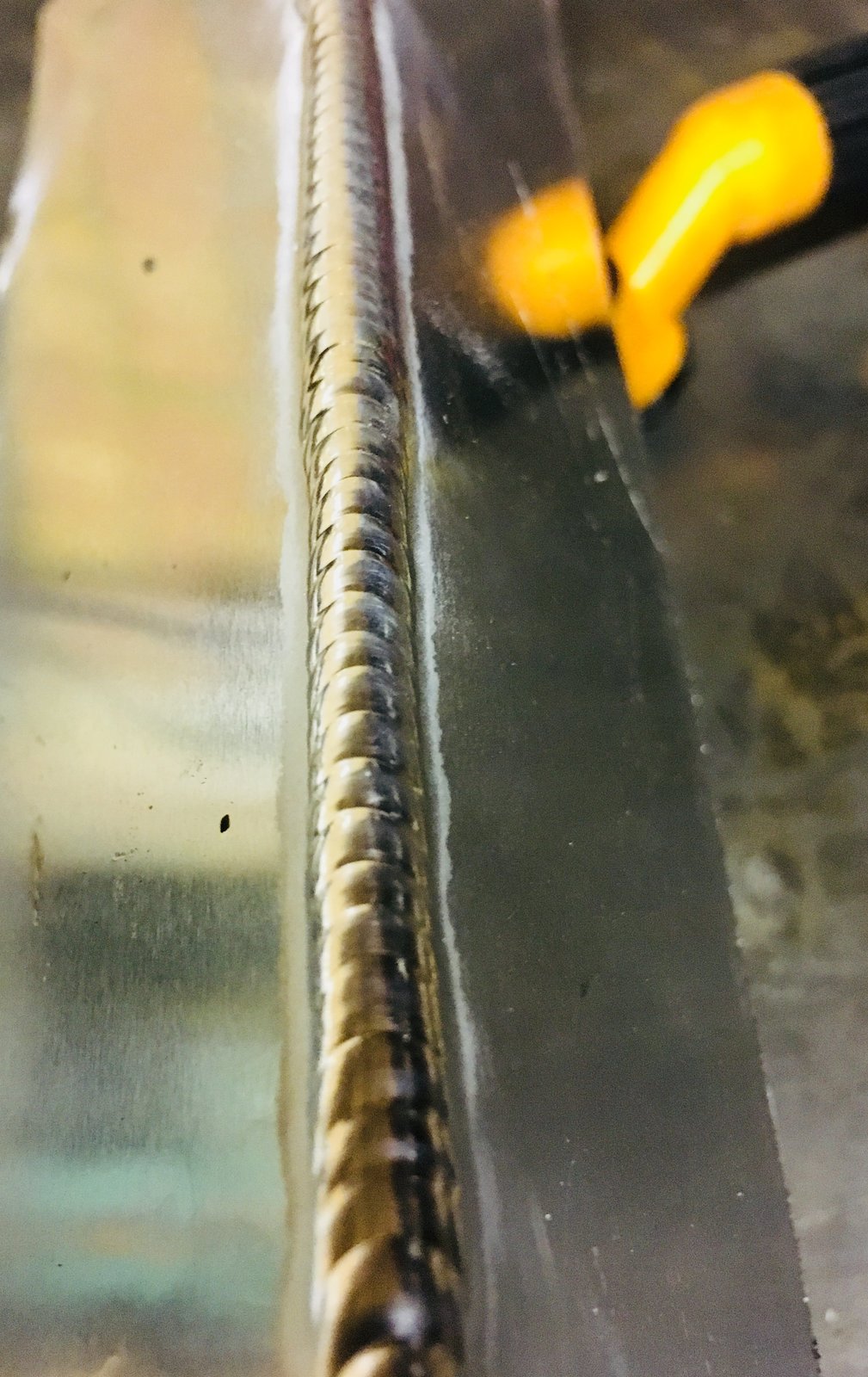

D D5meister Member Messages 91 Location uk cambs May 2, 2018 #41 did this corner weld on a battered ally test peice Its all on the amps here! IMG_5237.JPG 469.6 KB · Views: 63

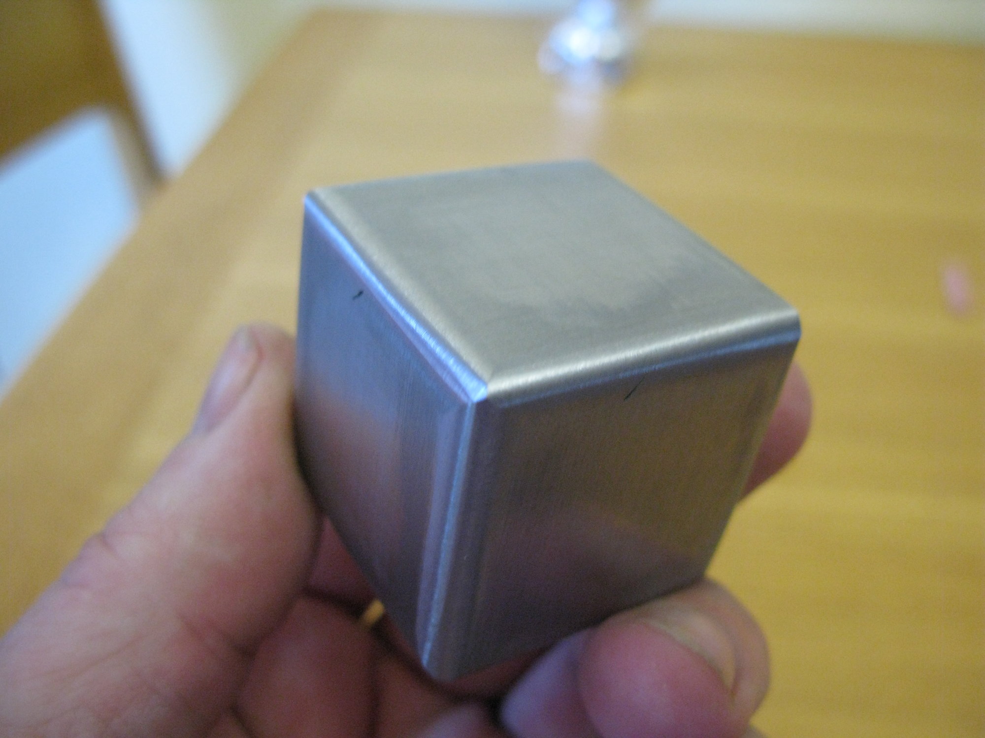

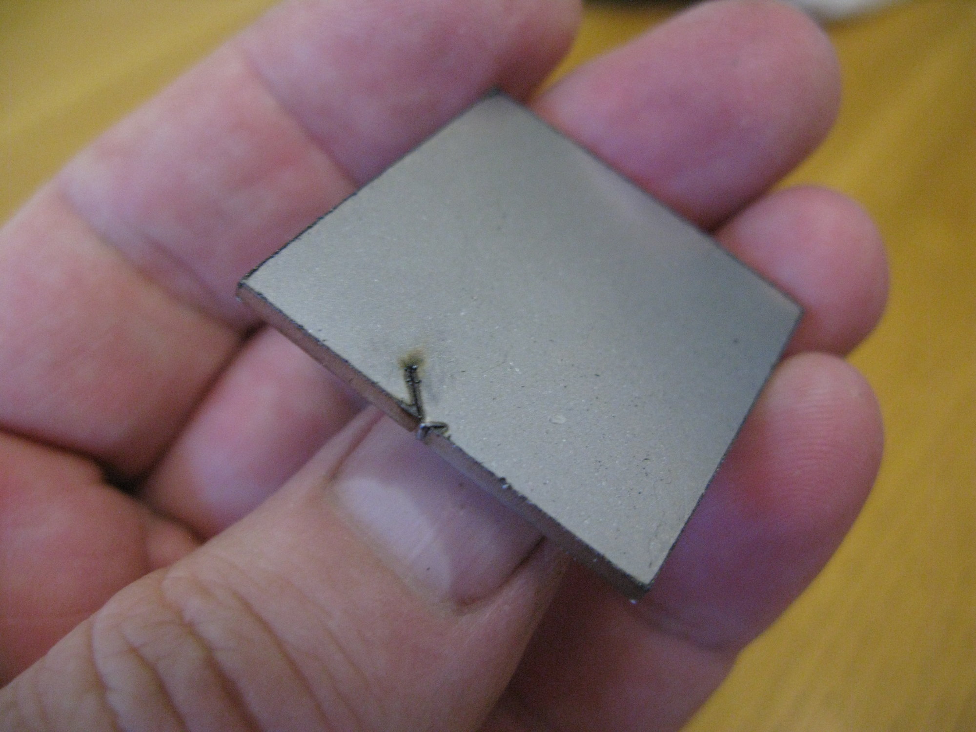

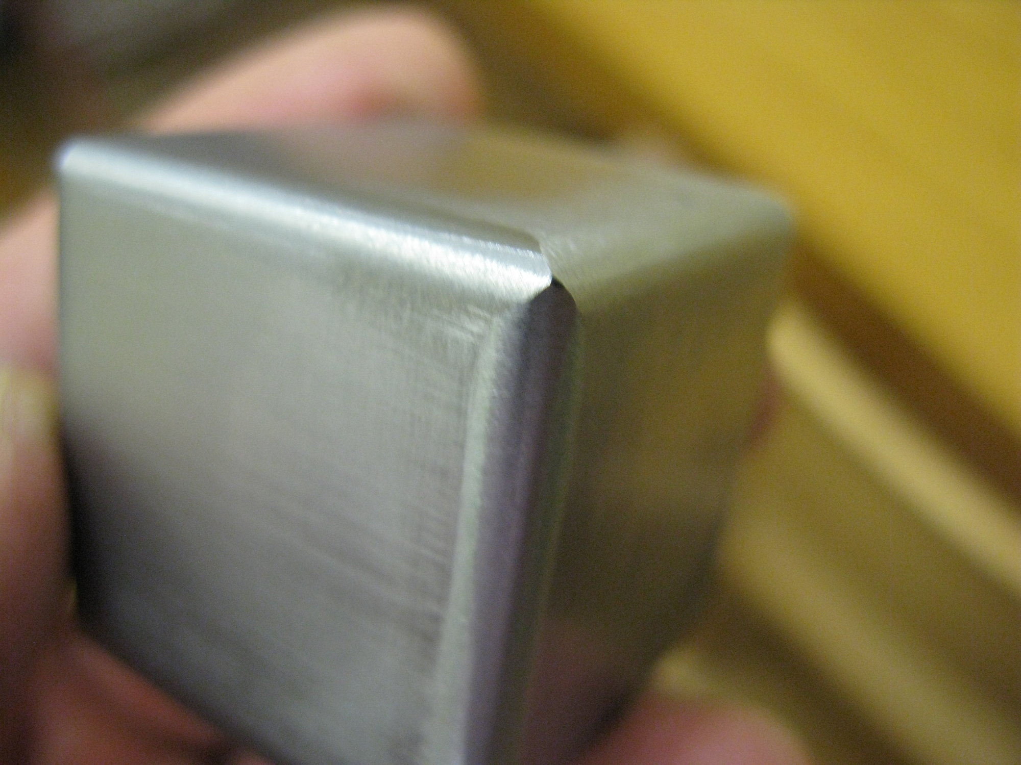

D D5meister Member Messages 91 Location uk cambs May 2, 2018 #42 I was given some laser cut squares, like this, in mild, Zipped up a cube, hit it with the belt sander ! IMG_5233.JPG 363.4 KB · Views: 51 IMG_5234.JPG 306.3 KB · Views: 64 IMG_5236.JPG 344.6 KB · Views: 53
Richard. Member Messages 18,335 Location Cambridgeshire May 2, 2018 #43 Give yourself a sporting chance and try to weld on clean material. The alu joint is very matted and speckled with contamination. Shame because the general shape and size of the run is pretty good. When things are clean it makes all the difference 2E463B4F-A0CF-4B51-B35C-68197C1C8F70.jpeg 414.6 KB · Views: 58 92FE0555-7C63-48CB-9229-07DCA046F1C1.jpeg 259.7 KB · Views: 49
