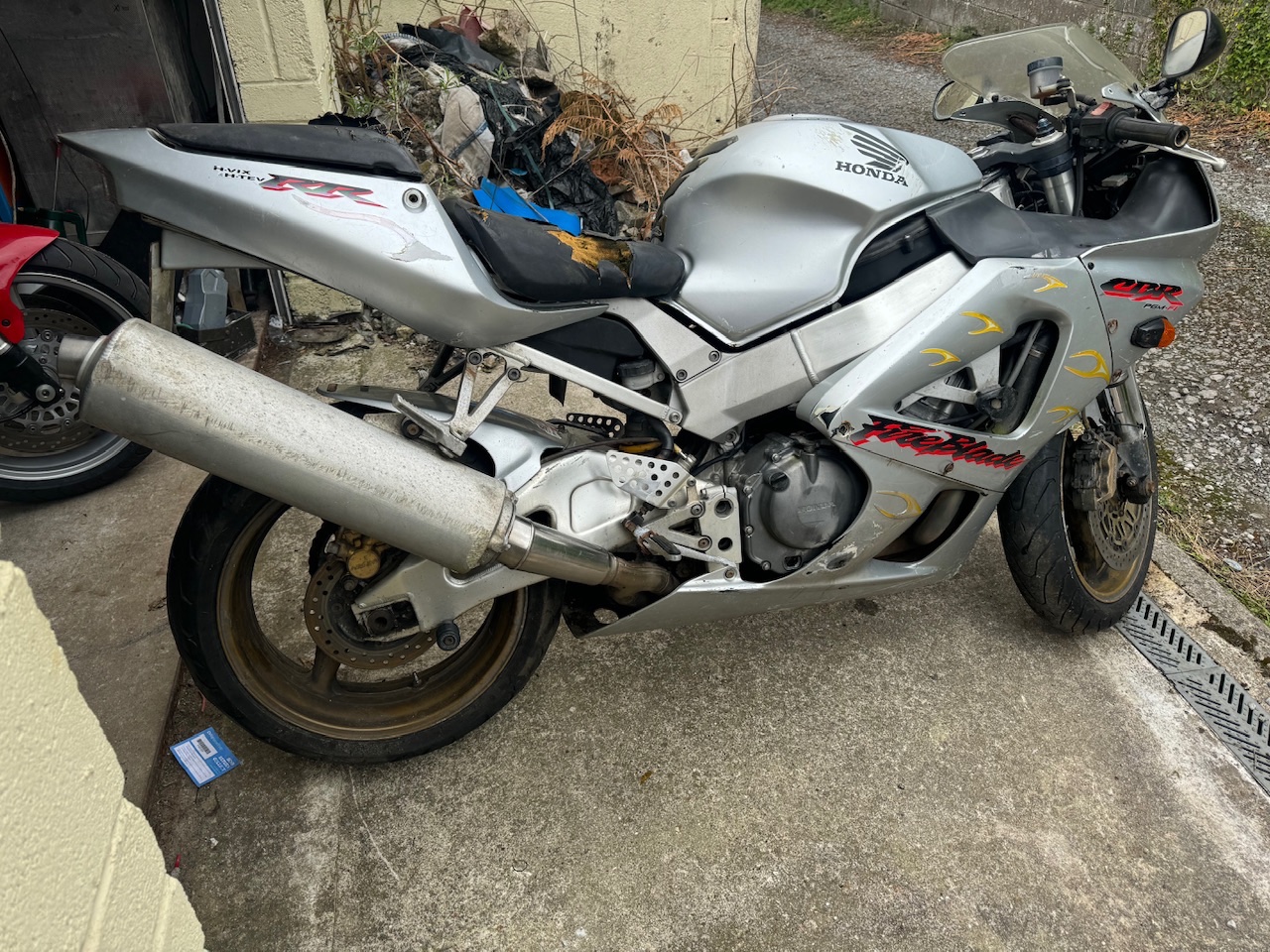

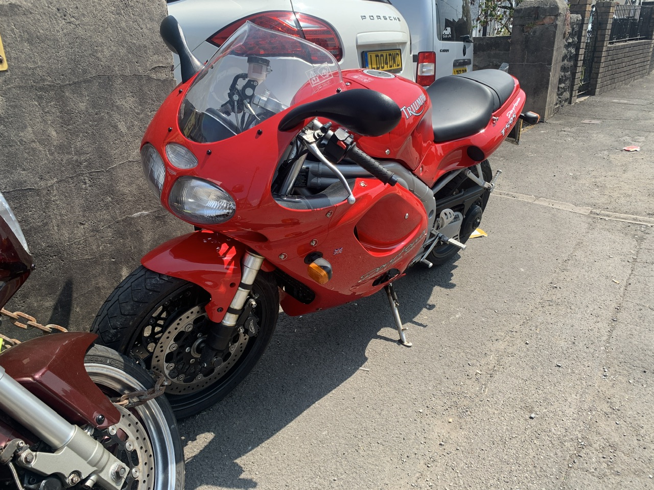

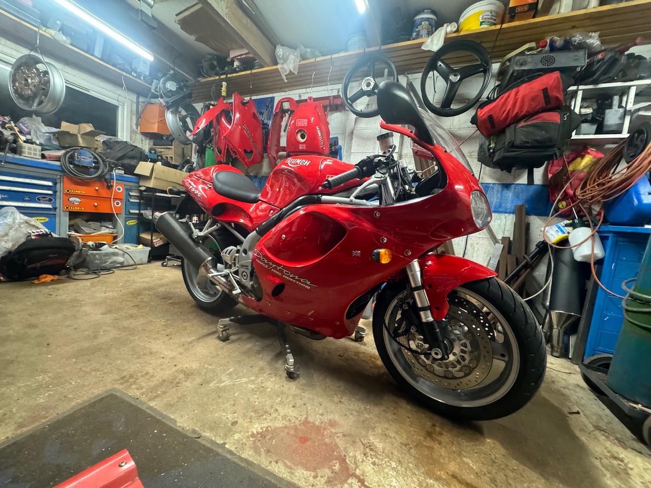

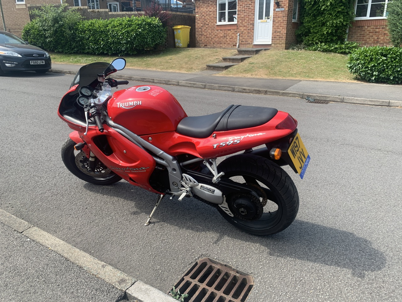

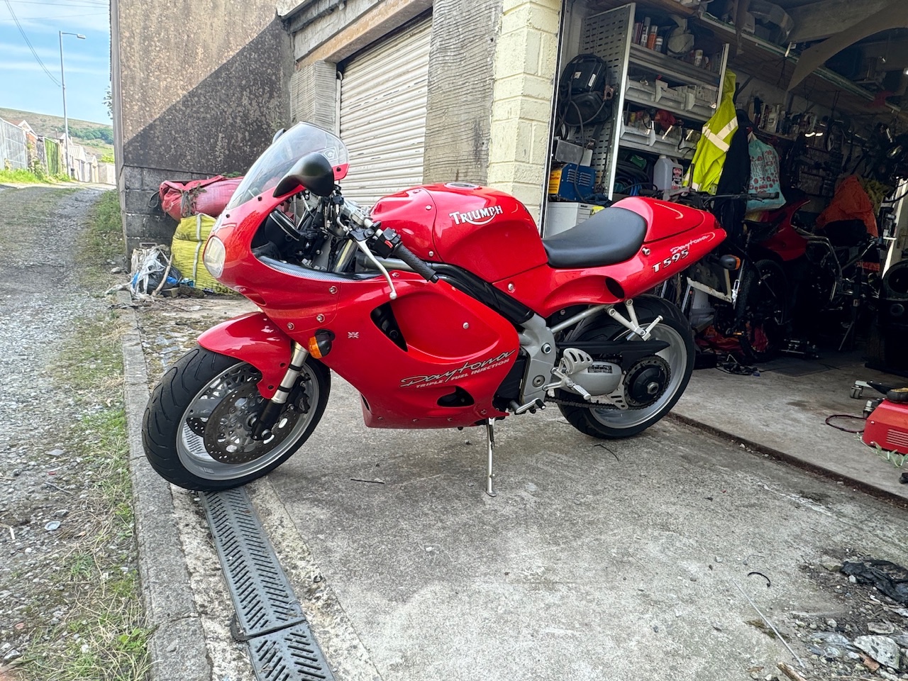

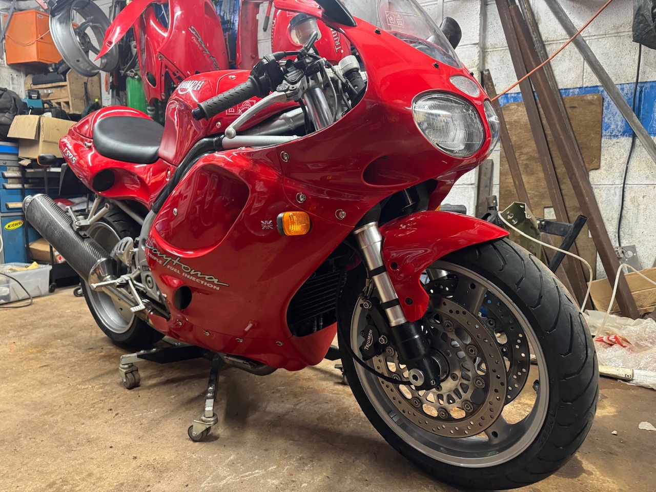

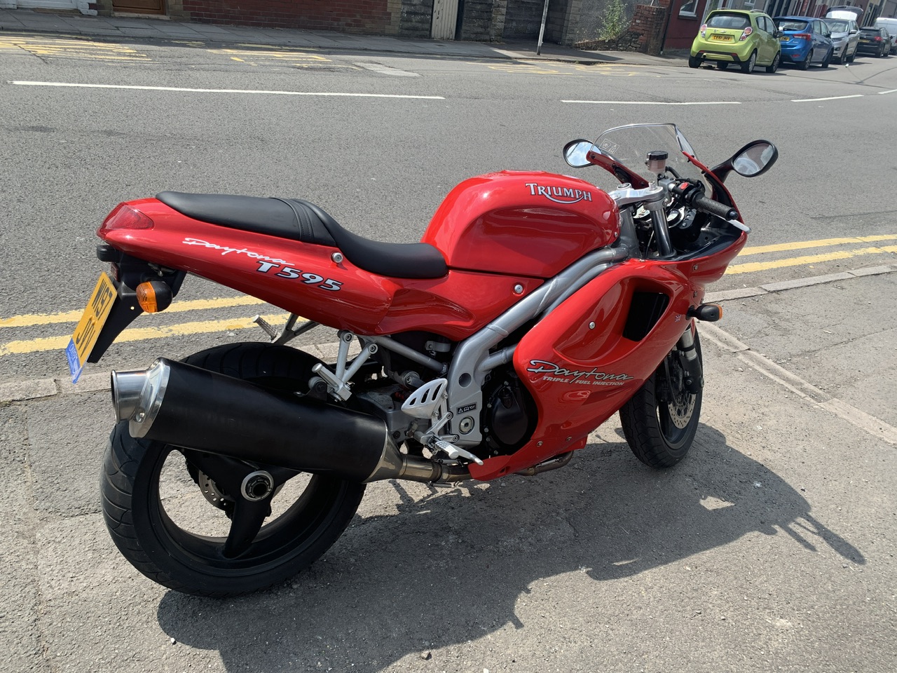

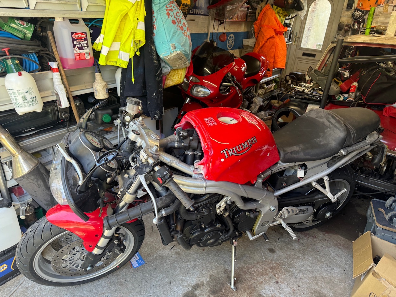

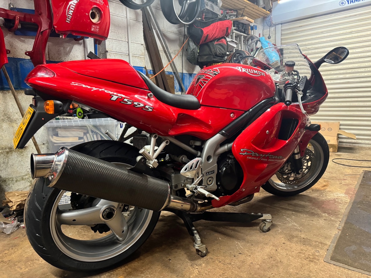

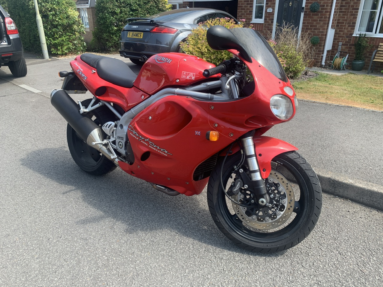

Well, I did post the procurement of this in my old thread which morphed into the other T595 rebuild thread so I decided after pretty much completing this one this week that I’d document it.

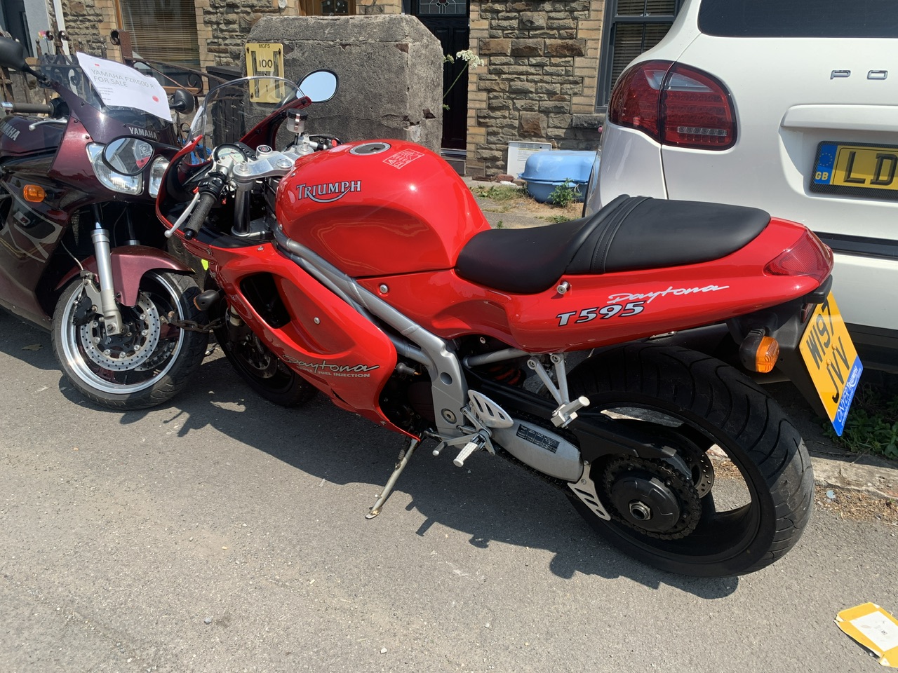

Basically I chased my mate for a lot of years to buy this beautiful thing which he bought new in 2000 for almost £11k which then languished in a damp garage after he lost his license for DD back in 2011. He finally relented after spotting a KTM that he fancied after getting his license back, for a little over £3k. The pics below were taken in 2023 the day it was collected.

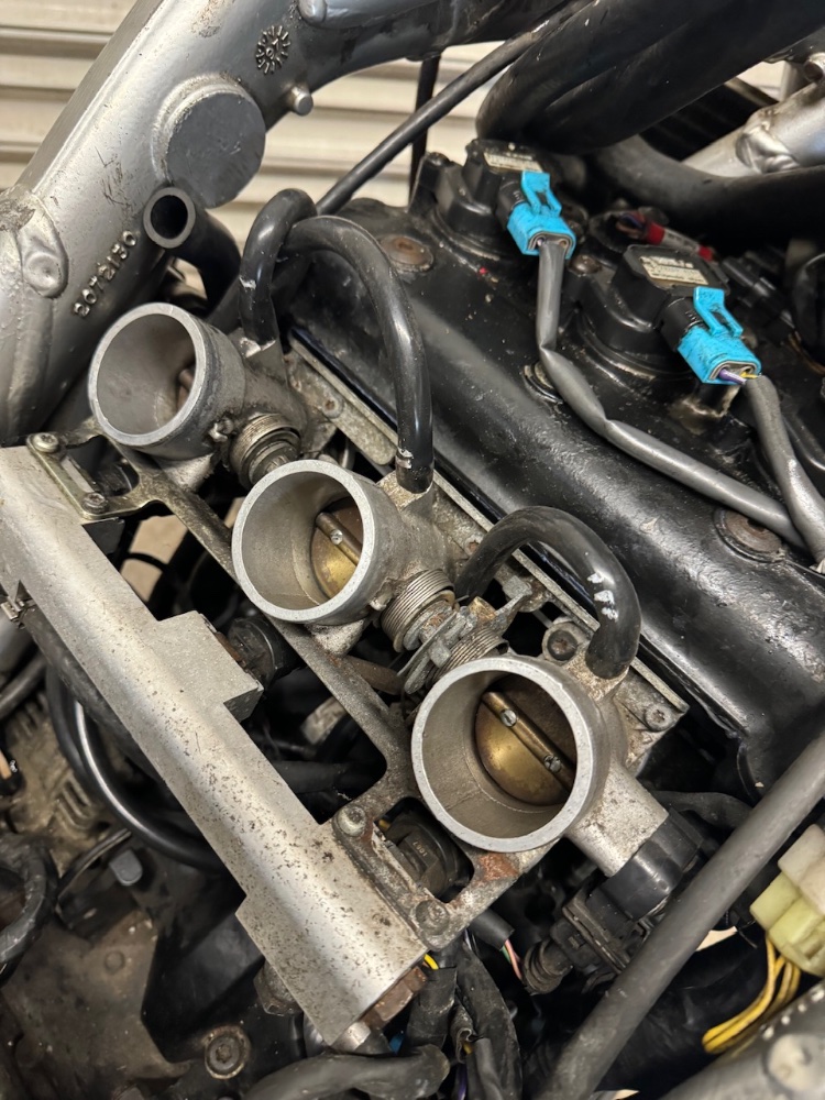

It wouldn’t start, so armed with a manual and multi-meter I found ineffective relays and placed in incorrect slots (headlight cut, fuel relay and rad fan are mostly interchangeable) which essentially got it running and I got to ride it home. It was popping and banging and generally running rough. I had a suspicion that was cracked and perished IACV pipes. More on that later.
She is all there but forks had putting, discs peeling, tyres 15 years out of date and wheels peeling (along with minor aluminium corrosion on some of the frame (which I will probably leave alone as it’s genuine age related and I’m not stripping this down to a bare frame to powder coat it!)
