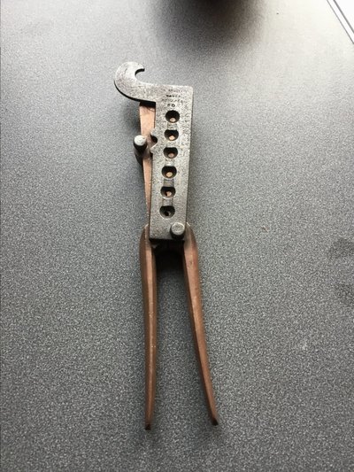

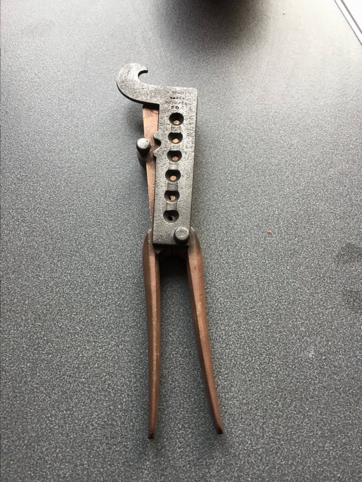

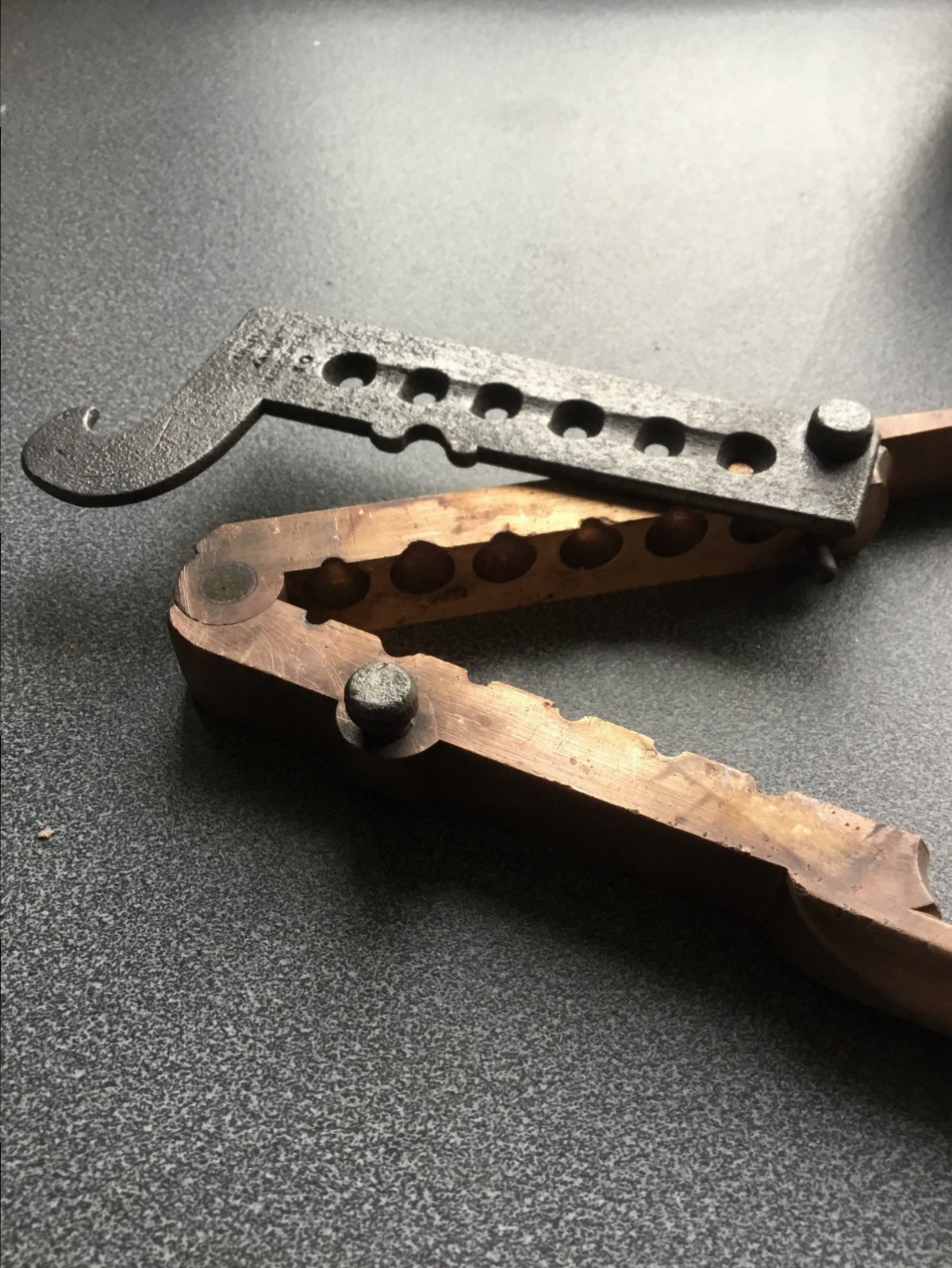

great mouldsDug this out while up at my dads last week.
I've made hunderds if nor thousands of lead balls with this as a kid.
I've tried to find similar molds, with no success.
Any ideas

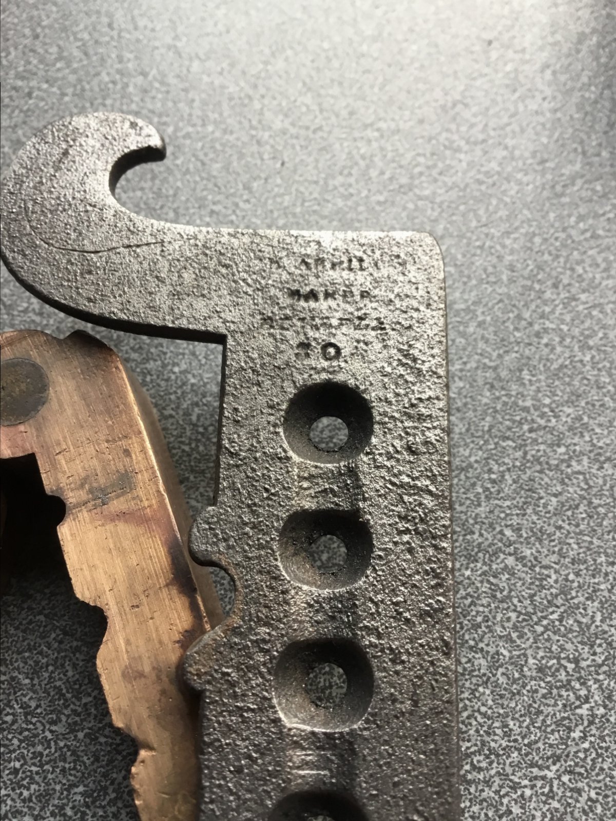

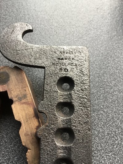

2nd line looks like; maker
4th is ball size;80 (probably swan-shot measurement)
moulds
Thanks. There is a makers name, but too rusted to see whogreat moulds

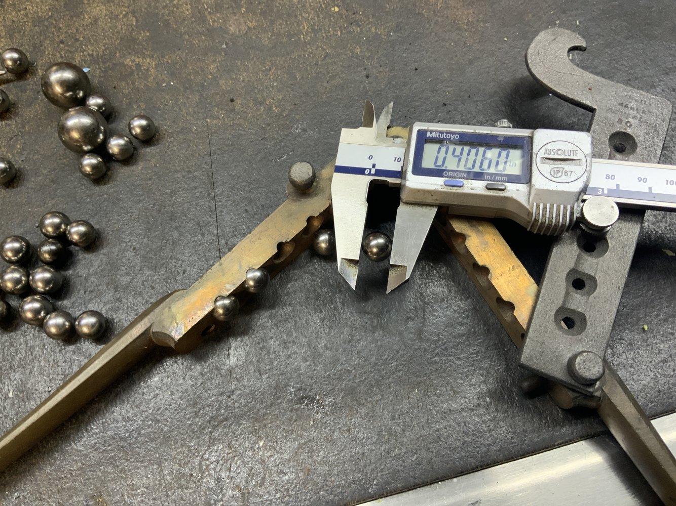

A .400" ball bearing is a very good fit. Would the lead shrink that much, or a good fitThe number 80 will refer to the Bore size in the old Gauge system ie number of balls cast from pure lead to make 1 pound.
80 is equivalent to .38 calibre. A relatively common calibre for revolving ml pistols.
Moulds of this type fetch good money especially if someone has a nice cased muzzleoading rifle or pistol for which the bullet mould is missing!
