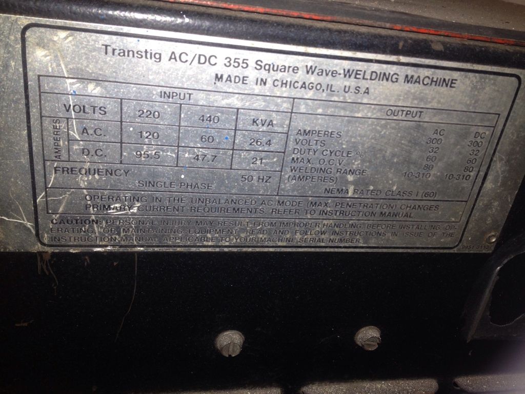

They are a single phase welder that can run off three phase etc but I only have single at home (where I'd use it) as well as minimal storage space. So I know it can be rewired for single phase by moving the pins as I looked online at the manual and I will never really have a use for its full 325A power but would it be able to do 6mm steel (may root it slightly) without tripping the breaker all the time ?
I'd be running it off the old socket for the deep fat fryer (ex hotel) so should have a decent fuse on it ?
Oh it would also be stored outside off the floor in a dry but probably rather cold shed
Heres the back plate
Other question is if this is not suitable for home use would a Lincoln 160t-pulse be ok for home use on thick stuff ? I make off road stuff at home like bumpers, winch trays etc
