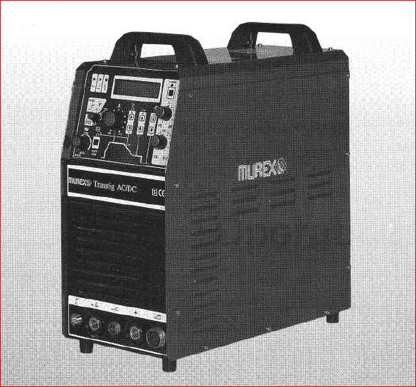

hello all, has anybody had one of these sets had any problems with it?
my one has just stoped working, theres no output at all on it.

Is it one of these, I have the stel version its exactly the same though, mine has been pretty reliable, but it does need a regular blow out, any crap on the circuit boards does make it do strange things, I assume you have checked the torch switch circuit, and also the local / remote toggle switch on the front panel can easily get knocked into remote or pedal position, this will give an HF and 4 amp max output unless you have a pedal connected. there are some internal fuses as well that you could check out. any read out on the LCD display?

hi thanks, mine is very simler it only has 3 rotary knobs on it&l.e.d display its a 240 single phase set,its not realy that dust inside but point taken,the display comes up if you set it in stick mode the left display comes up with cc instead of 70(ocv)and the right hand display with 000& you cant dile in any amps and the set just churps away, its not running in tig mode aswell just churp,churp,like a bird with a stutter!!
your one must be a later one?as it has a l.c.d display?
