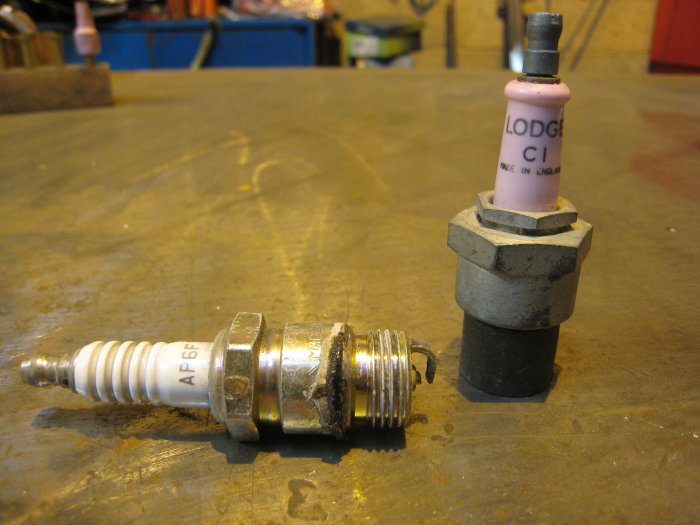

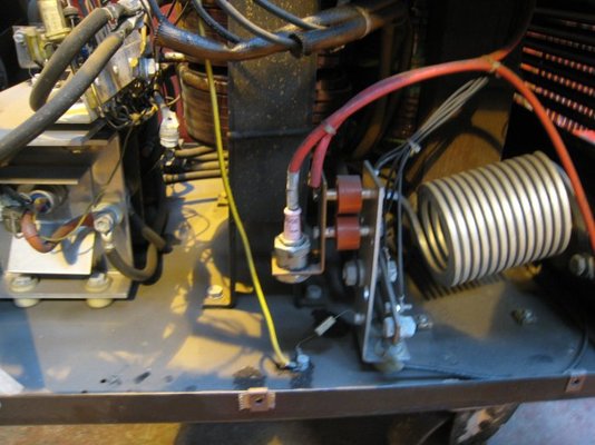

Had a problem with the h/f on my tig today so off with the panels (aye I unplugged it and switched it off). Nothing obvious so gave it a blow out with the airline and took out the spark plug which showed signs of wear, only problem it had a larger than usual thread then I remembered I had an old "Lodge" C1 plug in a show case which I had for many years luckily it had the same thread put it in fired up the welder hey presto job done h/f working great.
