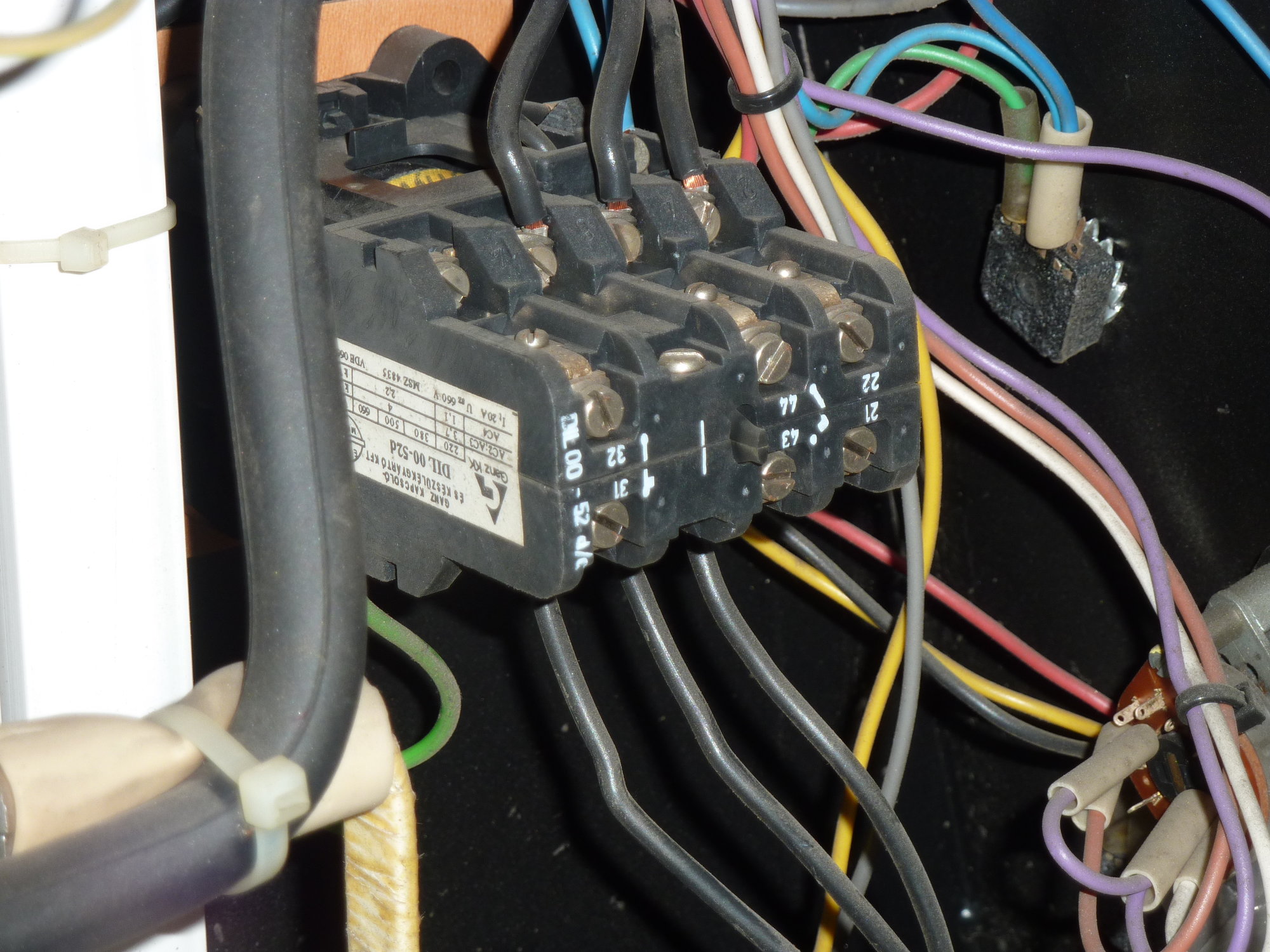

I have a 165 and 235. Had my 165 since new for decades. The 235, I got last year, in well used condition, but like it much better than my other welder (BOC 250C (kempi) ). Anyway the contactor on the 235, had been intermittently chattering, but just got real bad. Luckily I had a spare , from when I changed out one on the 165 (but this wasn't the fault- thyristors needed replacing, so the contactor was still good) I have tried searching on line for a new contactor, but can't find any listing for this item.
The Murex part #1411456 , this relates to Trademigs 130S/160/230/245 165/165GS/235/245. Mine are GANZ KK DIL 00-52d. Does anyone know of a source in England for this contactor, if not I will have to import some direct from GANZ. Are there any supplies of vital Murex spares left?
