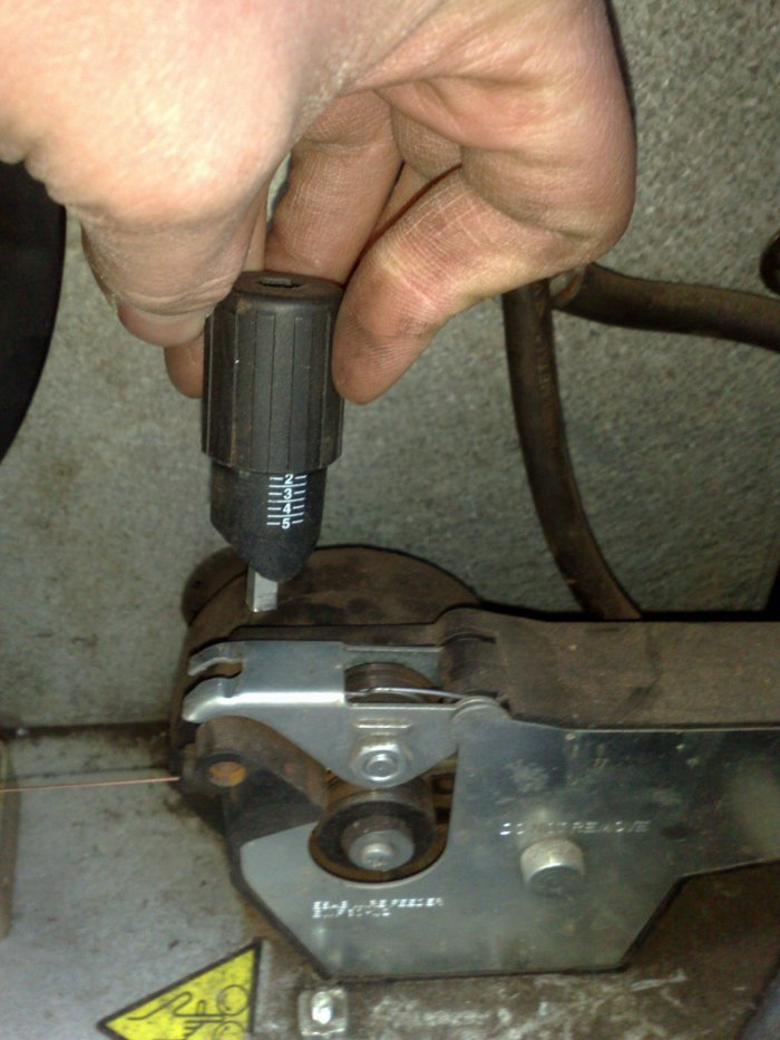

lummocks Learner! Messages 90 Mar 21, 2009 #1 Anyone know if I can get the below part for my murex welder? Thanks in advance 21032009258.jpg 97.1 KB · Views: 569
Robotstar5 Casanunda Staff member Messages 23,845 Location Birmingham Mar 21, 2009 #2 The tensioner appears to be the same as used on the Transmig 300 & 350 so you could try for spares from those models - also check for similar ESAB models as they use the same feed mech, our Murex spares come in ESAB packaging at work!

Hitch Moderator Staff member Messages 13,576 Location England Mar 21, 2009 #4 From memory, looks remarkably similar to our Migatronics aswell.
M MarkG S.P.A. Welding Supplies - Lancing Messages 110 Mar 21, 2009 #5 You can get that part from any Murex/Esab distributor. You may need the pin that it screws into as well. Part # 0368 749 880 for the pressure transducer Part # 0367 528 001 for the pin bolt Can get you prices too on Monday when I'm back at work if you like....can't log into our account at home

lummocks Learner! Messages 90 Mar 22, 2009 #6 Absoloute legend! If you could mate that would be great. Thanks Mike
