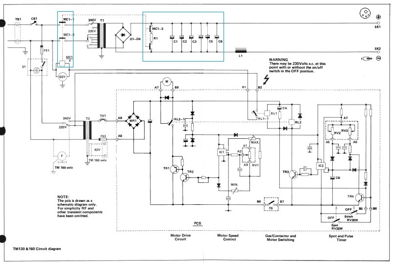

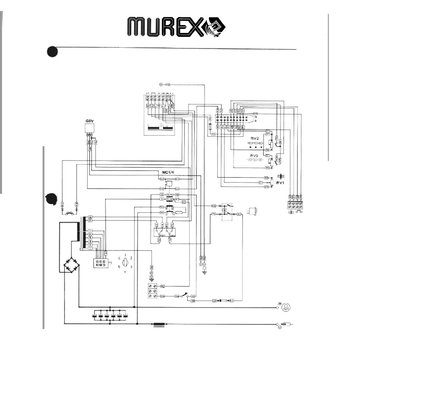

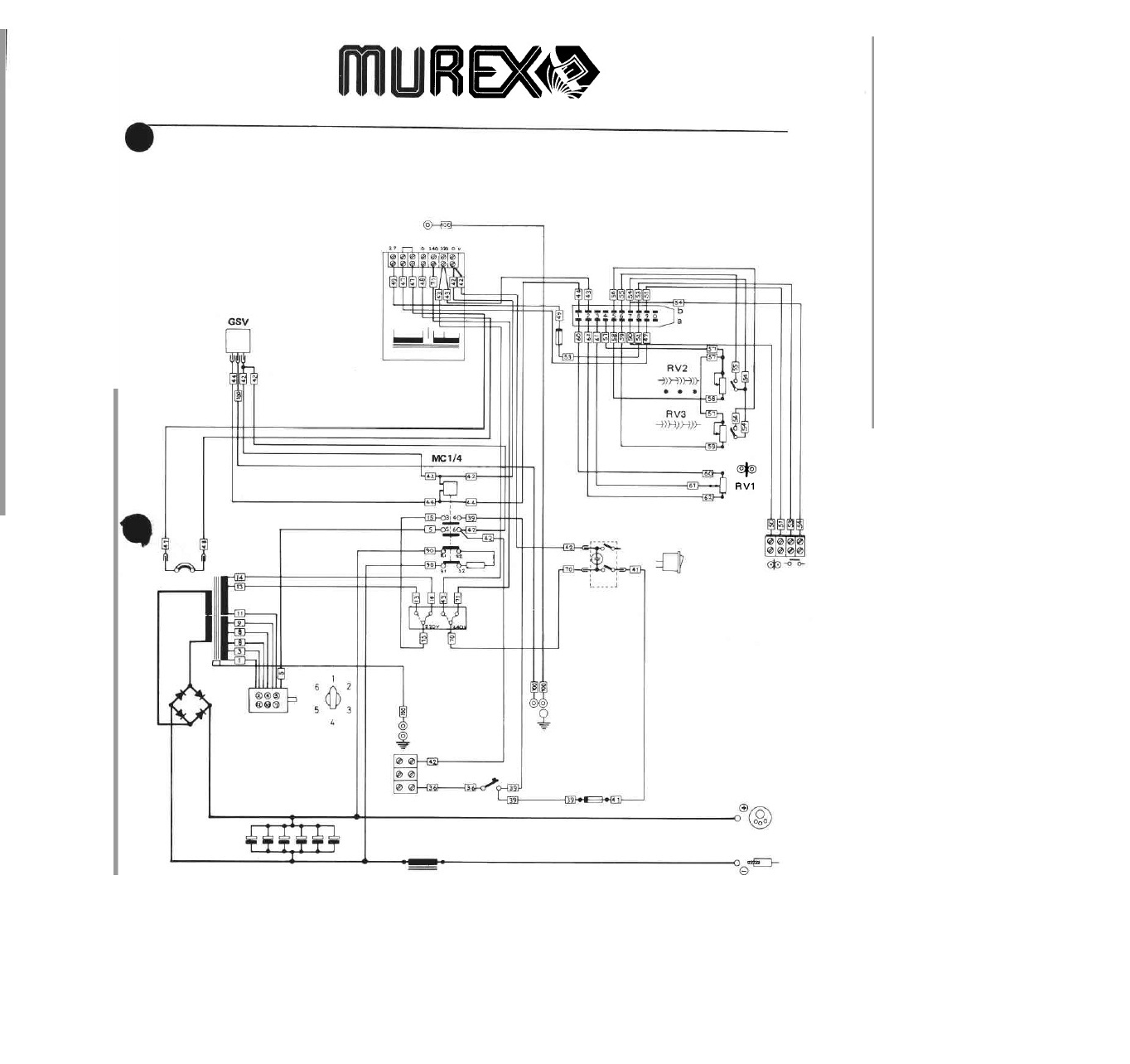

Hi all , I have an old standby welder and it's been stood a long time , I treat it to fresh wire and a new torch , it was welding fine apart from the discharging of the torch but it's done that for s while , I did a little welding with it recently and it worked ok , came next day and turned it on and got ready to weld and when I pull the trigger the contractor pulls in and wire feeds and the gas runs but no power to the torch to weld , any ideas guy's ?
Any help is appreciated in layman terms as I'm a metal basher do to speak , the machine has never been used for anything more than 1.2 mm steel .
Thanks Craig
