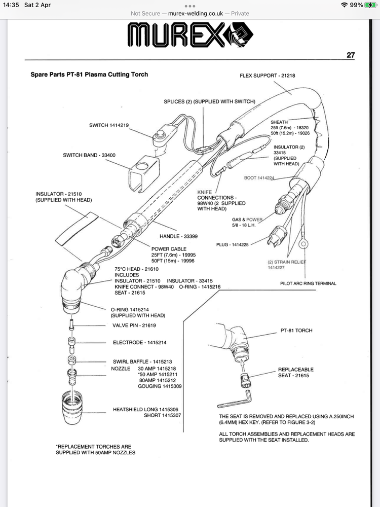

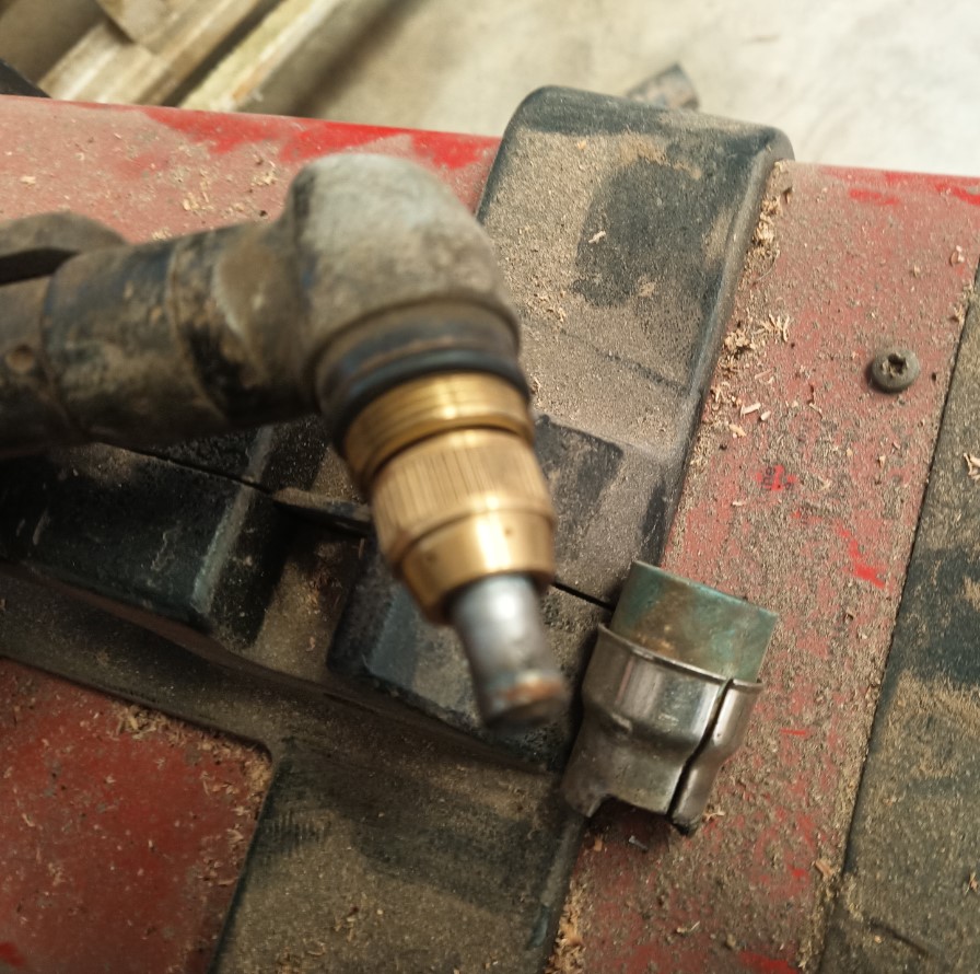

Here you go:

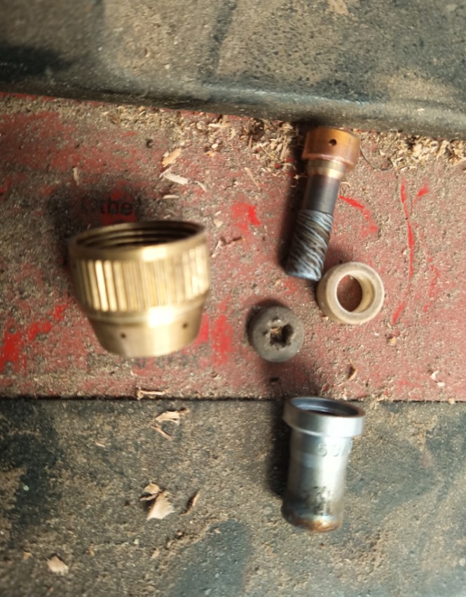

Most of the electrodes I have seen don't have the holes at the top.

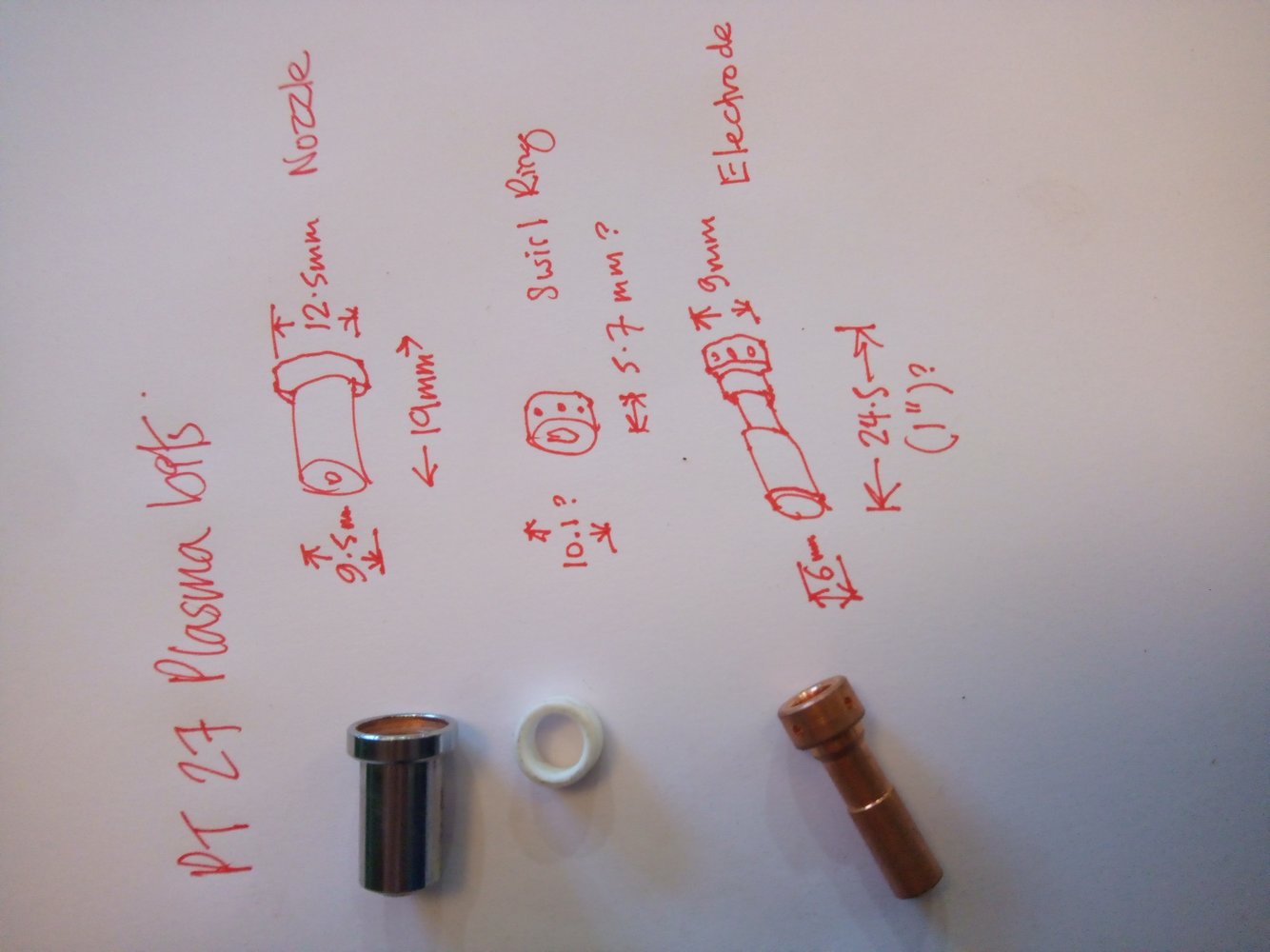

Found a few places in the USA that do thermaldyne (I think) that look very similar so i will pass on the details.
Was there for a bit today so gave them a quick measure and they are exactly the same as yours so now I can tell them to call and see the price. Might still be better going a different head/torch as @zeppelin builder says, we will see.They're all rough measurements to the nearest milimeter.
