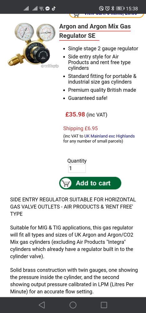

The flow rate would probably be around 20% more for nitrogen compared to argon. e.g. to get 6 litres/min nitrogen, the output "pressure" would need to be set for 5 litres/min. Having said that, these "flow" calibrated gauges are not particularly accurate. A pea shooter type flowmeter, together with calibration graphs for different gases would be a better solution, if flow rate is important.
