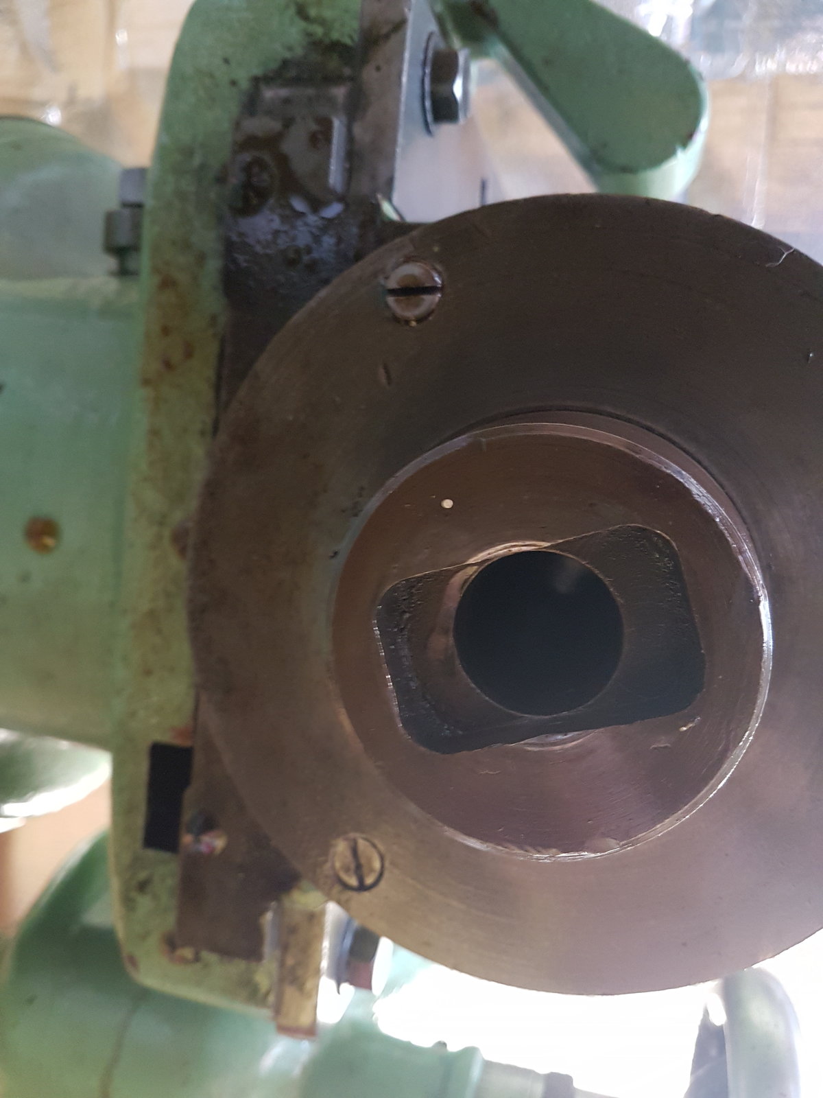

Would the tapper in your spindle have enough length if you were to machine the part that accepts the drive dog off of the spindles length?I only need about 1/2" more length. It's that or rebore the spindle iso30 but I'm a coward.....
Yours is slightly different to mine. Still haven't found what was used originally.This is the view from below.View attachment 115723
