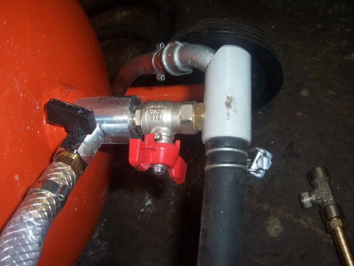

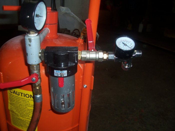

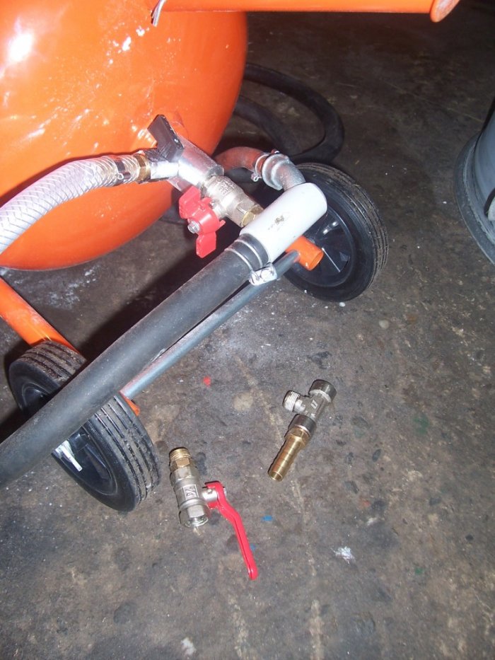

As above, it'l go for only a second or two when turned of for and hour or so and left, only got it yesterday and had the problem since its first run, so will still come out of the clear silicon pipe when you open the valve with the black lever, when i strip everything down i cant find any blockages, the air is still coming out of the nozzle at the same force, so im thinking that the soda must be damp and turning to small lumps, below is a picture of the bottom of the pot, if it is the soda is there anyway of drying it out so to speak?

make sure your water seperator is clearing any water colected , any moisture what so ever is a looser
