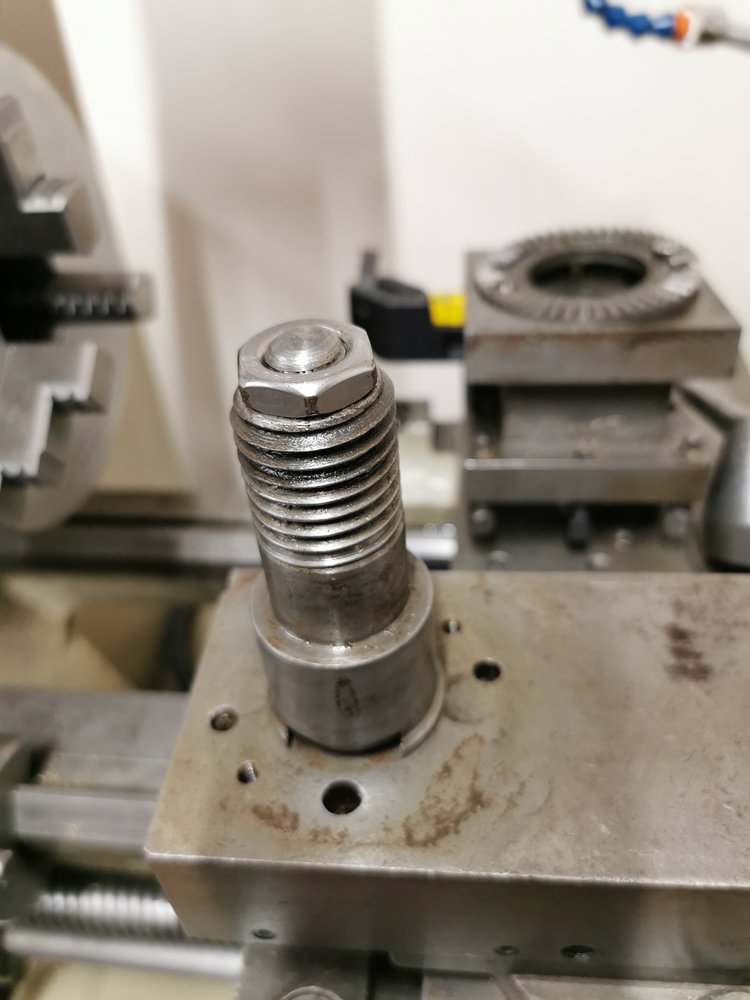

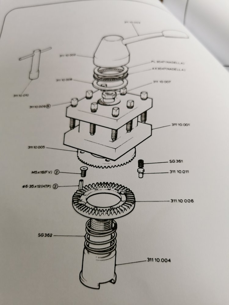

Just picked up a T2 tool post and deciding how best to mount it?
I took of the 4 way tool post currently fitted and have a 1" dia stud:
The toolpost is too small an internal diameter and too tall to suit:
So am I best:
1. just turning a new mounting stud or
2. mounting the tool post in the 4 jaw and boring out to suit and countersinking the top a few mm to reuse the existing clamping handle and access the existing threads?
I suspect the tool post will be quite hard, but should be doable with carbide tools.
Thanks
