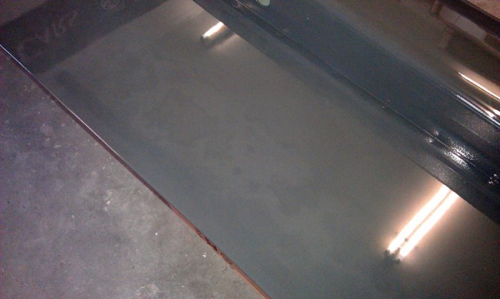

Hi Chaps,
I'm having an issue with mottling as described here: http://pc.dupont.com/dpc/en/US/html/visitor/s/trouble/PDSG_Mottling.html

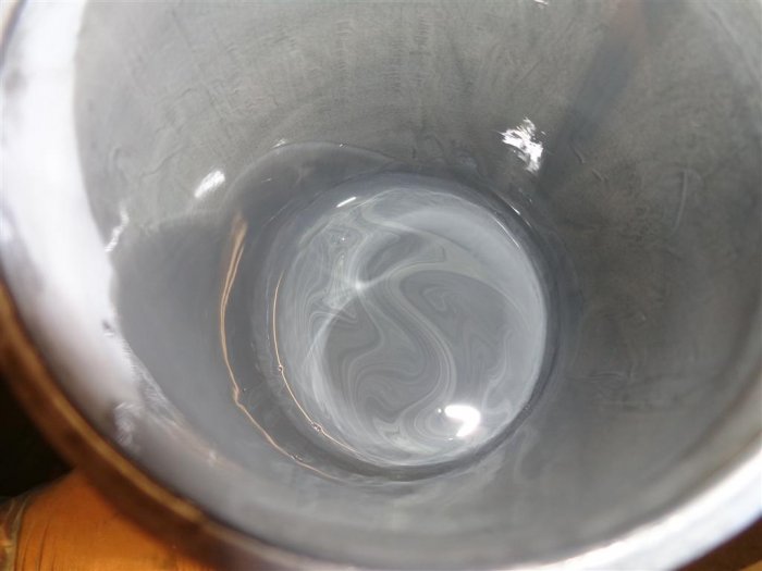

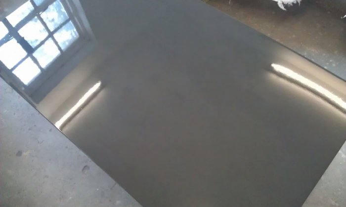

Oddly it's in a solid colour where in most instances it's described as occurring to the flakes in metallic. As you can see from the pics attached the lighter pigment seems to be "floating out".

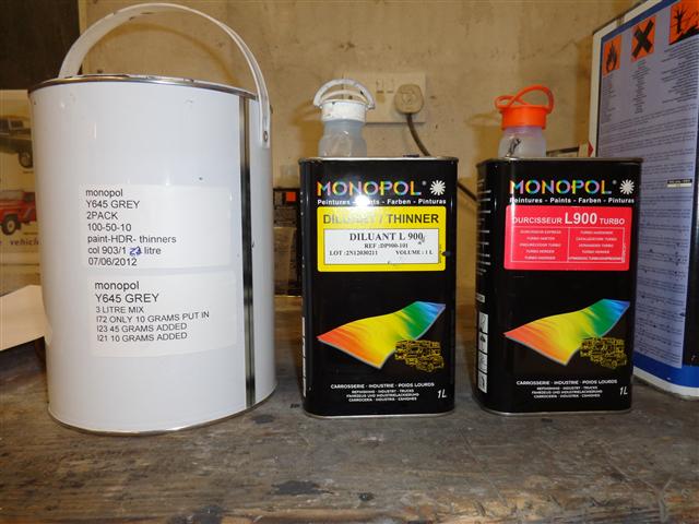

The paint is 2k Monopol, in a grey. The paint is thoroughly mixed, at the correct ratio by volume of 2:1:10%. Using a fast reducer.
I'm spraying on the flat with a gravity fed gun (1.4mm) as I find the orange peel to be less, less possibility of drips, any small dust inclusions I can 1200 grit out, and I have a lot of large panels to spray (classic range rover) so they're tough to hang.
Having read as much as I can it seems likely that it's down to uneven spray pattern - which I think I spotted towards the end of painting yesterday where more paint was being sprayed towards the bottom of the fan than the top. I'm onto my third coat so it's grey on grey at this stage. I'm going to filter the paint and remove the internal filter also in case it's getting blocked and causing the issue.
Any other suggestions gratefully received fellas. Pics attached.
Cheers,
Andrew.
