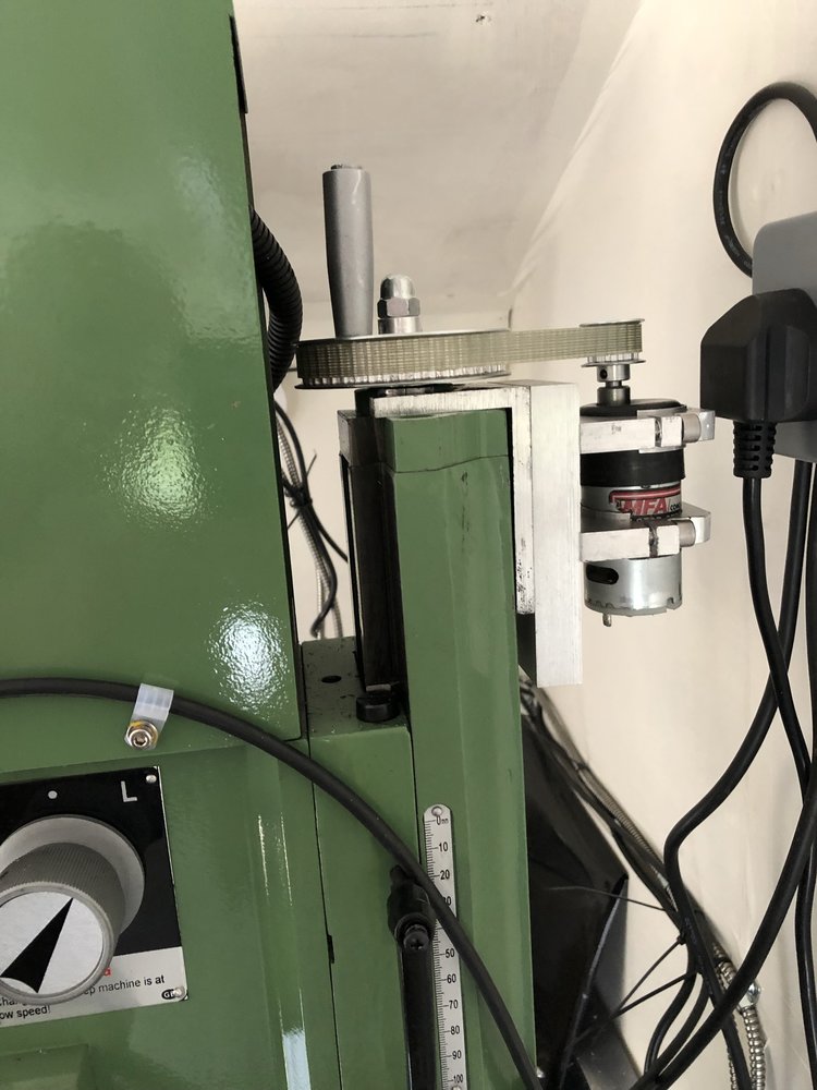

Well finally almost finished adding motor to my mill Z axis, apart from melting the warning light when soldering wires on ( note to self don’t use gas soldering iron ), very happy that I don’t need to stretch around back to alter Z axis, having a dodgy shoulder it was a pain literally, being new to this mill lark I made a few newby mistakes like I needed to cut holes for motor to mount size 35mm so moved X axis over 17.5mm but forgot to deduct 1/2 the endmill size hence hole to big so shim needed, but overall very happy.
