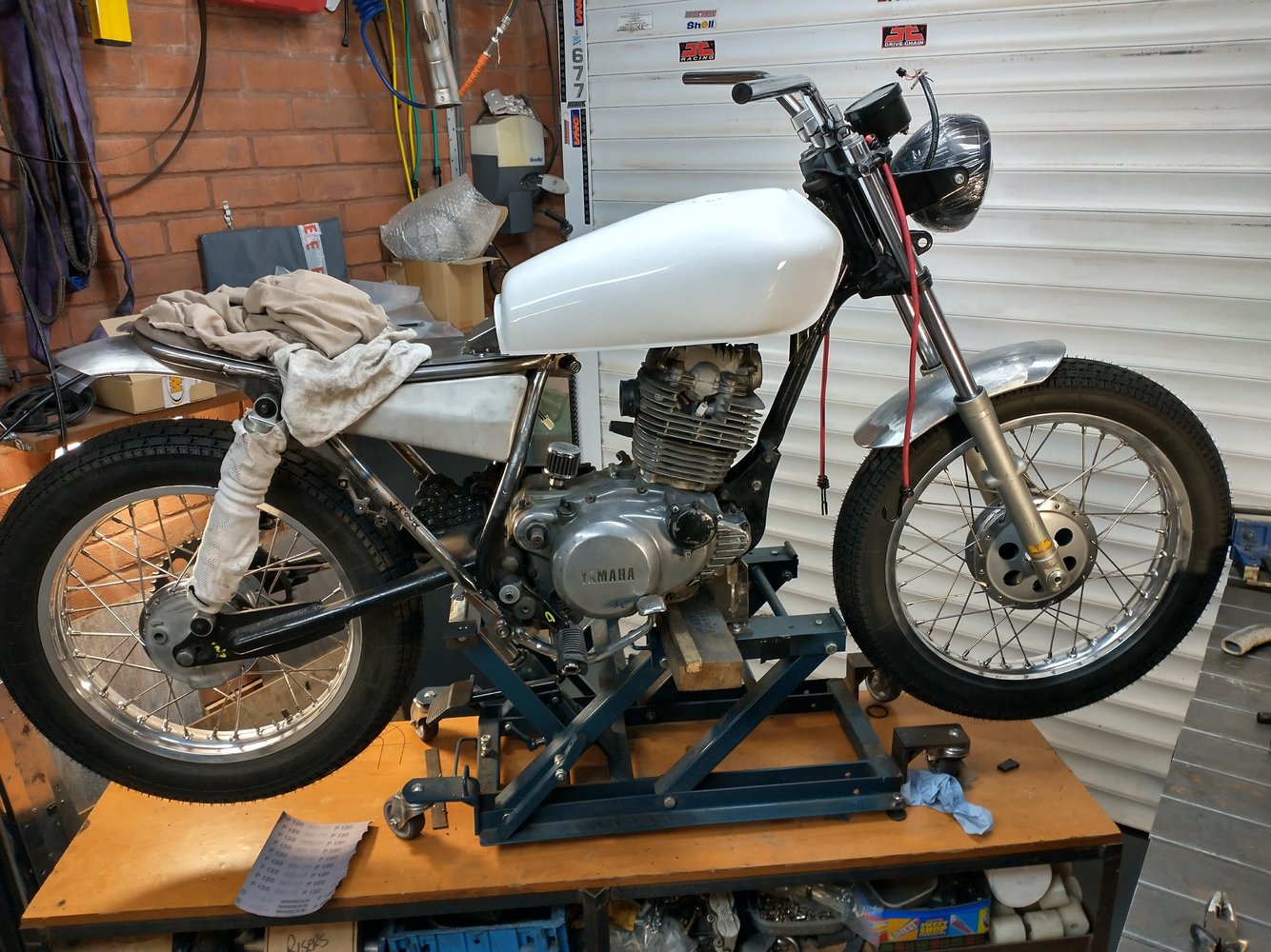

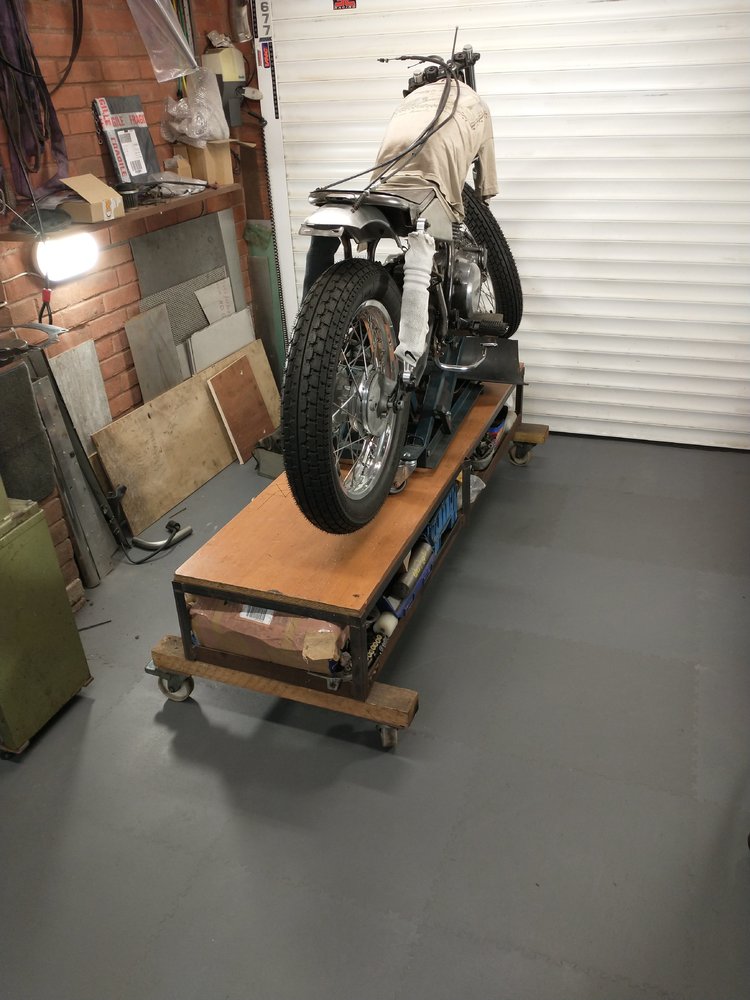

Here's mine. Originally built it to sit a Caterham on top during the assembly, then used it for a plethora of bike projects over the years. Some 25mm angle, side off an old wardrobe for the top and some old fascia boards for shelving underneath. Got a cheapo hydraulic lift on top which I bolt the bike to during fabrication and get it on and off with a beam, but have used a scaffold plank as a ramp in the past.
