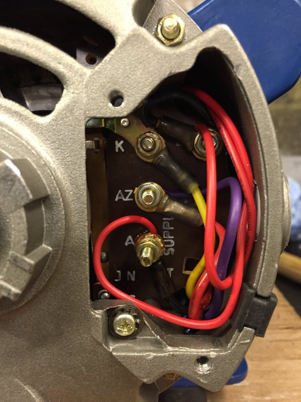

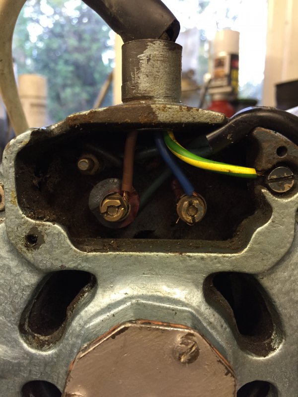

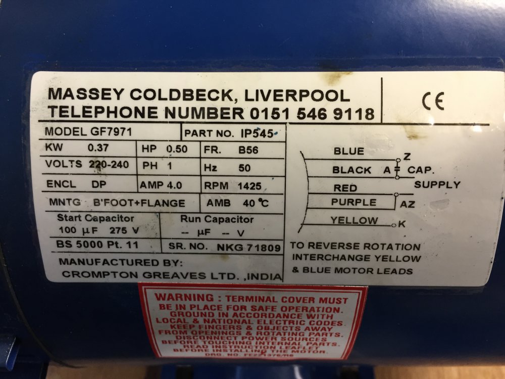

I have a new motor for my Mill and unsure which way to wire it. The old one just had two wires in so I am unsure which wire goes where.
Photos below show the wiring on old and new. i assume the A post is the supply in , i.e. the live feed and the neutral goes to the the AZ post depending in direction of rotation desired and the earth goes to the case?
I assume I could put a reversing switch on with this as well?
