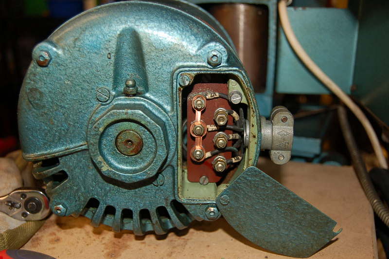

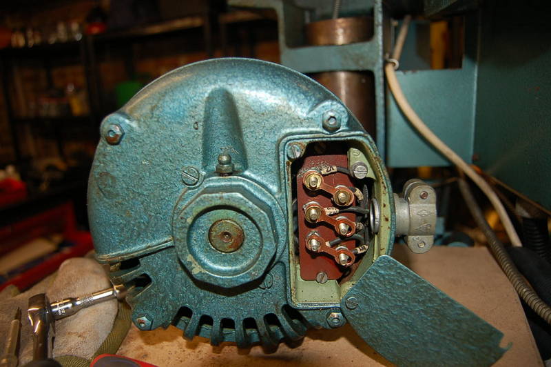

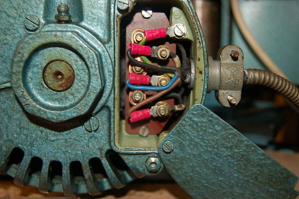

Hi Guys
In the process of wiring up a motor currently from star to delta
in order that my Pillar Drill can be opperated via an Inverter on domestic supply. Just wanted to check
if it makes any difference as to which row of terminals I use on the motor i.e can I use the
first vertical connections nearest to the gland nut.
Photos shows Star with 3 phase wiring and Delta configuration made ready for
single phase workshop.
Thanks Steve
